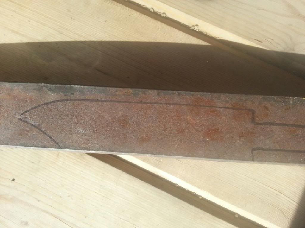

Hi, I've never made a knife before, and I kinda wanted to build one and now I can't stop thinking about building one. I've hadnoexperience with any thing other than just what I've read off of here and other forums. A Knife maker friends if mine gave me some 1080 to build my first knife, but I decided to use some old leaf springs just to Kinda practice and get the hang of it before I used the good steel. Now I've cut out my forms and used a grinder to clean up the form and semi start the edge, my first question is when I'm cleaning it up with a bench grinder, and the steel changes color is that bad? My next question is what's next? I don't have a belt grinder and I'm really not to sure where to head from here, any help would be greatly appreciated. I don't have a forge either but I can send it away to get hat treated, but ya any tips or tricks are very greatly appreciated
The Count will be along shortly with his standard reply for new makers. In the mean time, read through the stickies at the top of this forum. All the information you need and more is there. To answer your questions:
It is not bad for your steel to change color at this stage.
What is next is what should have been first. Do a lot of reading (see above). I don't know how much use your bench grinder will be. Your best bet is to use hand files and sandpaper. You can remove a lot of material with new, sharp files. Take a look through the video stickies thread and You Tube for videos showing how to file a blade to shape. Or type in the keywords "Walter Sorrells how to make a knife" in the You Tube search window. There are other videos that show you how to make a simple filing jig that will help you get good consistent bevels.
If you are a handy person (that is, you are good at building things with your hands and are clever in the way you approach things) you will be able to build many of the things you need. Grinders, forges, anvils, Jigs, sanding fixtures and more; all can be built at home with time, patience and a little ingenuity. When you get stuck, keep asking questions and posting your progress here. Folks 'round these parts are more than willing to hep.
I used the bench grinder just to get off some of the metal to kind of form the edge, the leaf spring is 1/4 inch thick lol.
You need a Photobucket account or something similar. You can get a free account. Then upload your pics there. Next to the pictures in your library there will be various ways to link your picture. Click on the link shown and then paste it into your post. Easy Peasy.

I would suggest you fill out your profile so a nearby maker can offer you some help.
There is no gentle way to say this - There are so many things wrong with what you have started. I can't really give you any advice on how to continue.
Your best method of getting a good first knife is to start on paper.
Draw the whole knife as well as drawing the blade only. Post those sketches here along with the materials you will be using and methods you plan to do use. The more we know about how you plan on making the knife, the better we can help you.
Once the drawings have been critiqued and any needed adjustments make, then you can start on the metal. Going slow and posting photos of each step BEFORE YOUR DO IT will prevent fatal errors.
Ok, you're at the beginning of your education. You'll get there soon enough. We'll help you. Hey, you did learn how to post pictures! Now we can see your progress. Stop working on this piece. It will not make a good knife. You are not so far off but this one is flawed beyond saving. Here are some thoughts to consider. Think of your knife as a house. The part we call the ricasso is the foundation of that house/knife. Look at lots of knife pictures. There is a small section between the tang and the cutting edge in front of where the guard goes. That block of steel is usually the thickest part of the knife and the cross section will have very parallel top, bottom and sides. Kitchen knives are a bit different but it looks like you are building a bowie style blade. This is the center of your knife. Since it is the flattest and most square at the corners it is used as a reference point for other parts of the knife. Another thing to keep in mind are corners. Sharp corners can cause stress risers which can lead to cracks or failure of the knife. Adding a small radius to corners helps to distribute stresses better. So, use a file guide or the jaws of a vise to help you file a straight line at the shoulder (where the guard is set behind the ricasso) and use a small radius where the shoulder meets the tang. You want the tang to be centered at the shoulders. That is, there should be the same amount of step on either side of the tang. Also you want as thick a tang behind the blade as you can while leaving room for your handle material. It can taper out as you move towards the butt end. Take a look.
okay I'm going to rig up a belt sander and cut out some knives then post and see what you guys think. Most important part (foundation) is the ricasso? K so with the previous knife, can you tell me what I did wrong (don't worry feelings won't be hurt lol) so I know what to do for the next ones
You seem to be jumping around a bit. The previous knife you showed us was a hidden tang style. The suggestions I described earlier apply to that style of knife. Now you have drawn up a full tang knife without a guard. This style has a different set of details particular to this construction. That is ok. If you want to build this style we can talk about that. But in order to see improvement over the last one or for you to learn the lessons the last one could teach, you should build another in the same style as your earlier attempt so direct comparisons can be made. Let us know what direction you'd like to go and we'll take it from there.
ok this one i had already drawn out, but I will draw out another bowie style, and you can tell me what you think

The others have some really good points,
That outline on the steel looks exactly like that one you ground.
Firstly, get off the phone and find a real computer with a real screen,
You're going to need to see details.
Look at, study, examine, mediate on, the differences between this
and this
The back half is more important than the pointy end.
I'd put the steel down for a while
I think it's important for you to look at a few thousand photos of good knives first.
Then start with a pencil and paper, show us your drawings and you can be guided from there.
It's much easier to do over on paper than on steel
I think that a full tang may be a better place to start.
I would skip using that thick leaf spring, how are you going to drill a hole in it when it's already somewhat hard ?
