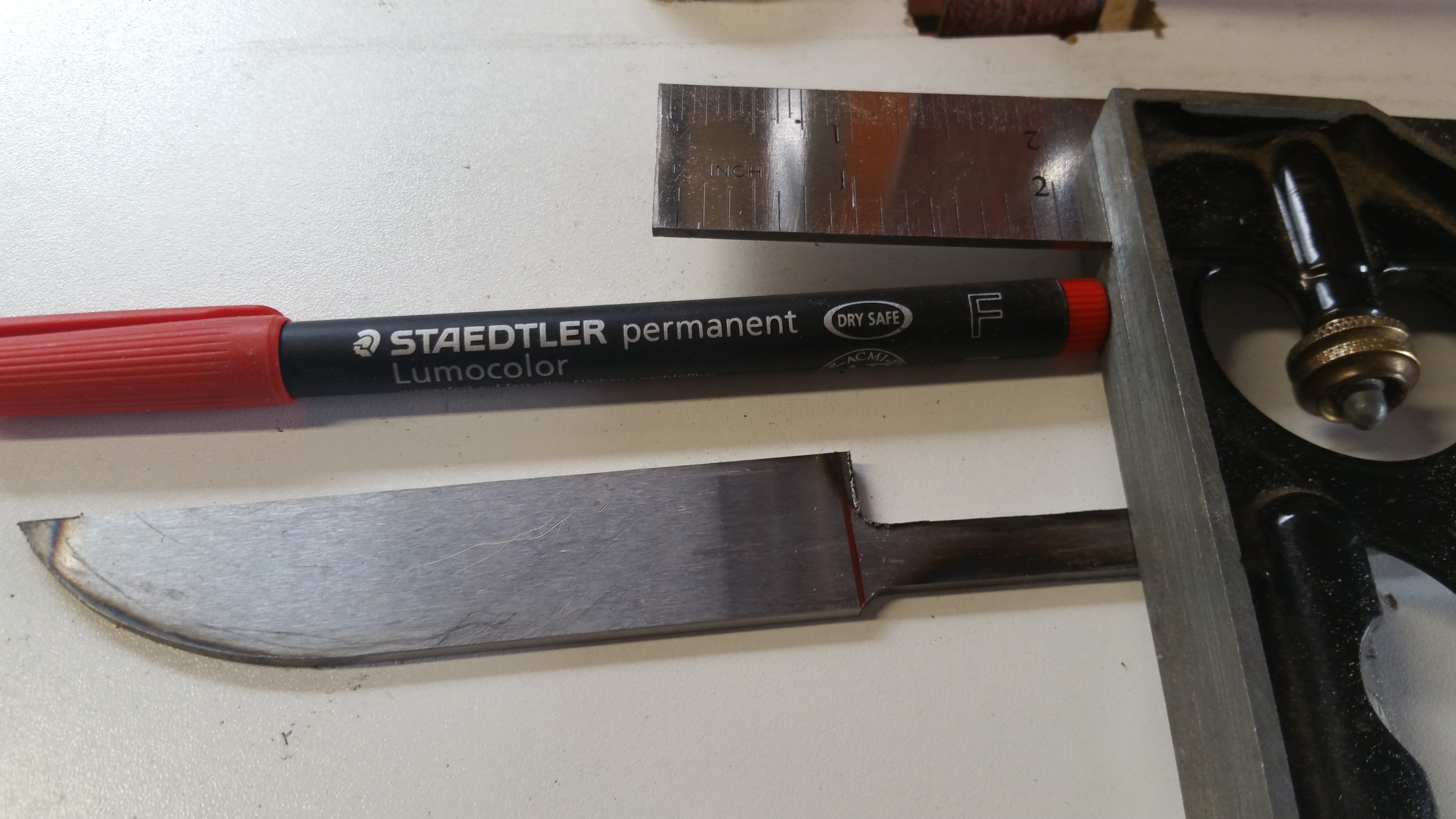

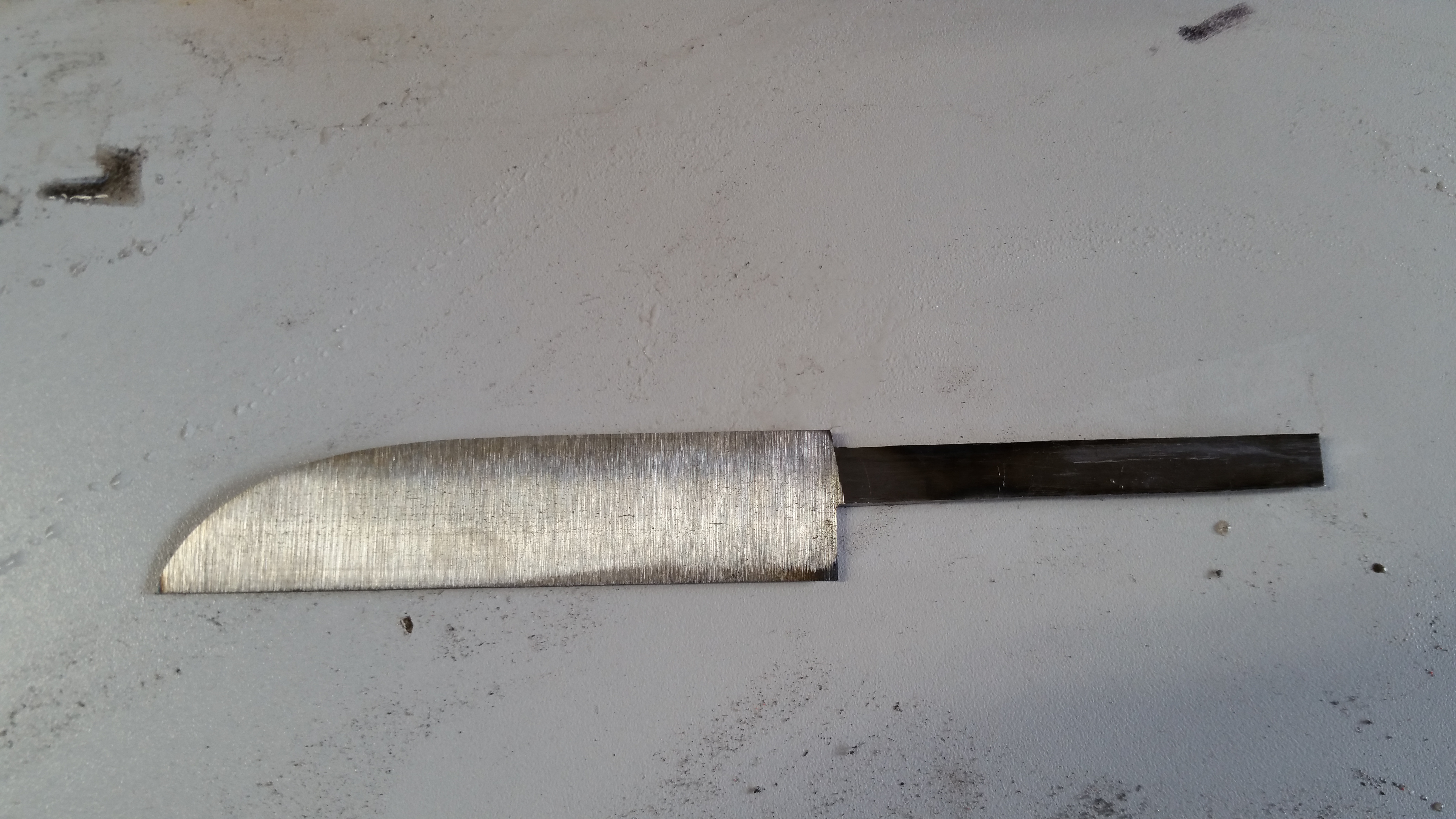

I've been building up to this for while, watching tons of YouTube, reading tons of tutorials. Normally I'm the kind of person who will spend the majority of time drawing, planning, setting up jigs, and then zip through on auto-pilot. This time, since I'm not making a folder, just a fixed blade, I made some quick measurements and threw down some ink. I see these lines as a guide to rough-cut, then I'll dial it in on the grinder.
I cut it out with an air cutter then cleaned it up on a bench grinder

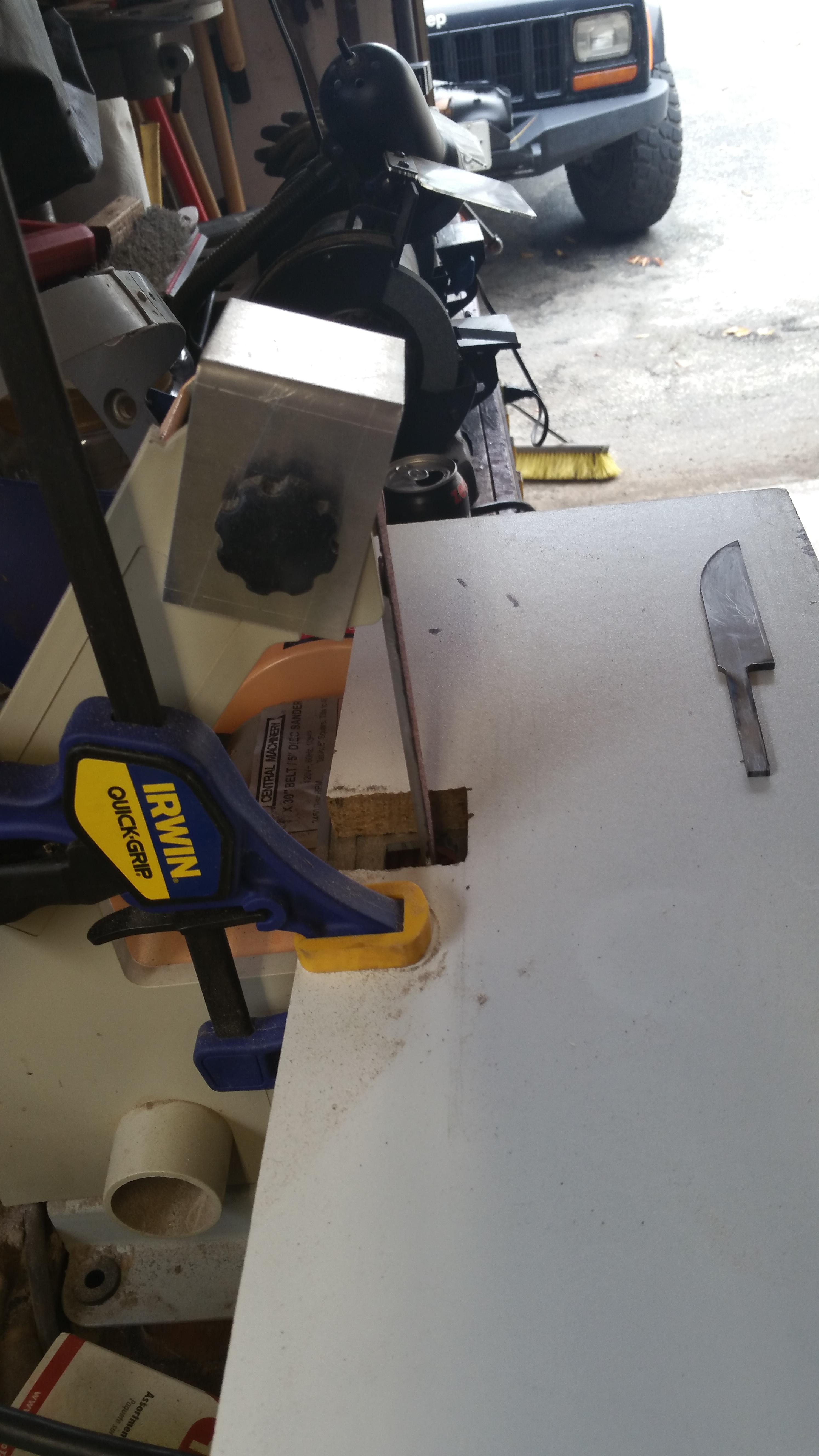

A quick note about my HF belt sander. I don't know what the stuff is called, but I made a table out of that particle board with the slick surfaces. That way it's completely flat and smooth. I also made a new platen out of 1/8 mild steel. I had a piece of bar stock, cut it to length, bent it in my vice, then after tons of checking against a square and adjusting, got it at a perfect 90. I then ran it on a 4x36 to smooth the face out, drilled holes, and mounted it up. It goes almost all the way to the top wheel, that way I can grind bigger knives if I want, though if I make many more knives I'll build a 2x72. I lost my dust shield so I made another with a piece of scrap aluminum that I had laying around. These things are a big deal because without it the dust goes straight into your face and will eventually make it's way around the edges of your glasses.
I cleaned up the corners of the tang using a file and a square. This is the "before" shot, i've got it about 90% now and I'll finish it after HT.

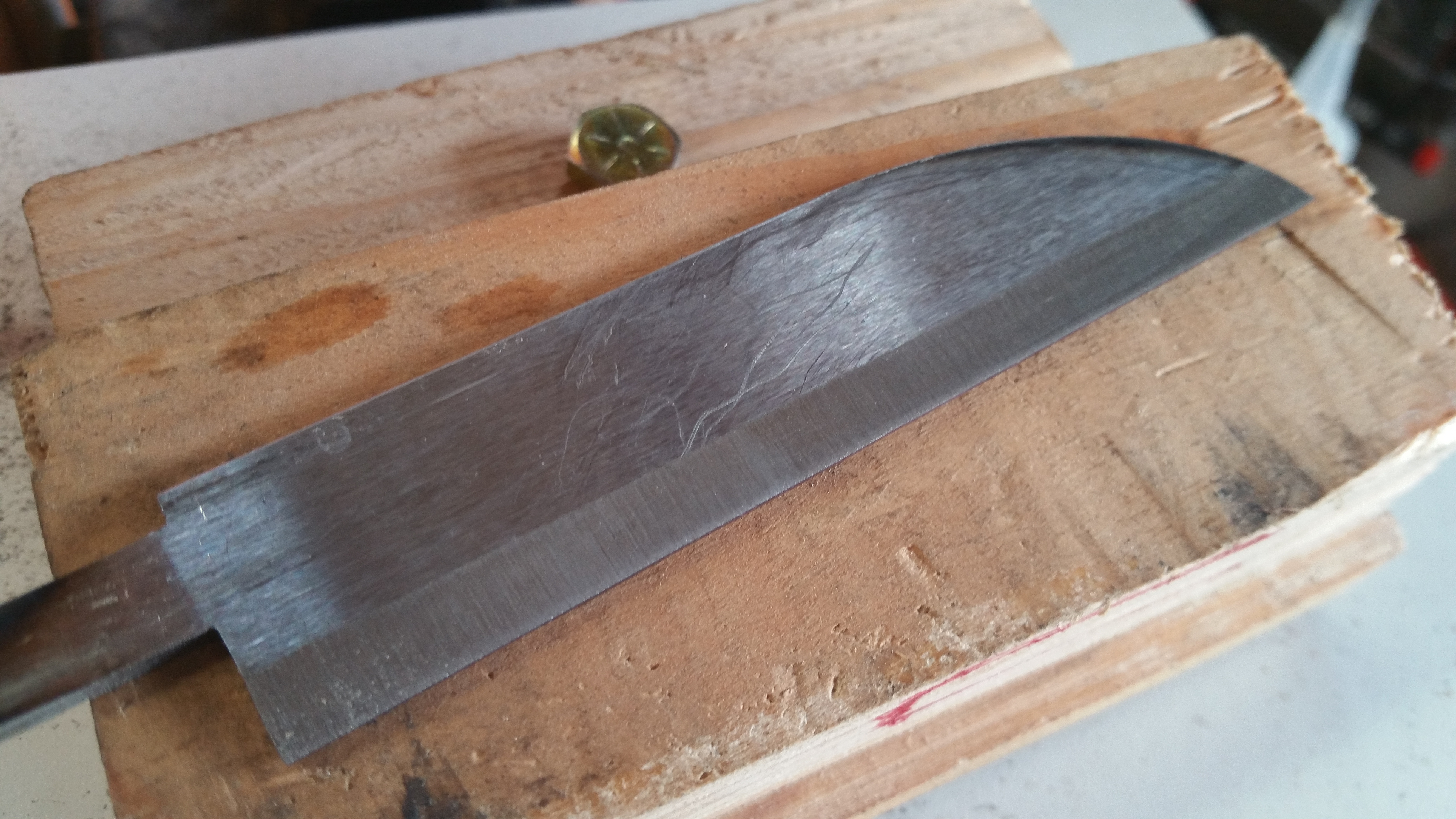

The jig is just a scrap end of a 2x4, cut appropriately and with a bolt going through the bottom to adjust the angle. What you can't see is a countersunk nut on the underside for the bolt. The blade is held to it using a C clamp. If I make more knives I'll make a better jig, but this one works for now.
Using an old belt I knocked down the corners and brought the edge to it's pre-HT thickness. I then switched to a fresh 60 grit blaze belt. I dialed back the angle on the jig, ground until the old grind line was gone, and repeated until I reached the spine. I then did a few passes with a 120 belt and this is how it sits now, waiting for my forge to dry. I accidentally ground the tip a bit too thin, so I took some off the nose of the blade to put a bit more meat behind it. I lost concentration for a second and the jig wobbled and I took a swipe near the spine of the blade where a swedge might go. I am not going to attempt a swedge to cover it up, I'm just going to chalk it up as a learning experience and move on.

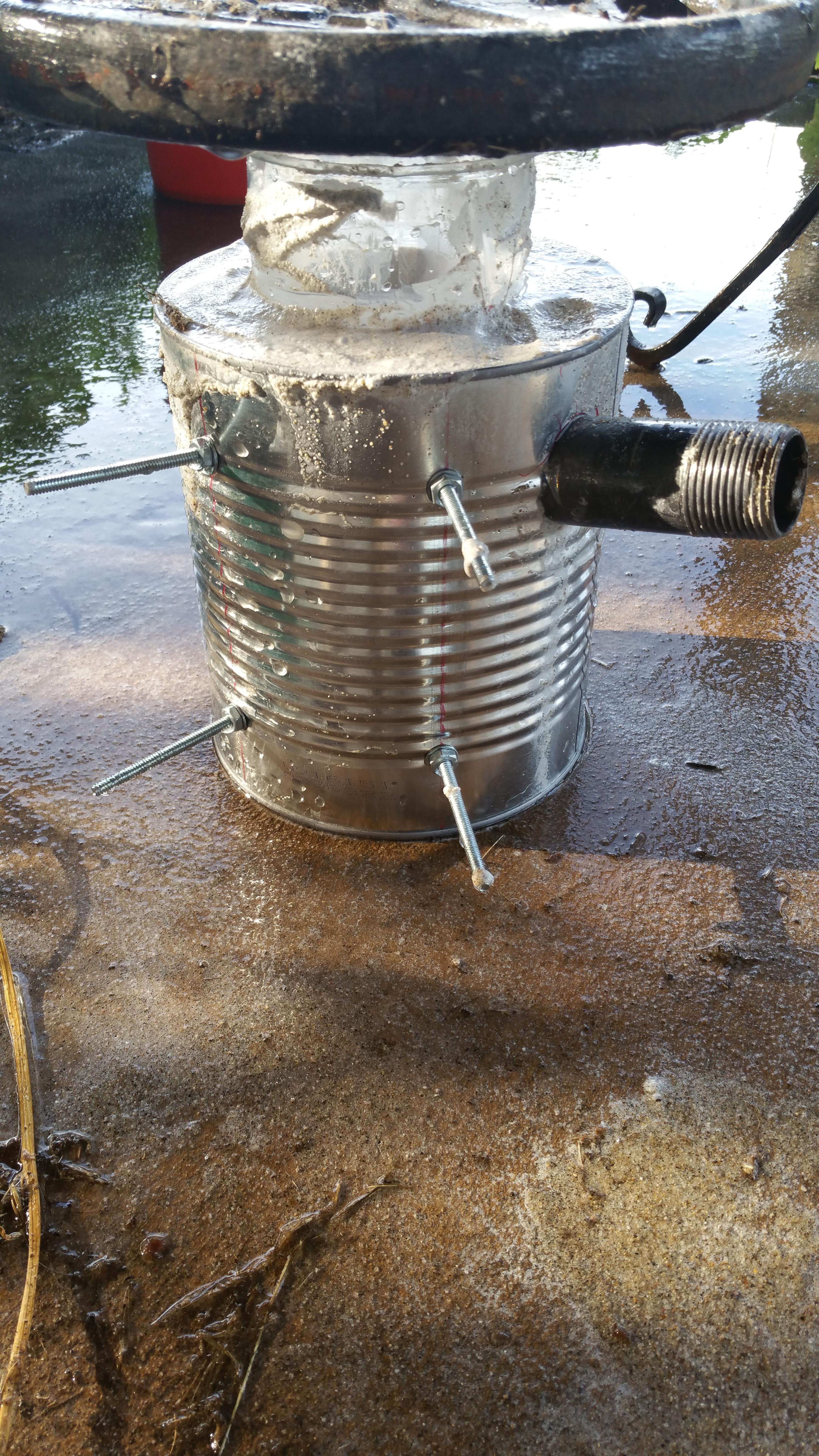

I also started the forge today. Using a large can, the size that restaurant kitchens buy stuff in, I lined it with a 50/50 plaster and sand mix. I used a piece of 1" black iron pipe, inserted tangential to the inside and pointing slightly towards the back. After it's dry I'll cut the back out and hopefully get a nice spiral flame. I know it's not ideal, but just like the grinder, if I keep making knives I'll build something better.

The knife looks good, it's smaller then I first thought.
With that said I think your going to be more then disappointed with your forge. Your refractory is not an insulator, it's going to take an ungodly amount of heat to get this thing up to temp. Even forges that use actual refractory that can be mixed and poured take a lot of heat and time to come up to temp. I am curious where you got your info about the plaster sand mix for a forge.

It's all over the internet. Some people add other things, pearlite was one I remember reading, but many people claim that just sand and plaster is "good enough" for one or two small knives. The more I think about it, the better a brick forge sounds, but we'll see how this one goes. I could probably make something like an Atlas, but that's another project for another day.

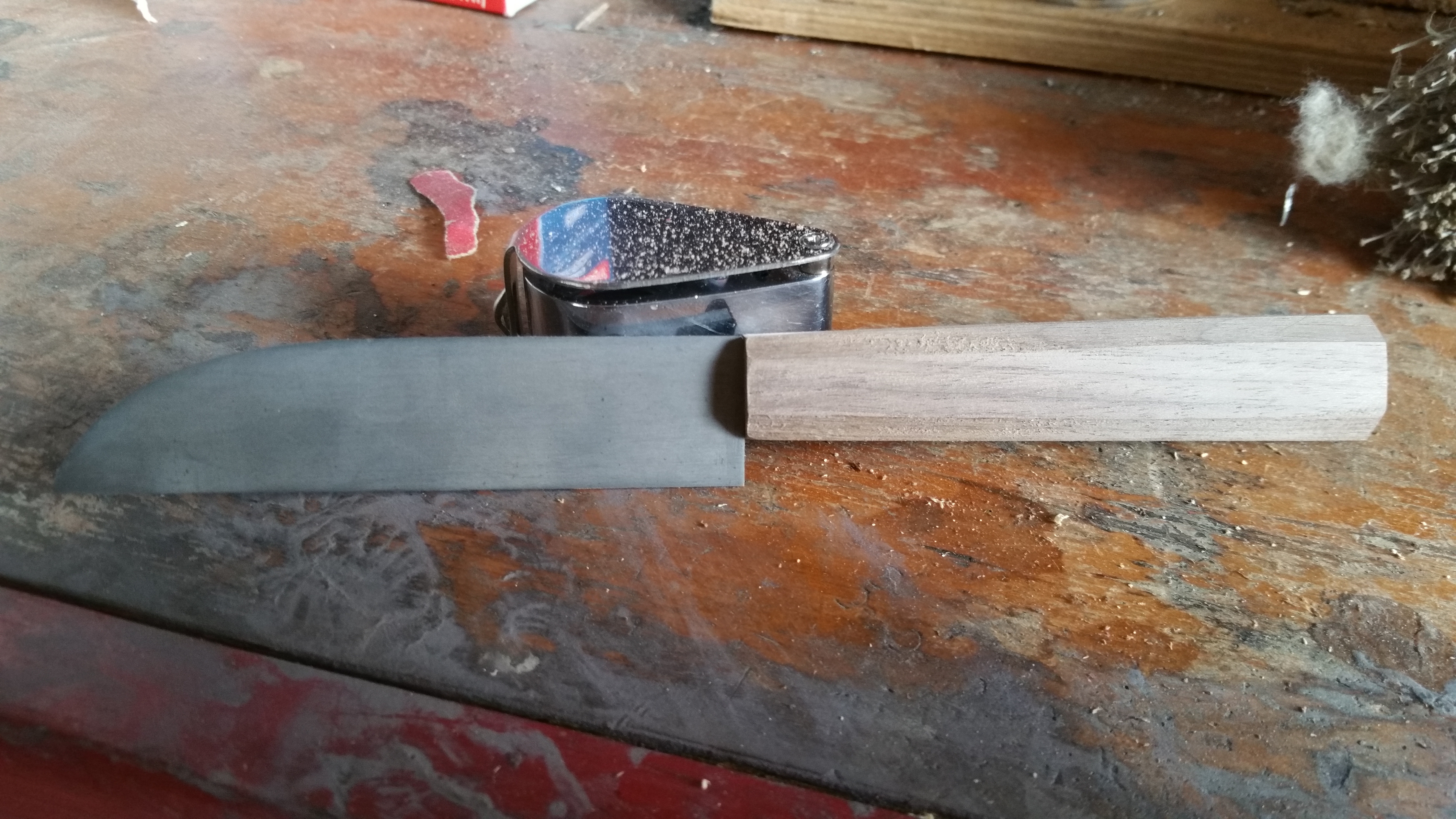

Well, I got a serious case of tunnel vision and didn't take any pictures during the HT, but it went pretty smoothly. The forge did not make a nice spiral flame like I was hoping for. This could have been due to a few different things, but the lack of refraction in my lining was most likely to blame. The flame just shot to the other side and kind of spread out but did not fill the forge like it should have.
That wasn't a deal breaker though, I was able to just run the blade back and fourth in front of the torch and it got plenty hot in only a few minutes. Even though it's not working properly, that little forge is still better than a torch in open air I would imagine. I got it non-magnetic, held it in just a little longer, then quenched it in canola oil. I did the file test along both the edge and spine, and on the tang for comparison. The file, the sharpest one I have, bit just the teensy-tiniest bit on the blade but hardly anything compared to the tang. I then tempered it at 400 for a little over an hour in the toaster oven.
The fact that the file bit at all, even that tiny amount, did concern me a little but once I started hand sanding I can guarantee you all that that steel is definitely HARD. I only took it to 320 and even still had some trouble getting some of the belt scratches out.
After that, I hollowed out a couple of walnut scales since I didn't have a block of anything. I used a dremel but I think a chisel would have produced a much better result. A chisel might have to be the next thing I make. :p
I did a hot vinegar etch on the blade and glued the handle halves together and called it a night.

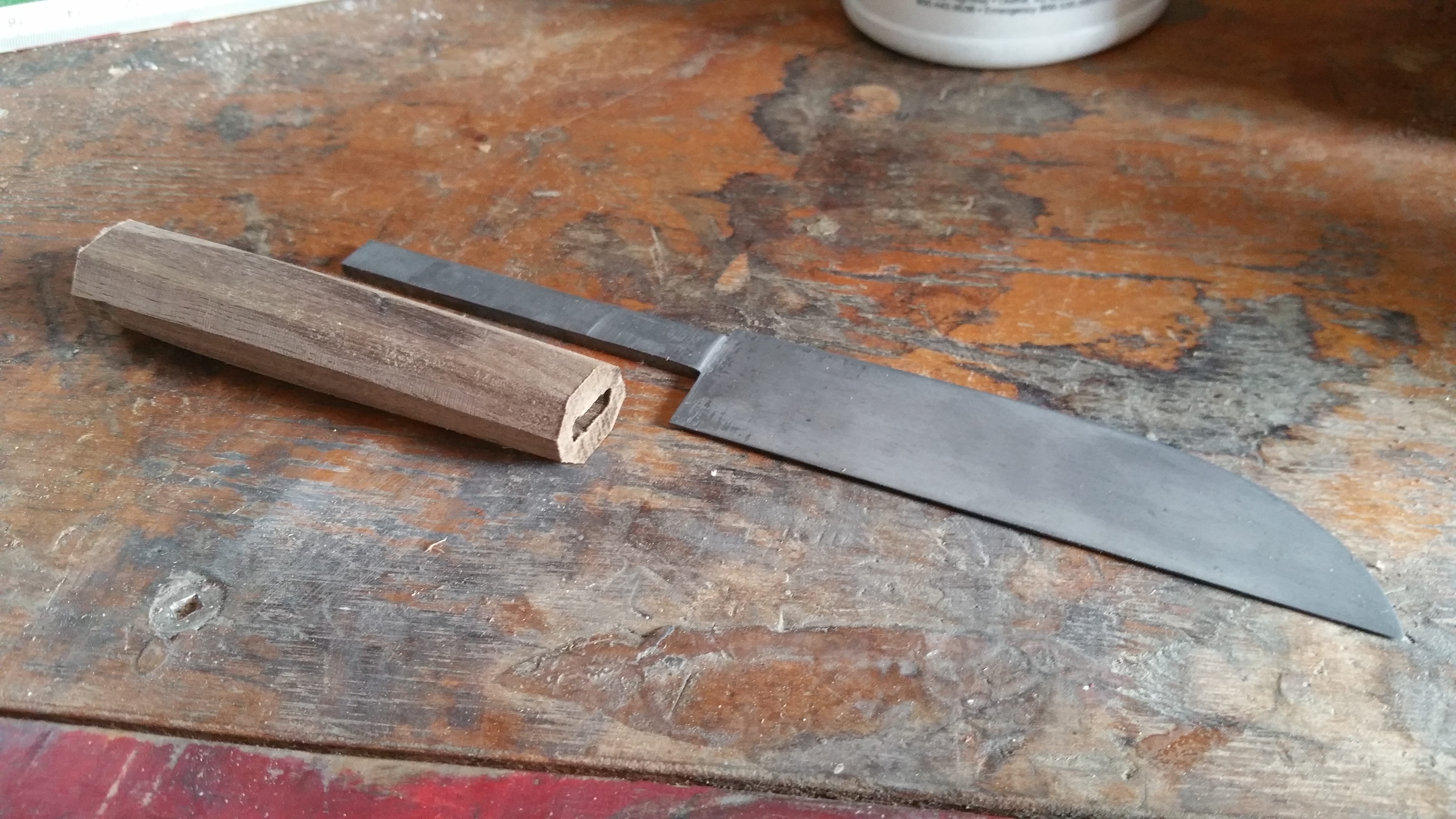

The next morning, after much sanding, first roughing the 45's out on the disc, then balancing everything on the belt, and making the final adjustments by hand:
^^^ This picture here contains a mistake. The handle is upside down here. It's supposed to be flat on top and widen on the bottom. Luckily it was just a mock up.
There was one thing I did last minute that I almost forgot. I added notches to the tang to help the epoxy hold it inside the handle. It's probably overkill, but it was so easy on the belt sander that I see no reason not to do it.

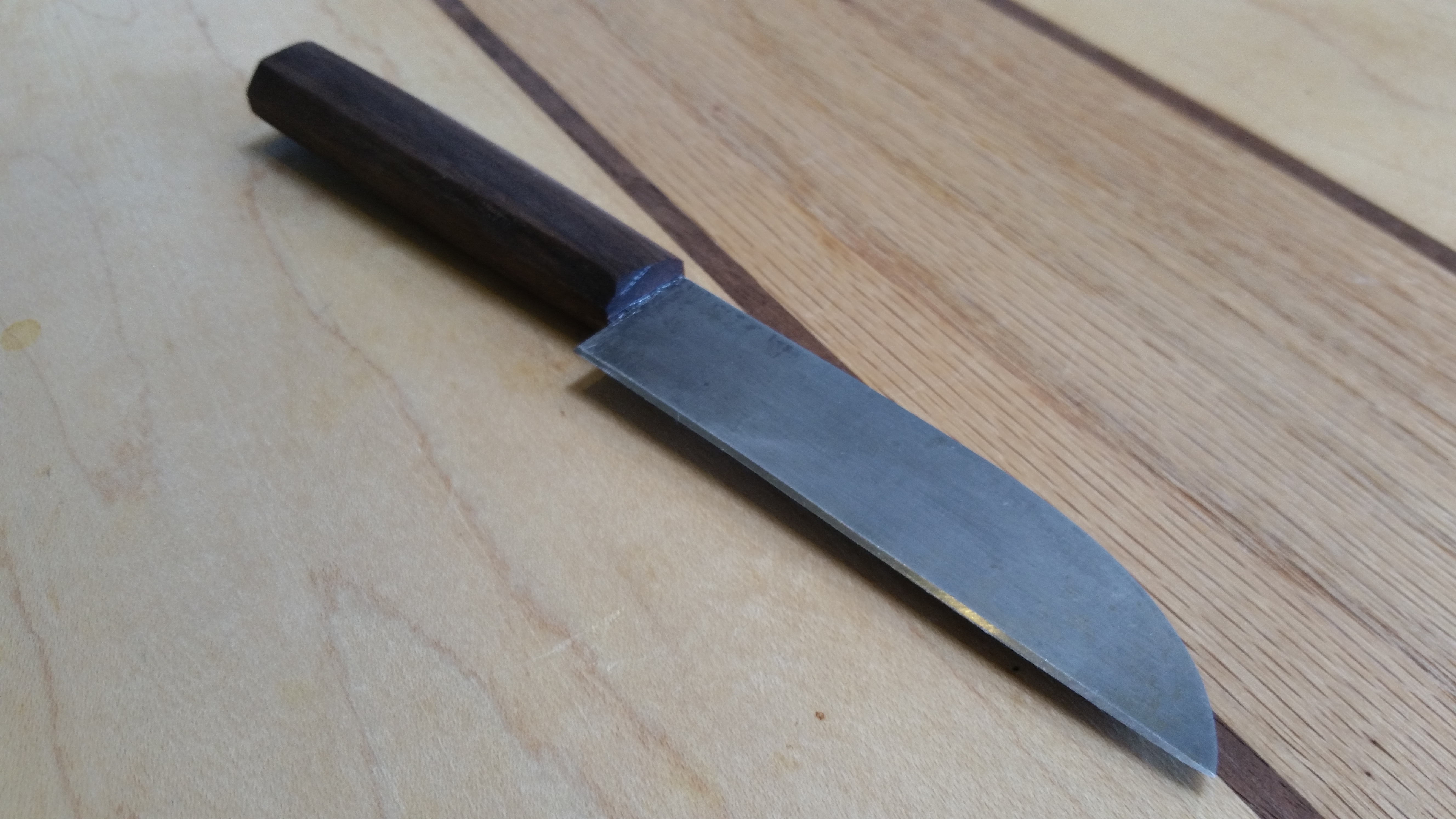

And DONE! I epoxied it in, nothing special there, then sharpened it and finished the handle with Howard butcher block conditioner. (beeswax and mineral oil). Something not pictured is that I 45'ed off the very corner of the heel, someone was concerned that it would bite unsuspecting fingers with a corner that sharp.
