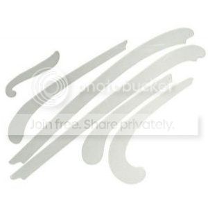

I bought a set of ships curves to aid in my drawing and it made a huge difference. One great thing is that they have no straight lines so every knife I draw is curvy.
