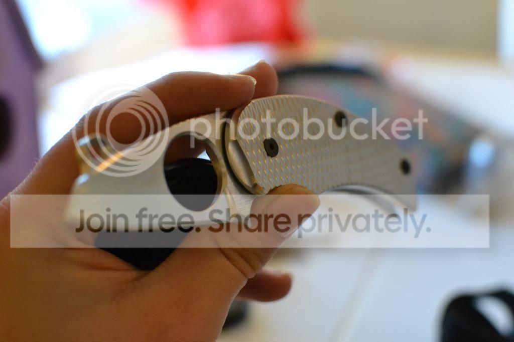

When designing my first knife, I thought to myself-- "What has every other blade maker done wrong?"
I figure every blade shape and design has been done, not much to innovate with there. So maybe materials? There are lots of different scale and handle materials.... but virtually every knife uses a steel blade of some sort.
Then it hit me. ALUMINUM BLADE!
As a machinist, I don't much like hard steels. Aluminum is much easier to cut, so why go through all that hassle? Surely it would be easier to make a knife entirely from aluminum, and after all-- many grades are available pre-heat treat! So I chose 7075-t651. Its harder than some steels!
It turns out I was entirely correct!
quick video as well.
http://www.youtube.com/watch?v=hpaUj7OHPt4
P.S. I'm having some issues with edge retention-- this thing simply wont stay sharp! Any ideas?
P.P.S Please don't burn my house down :(
Now-- hopefully its apparent that my post is largely satirical. I cant actually call this a WIP, I should call it more of a learning experience. I based my design largely off of another designers knife, and have no intentions of producing anything further on this design. It was more of a functional test, and of that, I can call it a success. The bearings fit, and functioned properly until they wore a severe groove into the blade. The lock geometry wasnt quite correct, but it gave me an idea of what to do in the future.
Anyhow, I just felt like sharing the first step of my experience. Feel free to lambaste me, or preferably ask questions.

Now that that is out of the way, that is a pretty slick looking knife. Sad that it is made out of Aluminum. Lesson learned about it not being a strong enough material for a blade and the edge retention issue. Other than having it readily available, why did you use it? You didn't really think it would hold a good edge?
The fit and finish show your background as a machinist. Now use that to make another one with a proper blade material and you will be in business!
Please post how your next one turns out.
Problems with edge retention are directly related to lack of a "high" rockwell hardness, that is to say that typically the harder the steel the higher edge retention. There is trade off though with the "upper limits" of a blades hardness, typically when the hardness goes up the toughness goes down. The same holds true for softer steels such as a 420HC or a "surgical" steel used in some factory knives. these 400 series knives will get super sharp, but there is both lack of egde retention, and toughness in the steel. without any carbon present in the blade, cutting power and edge retention are going to be difficult....unless you are talking about the stellite type blades....all together different.
The knife is a neat design though. Its a neat concept, and alot of things are perfected through trial and error. It might not be perfect or practical for a knife, but thats the way I feel about alot of art knives.....all show and no go.

I never had any intentions of aluminum being a suitable blade material in any way-- Its simply easier to work with, and could at any time be replaced with a suitable steel-- Even the liner side of the frame is aluminum, and is also in no way suitable for that job, either. In fact, the first few iterations were 3d printed plastic.
