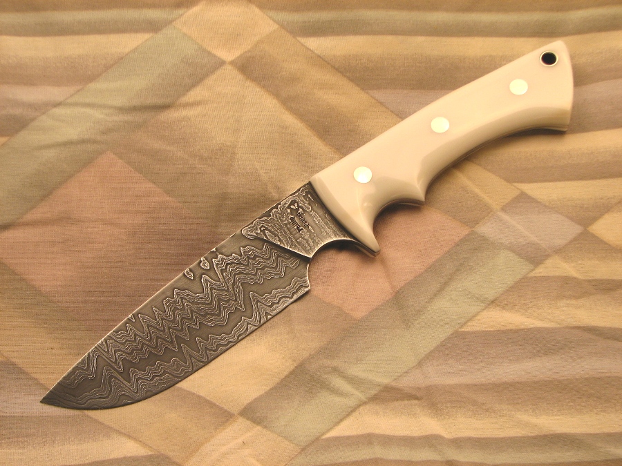

First knife with corian
Phillip Patton
Jul 25, 2005
5,402
Specs:
Steel: 1084/15n20
Blade length: 5-3/4"
Total length: 11"
Blade thickness: 3/16"
Handle material: White corian
Thanks for looking!
its plastic countertop material. you can cut it with a saw. it sands and shapes easy but its a little slick. phillips handle shape will give a good grip though.

Phillip, how does the Corian compare to ivory Micarta?
Looks good. My corncerb with Corian, Fountainhead, etc has been that it is heavy as all getout. How does the knife feel?
Nice knife Phillip, really like the tapered tang and the handle contures.
Monty
Thanks! I should have used a lighter colored background, then the handle wouldn't be so washed out. Then the contours would be easier to see...

sweet knife phillip. is that some of the corion i gave you?
Thanks Richard! Yes, it is some of the stuff you gave me. I really enjoyed working with it. Thanks again for giving it to me. :thumbup:

Very cool. What was it like working withthe corian? It sure is white.
It cuts, drills, grinds, and polishes easier than micarta. The only downside is that it's not as tough.
This stuff is very white, and it's somewhat translucent. I have some that Richard gave me that's more ivory colored. I'm looking forward to trying that out.
I don't think it's much heavier than micarta. Of course, micarta is heavier than most woods.... It feels fine to me. :)
