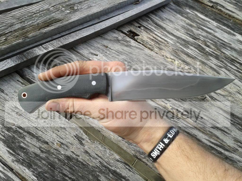

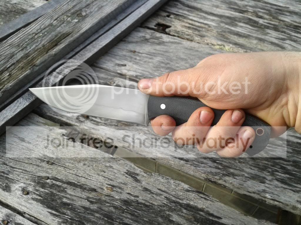

Ok so this knife has alot of firsts for me. How did I do? Critiques welcome I wont get mad I would just like some outside opinions. My wife always says they look great! haha

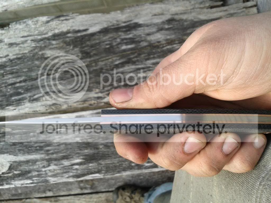

And yes I did notice some slight gaps at the liners. Not sure what I did wrong there.
Side note: I would have used copper corbys but they were not long enough so I had these on hand.
Stats!
Steel: 1075
Blade length: 5" 7/16
OAL: 9" 3/4
Handle: Black Micarta with copper liners held with stainless corbys and copper lanyard tube.
Those liners are beautiful. I never see that. I'm not sure I'd have liked the idea on paper, but it really works here.
Love the profile and swedge.
Looks really nice. Copper Corby's would have been perfect, but the stainless aren't bad either.
Nice work.

That looks fantastic! The only small (very small) critique I have is to maybe knock that hard angle off the front of the scales. It looks very abrupt from the top view. Outstanding job, I love it.
I agree on the drop off. I got to that point and kinda got lost on what I want to do. I want to and still can change it but was scared of ruining the whole thing. So left it blank so to speak for now.
Look at some Fiddleback Forge knives. Although usually more rounded at the shoulders, they may give you some ideas on how to deal with the forward area of your scales.
Btw, I just realized how short your ricosso is. Until someone mentioned it the other day I had never given it much thought. I really like how it looks on your knife. I believe I'll try something similar on my next.

Very nice design. Well proportioned, aesthetically pleasing, nice hamon and uniform finish. I also like the short ricasso. I'm placing it about the same way on the recurve EDC I'm doing now actually. Makes it look tight and functional to me...
I have done copper liners before and they are a bear to keep the unions between materials sharp and crisp. Even working it copper can tend to get out of shape. Rounding of the very edge can cause it to look gappy...
