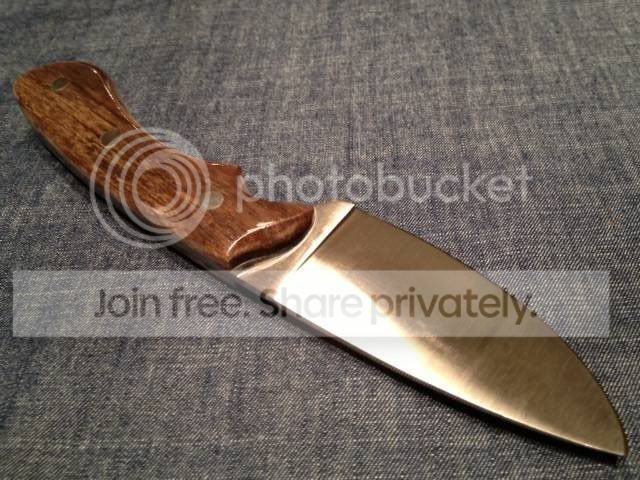

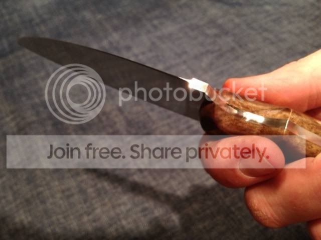

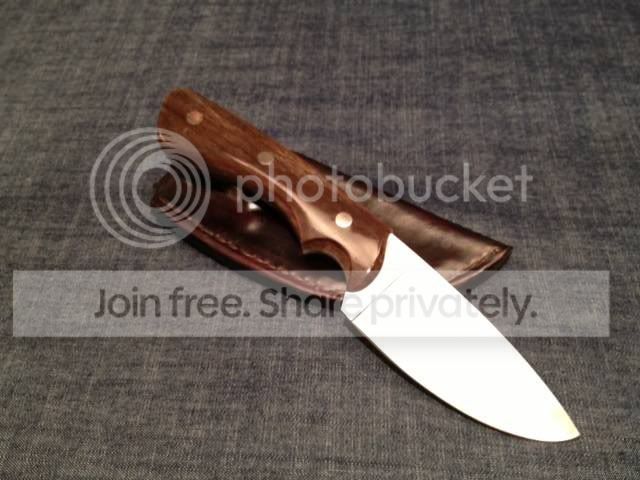

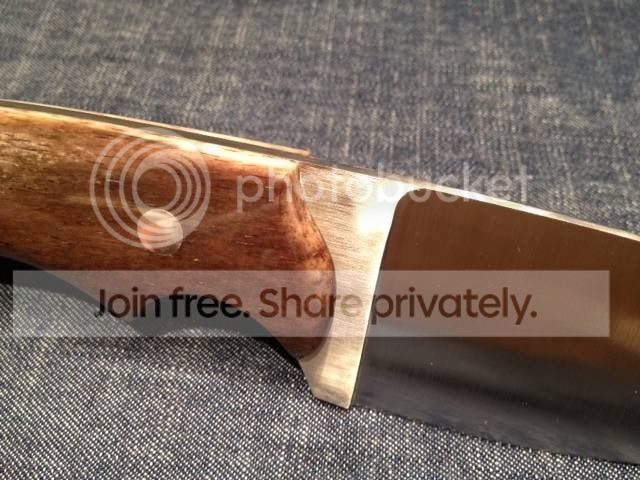

After a lot of forum stalking, headache and literally years trying to get space, tools, and time together I finally finished my first knife. There are obviously some flaws I couldnt, or didn't have time to sort out. But for a first I'm pretty happy. Didn't mean to grind up to the spine but I couldn't get the lines symmetrical and ended up chasing it to the top. A couple of low spots in the blade that I couldn't clean up because I was running out of room at the spine and at the edge. Ran out of time and didn't get it as clean as I would have liked. Only took it to 600 grit on the belt sander. And there is a streaking or something in the blade. It showed up when I cleaned it with denatured alcohol. I doubt that had anything to do with it though.
Anyway, Tomorrow it's going to a auction benefit for a wildlife management association here in Texas. Hope they enjoy it.
Ats34
Dyed giraffee bone
Stan buzek is an awesome dude and heat treated it for me. Thanks again Stan.

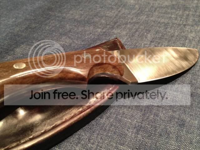

Bought a simple pouch sheath, dyed, fit, burnished and buffed. Not great, but it holds it tight.
Thanks for looking

That is awesome for a first knife. Most of your problems get worked out after you practice a couple of knives.
Questions for you then: why didn't you want to grind up to the spine and why not go from 600 belt finish to say 1500 hand sanding?

Congrats. Looks real nice for a first. It has a clean, balanced profile and appears to be executed fairly well. One thing to think about for your next knife would be developing a clean hand sanded finish. Great work.
Erin
Thanks everyone. It means a great deal. I've been lurking in the forums for YEARS with out making a single thing. I am constantly amazed how good everyone's work is.
Weatherman. I just prefer some sort of flat, and a clean grind line on the sides that sweeps with the edge. What was happening was that, on two blanks, I would reach the point I wanted nearly perfect then i would try to get it "just a bit better" and then wham, the sides didn't match. One side would be exact, and the other would either be be a bit more angled than sweep with the edge, or I would dig to far into the plunge line trying to get the line parallel to the edge. Well by the time it was done I was at the top.
Luckily I was able to keep the flat from running over the spine and notching the spine.
On the sanding, it was really an issue of time. I had to get the blade where I could so I could get the handle on. I had no idea how long that was going to take me to shape and polish. I didn't have the higher grits so it would have set me back a full day until I could get to the supply store I would have loved to get it up to at least a 1200 grit. I did make one other knife, (had help from Stan grinding, so I don't really cont that as "my" first). I took that one up to I think 1200 by hand and it had a satin had finish. Because I stink at it, and it takes me 3 times as long, I knew I didn't haven't the time. I am embarrassed By the 600 grit finish but at least I was able to submit it in time and didn't miss the deadline.
