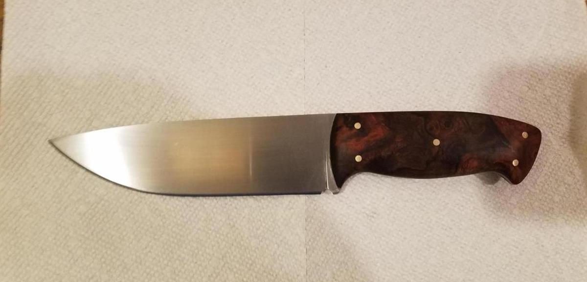

Hello,
Here is my first knife it is made from 1084. Im looking for feedback so i can improve. I already have learned a lot of things I can improve on just from making it. I need to get alot better with my plunge lines :)
that's actually really very nice. if I were you, I would use it and enjoy it. test it out, see what you feel like would make it better next time. if you haven't the time, I'm sure I know someone who would be willing to help you out.. lol [emoji38] great knife, man! [emoji4]

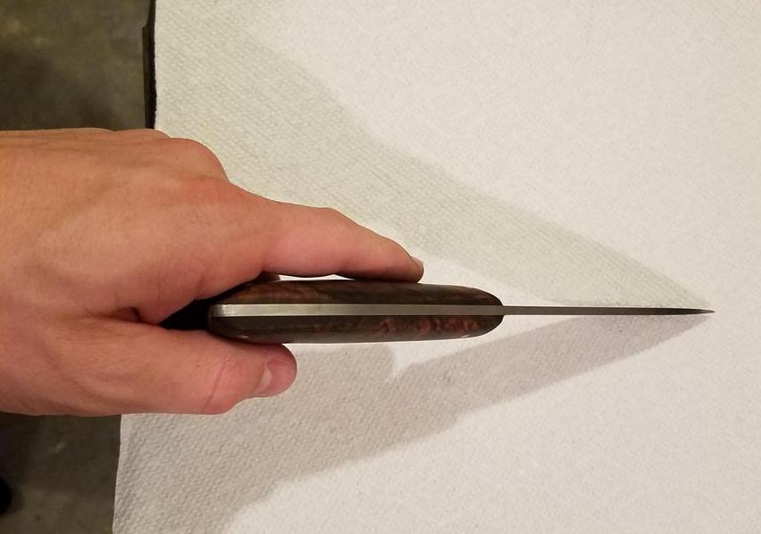

Looks great for a first, I agree about the ricasso. That would bring the scale back enough to avoid that thin point of scale material by the index finger. It wouldn't take much for that to chip off.
A larger ricasso will also give you room to put "Jpthundernuts" which sounds hilarious, and awesome at the same time.

Haha thanks! I definitely agree I needed to leave more ricasso I sanded it all to 600 grit but then covered it up.

Mostly Angle grinder and files. Used angle grinder for basic shape then used files to get it exactly how I wanted it. I used a gough jig to file the bevel. Heat treated with a atlas mini forge and tempered in a small oven at 425 degrees. Then lots of hand sanding to get a satin finish. Then a 1x42 belt sander was used for the profiling the handle.
Damn good start for a first knife! Hard to tell by the pic but it looks like the plunge only runs halfway back. On a full flat usually this runs further back towards the spine. It looks like you have a good grasp on the basics, now its just focus on fit and finish and getting those nice crisp lines.

thank you I will look to improve on that on my next knife
