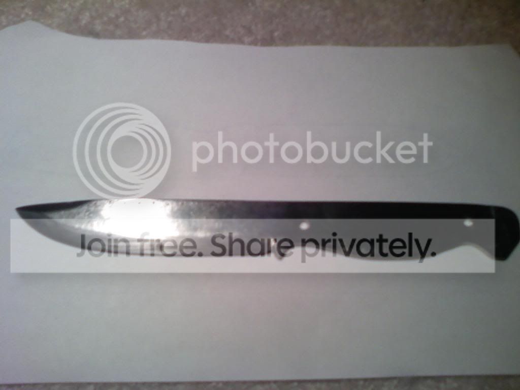

I used an old bastard file that was laying around,and just started on it today.
it is looking a little shanty and I do not know what to do now.
any tips and constructive critisims?
The shape looks very good. You might consider bringing up your bevels a bit more. The angle looks a bit steep unless the blade is very thin.
What are you going to use for handles?
Charlie
for the handle I really want micarta, but at the current state Im probably going to have to use wood.
the whole purpose of making the knife is becuase I like to do bushcratf but I dont have the funds to buy one
I agree, bring the bevels up more to thin out the blade...
I know that the Ray Mears / bushcraft / mora style is that way, but thinner cuts better.
Drill another front pin hole the the same level as the rear one is - higher .
drill some additional holes in the handle to allow for better epoxy grab
