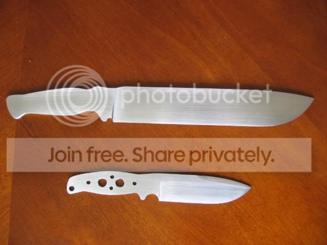

As a kid I grew up in a home where we had a lot of woodworking tools and I got this crazy idea one day that I was going to use these tools to make a knife. I never did it but I still remember it consuming my thoughts for a while. Fast forward almost 20 years and my thoughts are consumed again. My love of outdoor activities has cultivated my love of outdoor gear, especially guns and knives. I started lurking here in the shoptalk subforum last year and I've slowly taken steps to try and make my own knife. So here I am to critique what I've done so far and to ask some questions about where to go from here. Any comments, criticism or answers are greatly appreciated.
Tools I've used includes a HF angle grinder, HF 1x30 belt grinder, band saw, drill press, hand files and sandpaper. Steel is 1095. The designs are my own although as I look at them I can see that one in particular is influenced by a couple well known makers.

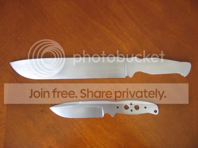

First one is a mutt. I'm not sure which category to put it in. As I'll discuss later my design got a little muddled and is neither here nor there. It's a 4 3/4" fixed blade out of 1/8" stock with OAL of 9 3/4". The second is a big chopper. 10 3/4" blade out of 3/16" stock with OAL of 17". Both have been profiled, ground and sanded to 320 grit. I'm planning on using homemade micarta with either brass or nickel/silver pins for the handles with lanyard tubes.
Here's some pics:
Self-critique:

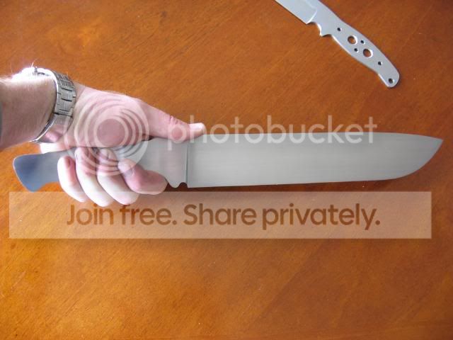

Chopper

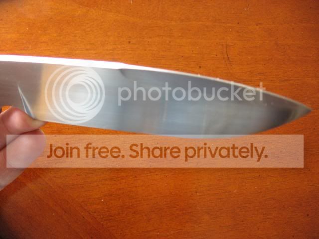

I'm actually quite happy with how this one has turned out so far. The grind is supposed to be full flat which it very nearly is. I ended not quite at the spine. It really is pretty flat but only due to a lot of time draw filing. It took an eternity to grind this on my 1x30 sander. My plunges kind of suck. They aren't quite even and they are a little rough. I had hard time making them nice and smooth both while grinding and hand sanding. I also had a tough time with keeping a flat grind as I transitioned to the tip. It seemed I was grinding either at the spine or the edge but not getting a single plane from spine to edge. It turned out OK though I think.
The handle shape I really like but the scale is off. I think it's going to be too large. I can't bring myself to alter since I think it looks nice with the blade. I make a thumb depression on the spine for choking up and the handle thins to the rear with a knob to hand on to while chopping.
I'd say the blade style is reminiscent of Busse and now the Rat Cutlery Junglas machete but I had this designed before the Junglas was announced. In looking at the handle it is maybe a little Scrapyardish? Overall I like it.
Mutt
When I designed this one I was kind of thinking about the Rat Cutlery RC4. I really like the RC4 but if I could change anything about it I wish it was thinner. I wanted my design to be a ~4" general use outdoor blade like the RC4 but in 1/8" stock.

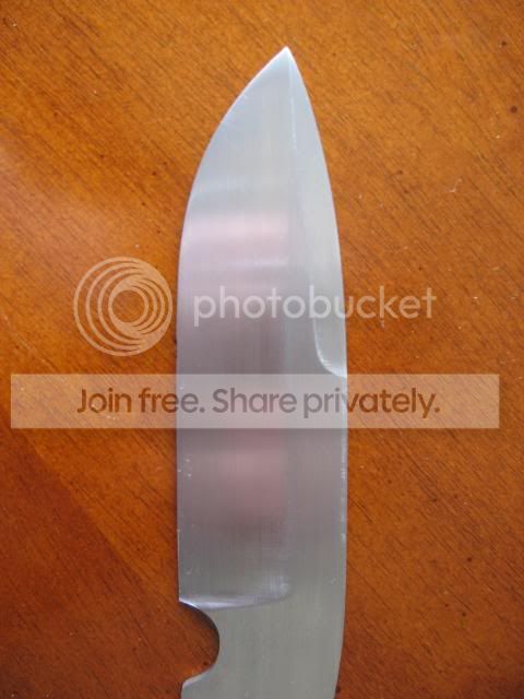

I gave it a choil and drop point blade. The handle as it started out was quite different from how it is now. My original design was too complicated and looked horrible. After profiling it initially I started reshaping the handle freehand until it look like it does now. I now have a simpler handle that still looks horrible. The blade would have been OK but after grinding it I thought "I wonder how hard it is to grind a swedge?". So I tried it and now I have what I think is more of a fighter style blade on a knife I orginally wanted for camping/hiking/fishing :foot: ......and it has a choil.:rolleyes: I really like the Rat Cutlery choils but mine...not so much. So like I said this knife is neither here nor there from a design standpoint. I'm going to finish it though since I have nothing better to do.:D

Really nice job!!:thumbup: I just sent you an email with some info.
Those look better than the first 10 knives I made with the same tools. Any plans for heat treating?
Its almost impossible to drill round holes with a drill bit. Drill bits drill elongated holes.
If you want a round hole use an undersized drill bit and follow it with a ream of the size needed for the finished hole. The hole will be round.
A decent drill press doesn't hurt either.:)

Is your drill press shaking and vibrating when you're drilling? It could be your drill bits aren't balanced, that is, the tip isn't centered along the length of the drill bit. Do you sharpen you're own bits?
The drill press runs really smooth actually. No vibration or anything. I don't sharpen my own bits. The 3/16" holes were fine but when I drilled the larger holes I noticed a slight tri-lobed appearance. They're mostly round but with the slightest triangular shape. It's noticeable in the pictures. It's a pretty old bit I acquired at some point and was not purchased new by me. Maybe it the bit? I'm not too concerned since I was only using the larger holes as a way to remove some material from the handle.

DMD08 very nice. How wide id the big chopper? I like the design and am looking for a design for a new project. Wondering if the stock I have is wide enough for something like that. John
A hair under 2 inches.
