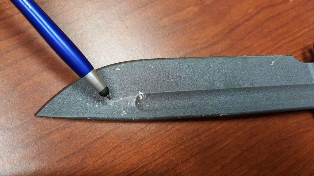

I sent my knife in to have a custom kydex sheath made for it. just got it back but im surprised because it rubs the blade a lot sliding it in an out. to the point that its rubbing the blade finish away slowly and every time I remove the knife, there is kydex shavings on the blade.. Is this normal or did they do a poor job building my sheath?? The place I went with was highly recommended and I don't know if this is just how kydex works itself in..?? If you own kydex please chime in and give me some input!!

Kydex itself won't scratch the finish. Dirt and grit in the sheath or on the blade will. If the sheath was molded properly, the blade should have been covered in three layers of blue masking tape so as to provide the proper clearance before the kydex was pressed. Wear marks will occur over time, but should only appear as shiny spots, not scratches. With proper clearance, it should NOT be shaving kydex.
It probably rubs a bit worse too due to the deep blood groove in that blade. Either way, I think you should be ok. It will break in a bit as the sharp edges polish the inside of the sheath.
Poor job. Some rubbing is normal but when knife shaves off kydex as much as seen on your photo, it's just too tight.
I agree, I have used kydex holsters for guns and knives for many years, and have never seen that kind of extreme scratching.
Can you post a pic of the sheath? I really don't think it's that bad man. A bit of shredded Kydex is normal in my experience. Plus, that blood groove is really large and deep which is making it scape more I think. You could always contact the sheath maker and ask if your that worried.

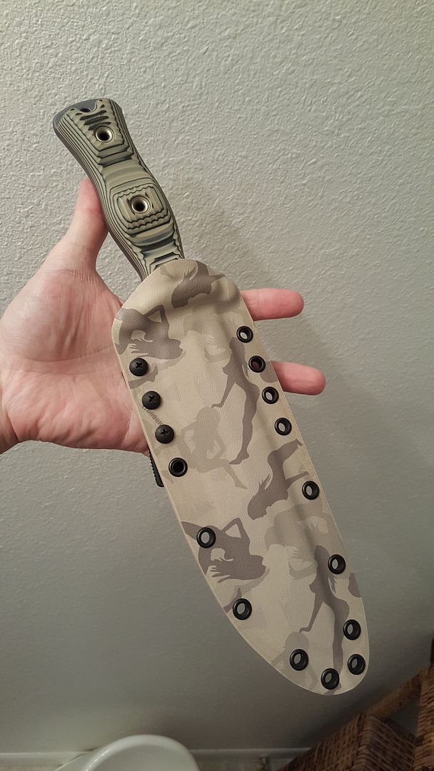

Here she is! Honestly It's not so bad now.. I contacted them an they said to use a touch of wd-40 an wow it made all the difference. I'm surprised. :)
It looks good but a little more prep in the fuller area would have helped there. The knife shouldn't have it's retention from being tight on the blade. The shavings also could have been left in the sheath when the top was being finished and not necessarily being shaved off from insertion. You can use some blow off or a compressor and try cleaning it out, then see if it persists.

Thanks TravisH, yes I contacted them and they explained that the only part.on the blade that is touching is where it grabs in the "blood groove" they said they could loosen it but it may rattle in the sheath. They said the blood groove is unusually large on the Busse an to try a little wd40, I did an it works AWESOME now..very happy!!
