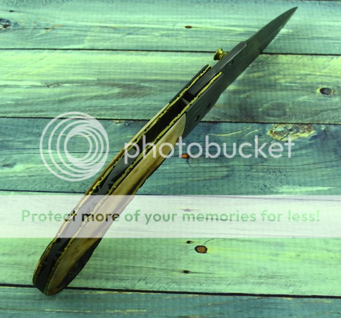

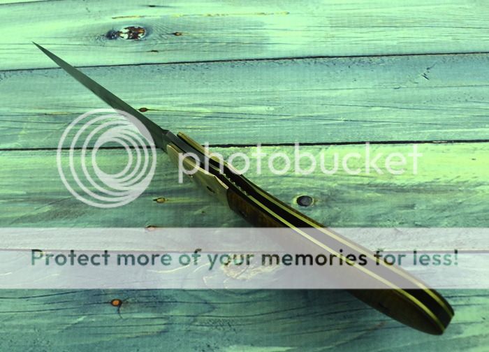

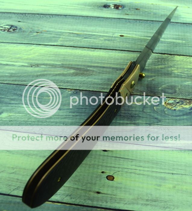

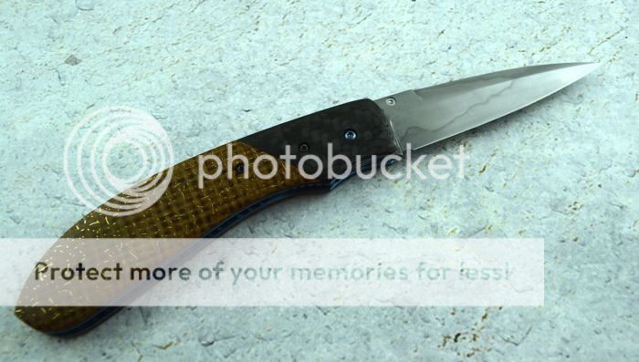

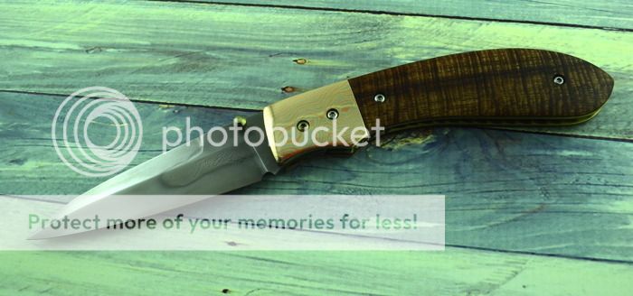

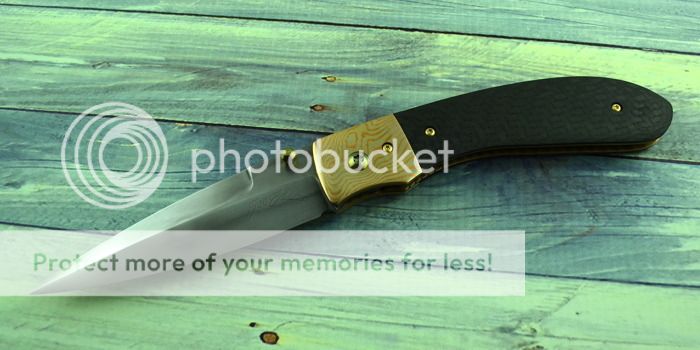

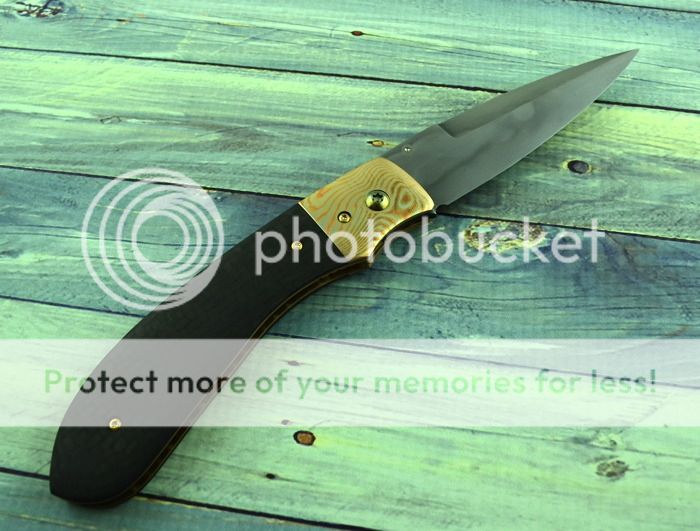

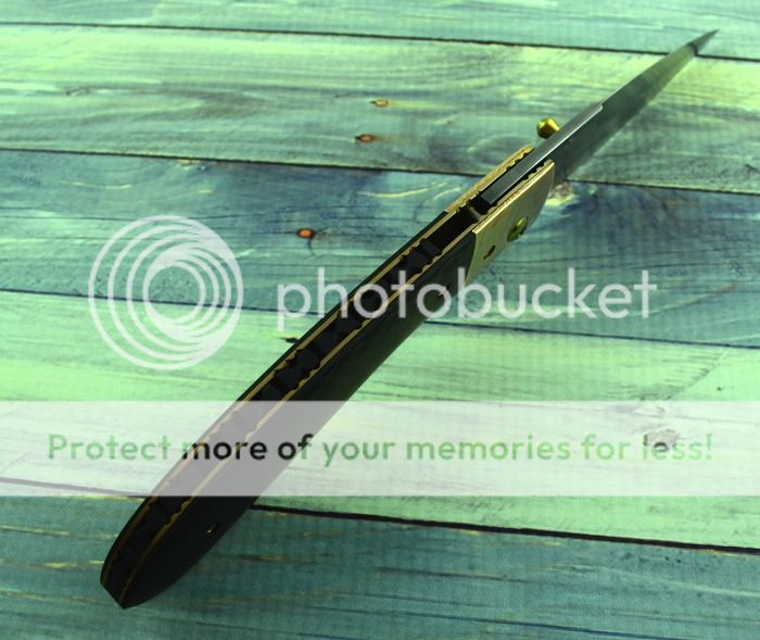

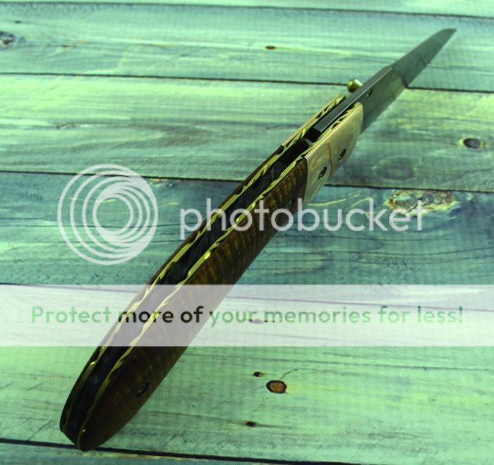

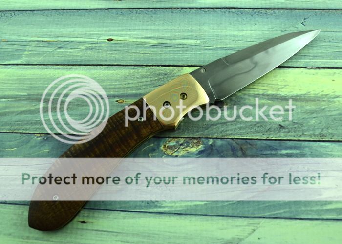

After many drawings on paper and then modeling with Kydex I finally gave these a go. Certainly learned a ton through the build process and likely will be doing some changes on the next go around. I just used materials I had on hand and likely will be doing some more rust resistant ones going forward.
Comments and critique are certainly welcome and appreciated.

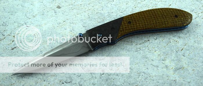

1st one:
W2 w/ hamon
Carbon fiber and Kevlar Scales. carbon fiber back spacer.
Jeweled and Blue Anodized titanium liners, thumbstud and pivot screws.
2nd one:
W2 w/ hamon
Mokume bolsters (lightly etched) and carbon fiber scales. Fileworked carbon fiber back spacer.
Jeweled and gold anodized titanium liners, thumbstud and pivot screws. Gold handle screws.
3rd one:
W2 w/ hamon
Mokume bolsters and stabilized Hawaiian koa scales. Fileworked carbon fiber back spacer.
Jeweled and gold anodized titanium liners, thumbstud and pivot screws. SS handle screws.

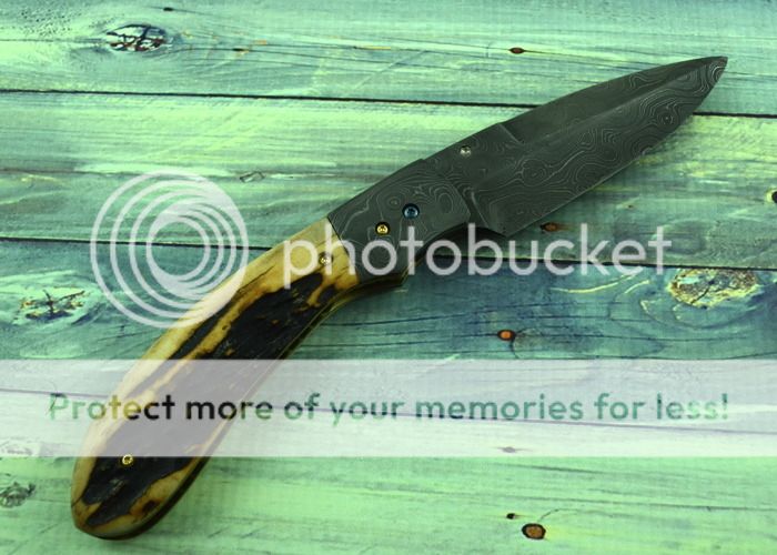

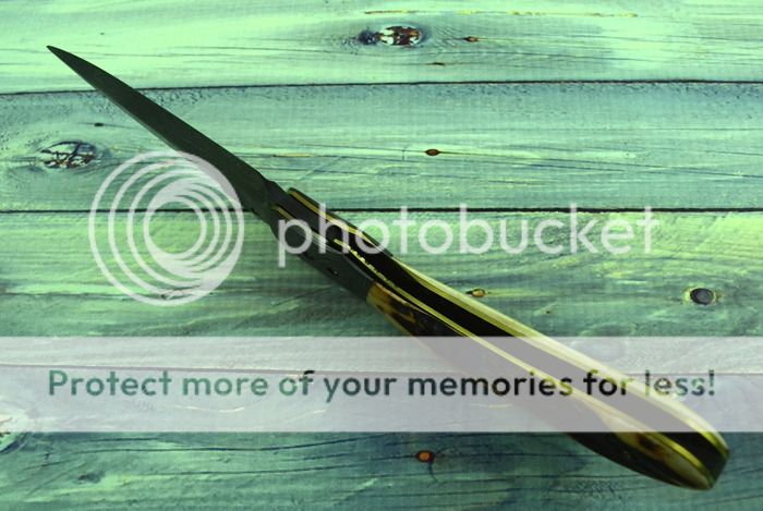

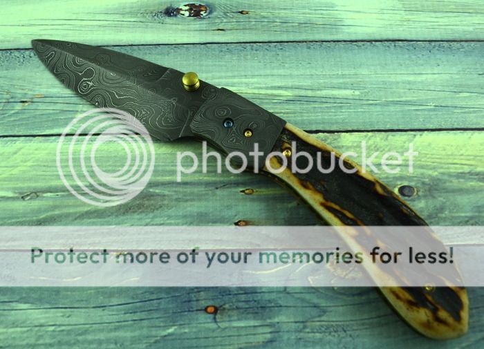

4th one:
Alabama Damascus w/ matching bolsters and backspacer
Sambar stag scales
(photos before putting an edge on)
Thanks for looking!
I enjoy the aggressive blade-style and the sleek lines....nicely done. :)
Nice looking folders all the way around
Well done
