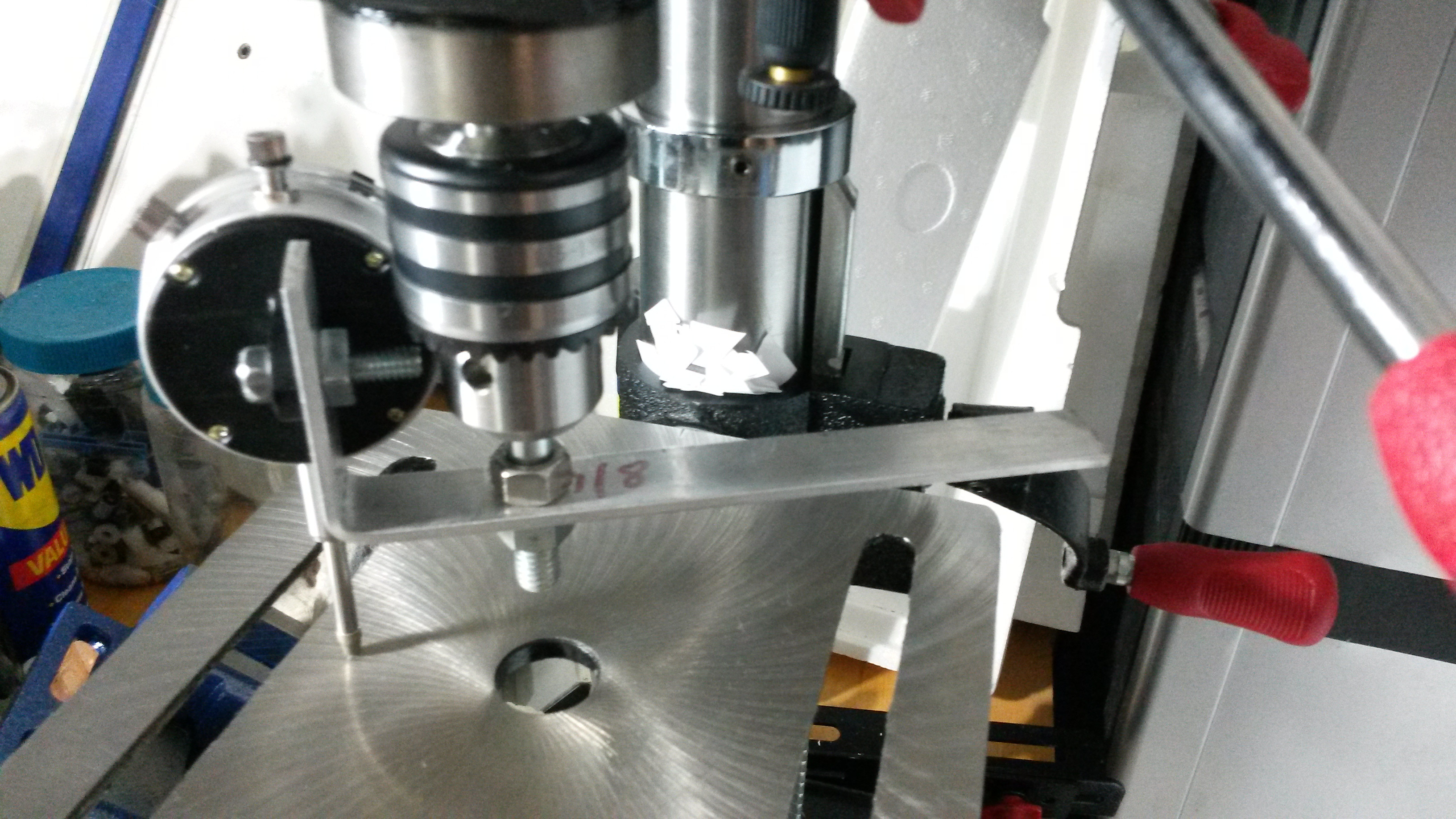

What scale material are you using? I've pretty much been using a regular drill bit to counter bore all of my screws. I would think that maybe your drill press setup isn't very square, but if you're using it to drill and ream your pivots and pins, then it's probably not the problem.
As for the second one, I don't see a problem with that, I thought AKS pivots were specifically designed to be press fit on one side. Only thing that might be an issue at all is getting everything lined up during assembly. I usually go with a snug slip fit, but what do I know, I'm barely half way through my third folder.
I forgot to say, nice design by the way. I'm looking forward to seeing how that knife and this WIP turns out!
I definitely need to look up some articles on making sure my press is square. It's an older craftsman 15" floor model. The handle scales are g10, and I can't take credit for the design but I hope to come up with my own on a later attempt.
Probably a good idea to check for squareness anyways, especially if you're doing folders.
Lots of different ways to do it. You can put a big rod in your chuck and butt up a square against it, you can use a bent coat hanger and see that it touches the table evenly throughout its whole sweep, or you can use a dial test indicator. I used a $15 dial indicator, some paper shims, and a little jig I made in 15 minutes.
