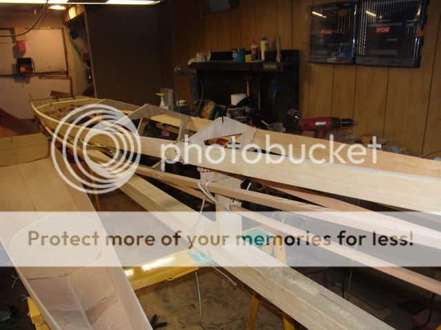

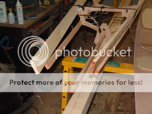

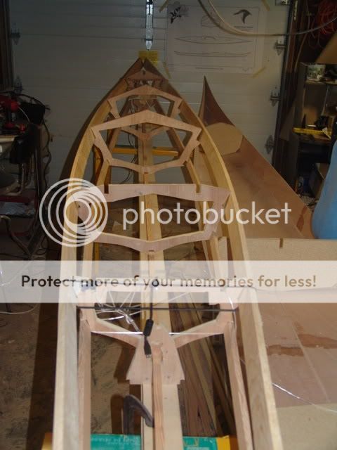

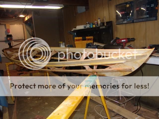

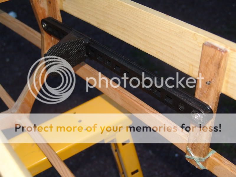

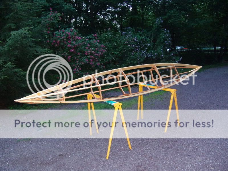

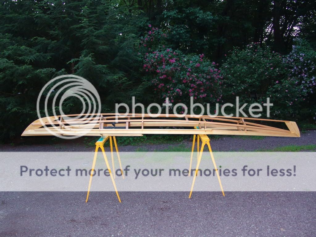

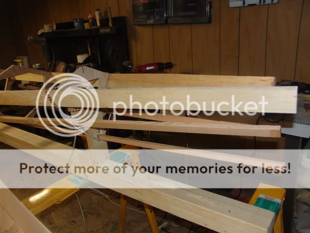

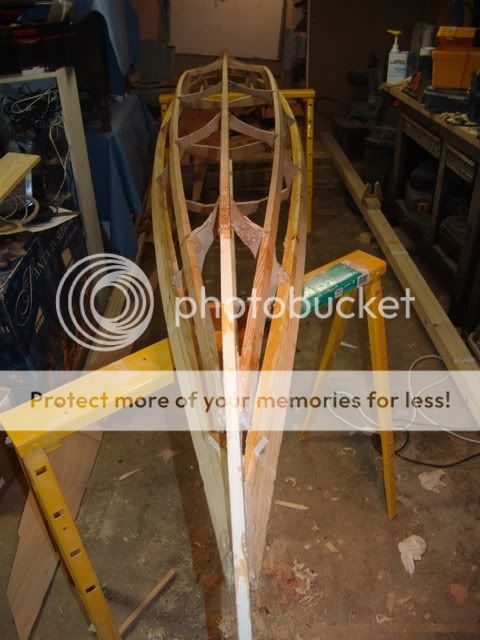

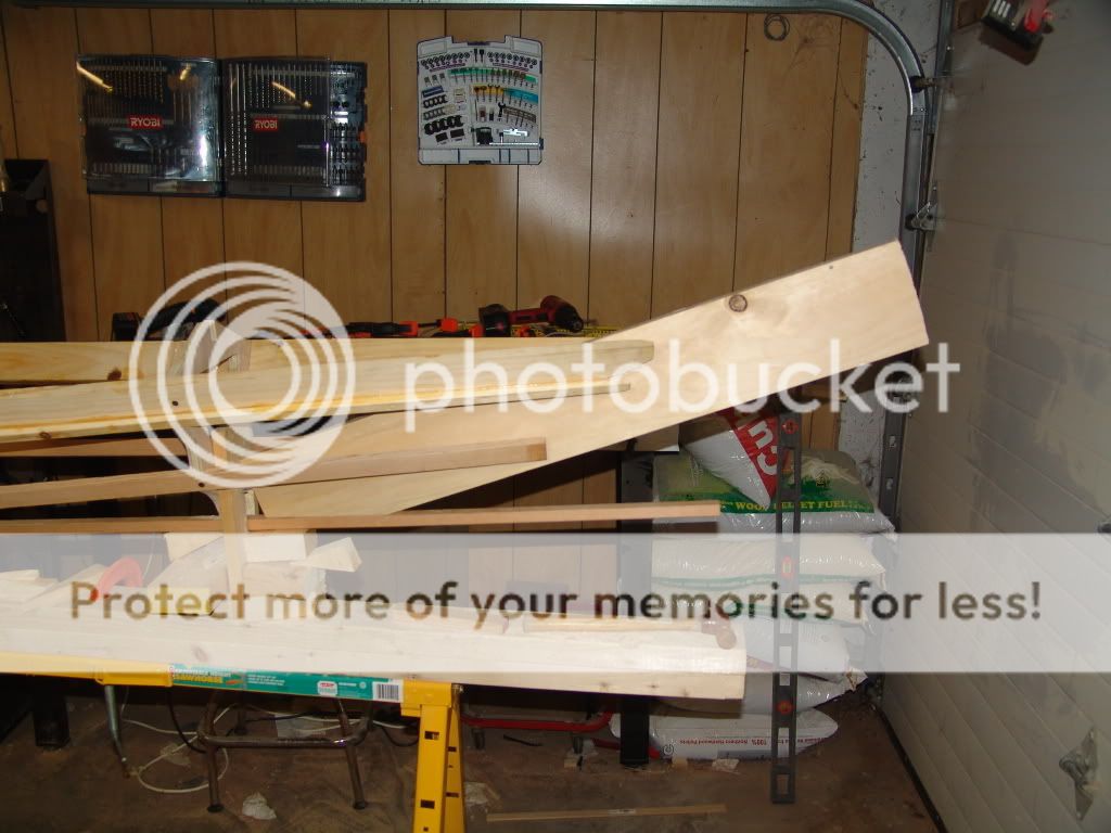

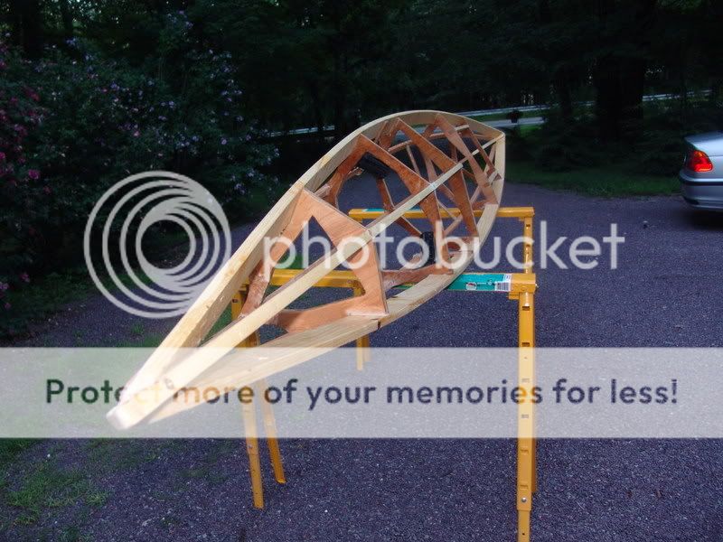

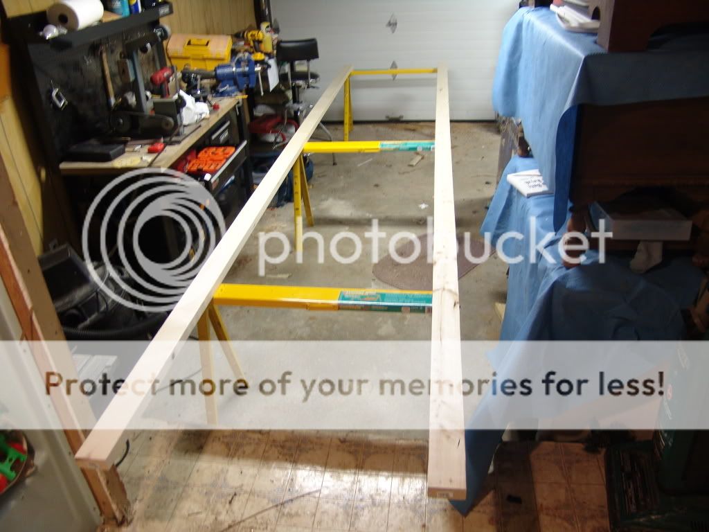

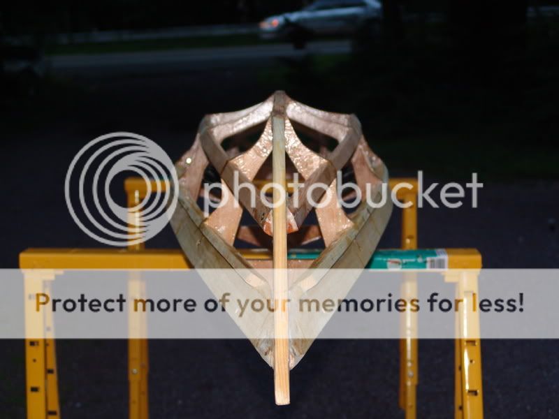

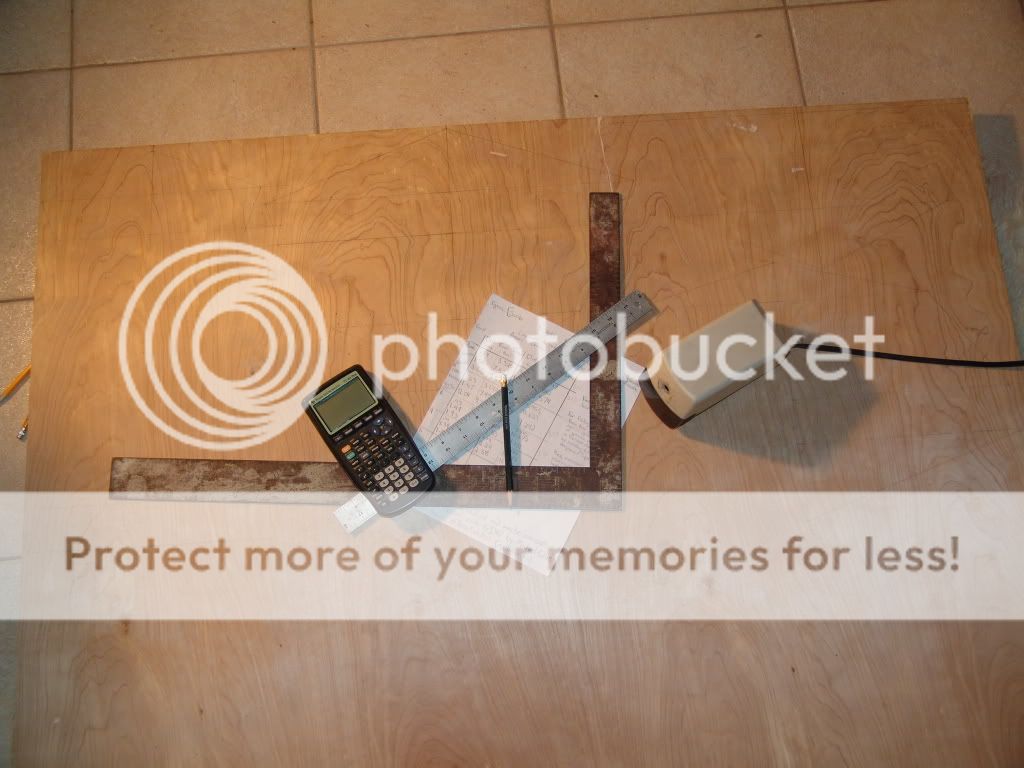

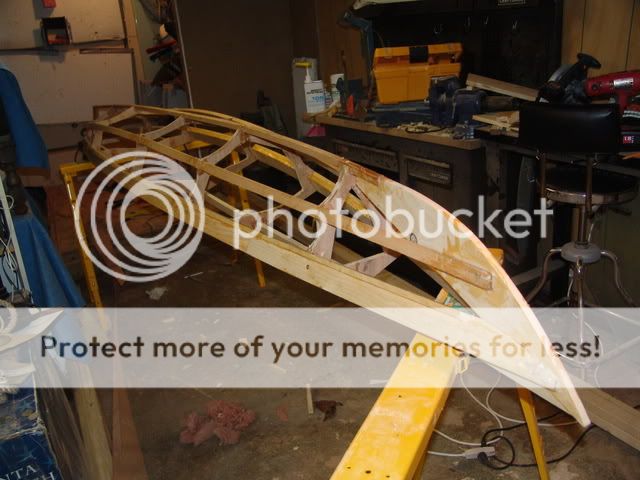

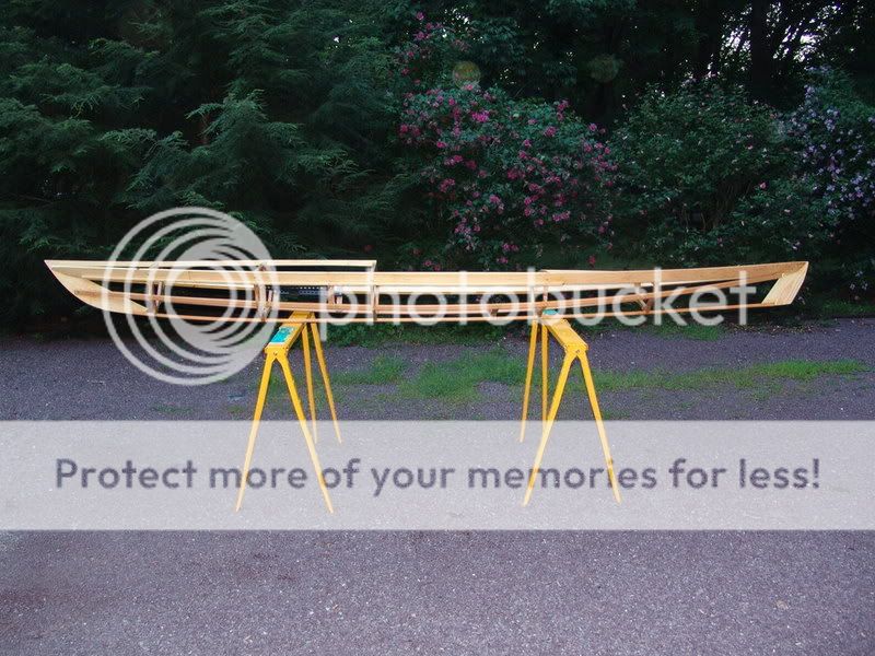

Here are some shots of the building process:

Baidarkas are a form of kayak used somewhere in the arctic by some indigenous population. They are made using a similar construction method where material (seal skin in their case) is stretched over a wooden frame. They have a certain shape and form which is not the same as the one I've used. I believe they're longer and have more stringers running along their length. They also use ribs spaced every few inches rather than stations several feet apart.
Snow,
Yup, first boat. Easy if you're patient with it. I used a design generously posted for free online by a man named Brian Schulz of Cape Falcon Kayak:
http://capefalconkayak.com
As far as I know, I'm the first person to have built it using this construction method (stations instead of ribs). It was a lot of fun, and I have two more half-built right now.
This boat is called the F1 and you can read all about it on Cape Falcon Kayak. It's a surfing/all-purpose boat. Great boat for exploring, in my opinion.

I was impressed with the finished boat. Now that I've seen the process, I'm really impressed. When I was a kid, my dad built a kayak from a Folboat kit. It wasn't nearly as sophisticated or pretty.
Excellent job, CanDo! Great photos of the whole kayak building process and your shoreline excursion photos are really great, thanks for sharing.
