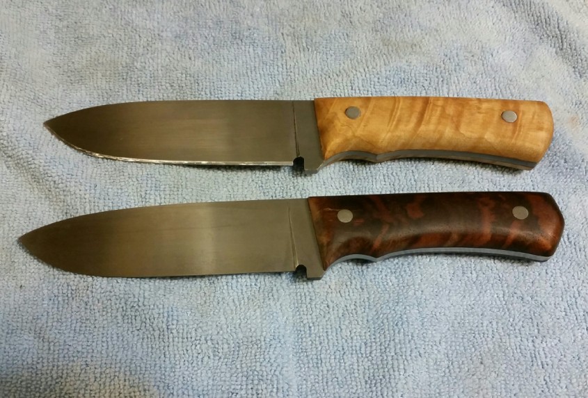

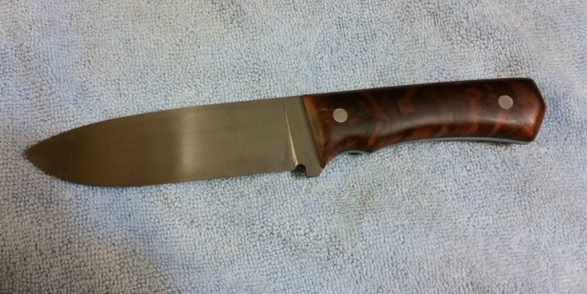

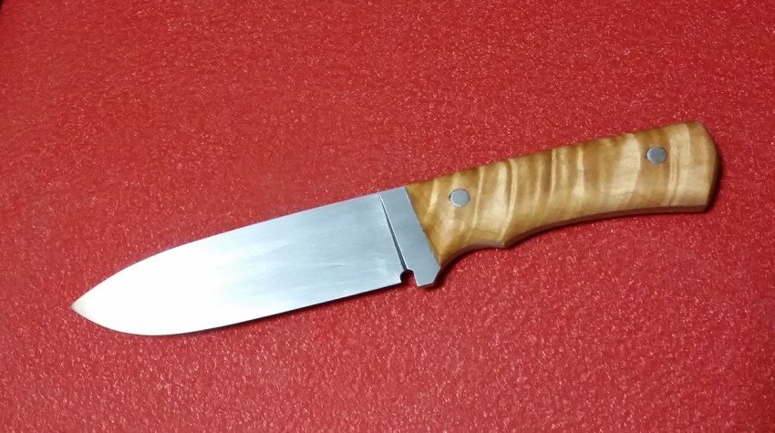

Hi All,
Been lurking around here for some time, and just got started in knife making about a month ago. I found a great tutorial on YouTube by Aaron Gough, and followed his tutorial for the most part. I also copied the design of his resolute knife with his permission making some modifications for my personal taste and style. I also read up quite a bit of info here so thank you all for creating such helpful and worthwhile content.
Anyways, here are some pictures of my first couple knives:
Both knives were made using O1 tool steel, heated in a small forge I built till non magnetic, held there for several minutes, and then quenched in preheated Canola. Temper was 400F for two hours. I'm lucky enough to have an amazing little family owned sawmill very close to me, and the owner was kind enough to sell me some large pieces of 3/4 inch thick quilted Maple burl and Black Walnut burl very cheap. I then cut the pieces in half with my bandsaw to get two 3/8" matched pieces and trued them up on my milling machine with a fly cutter to get a perfectly flat surface on the side that would mate with the blade. The scales were fixed to the blade using clear Gorillaglue brand epoxy and stainless steel pins, and were finished with some boiled linseed oil. They didnt come out quite perfect, but I still love them! And I found a new amazing hobby.
Wow, those look really nice for your first time. Very clean and well done. Love both sets of wood handles as well. Welcome to the club from a fellow new guy who is getting hooked on this hobby as well.
This is a good example of preparation and determination. If you do your research and then do your best effort this is absolutely achievable. Fantastic work. Welcome to the addiction.
Nice looking and amazing work for your first knives. I can't wait to see what you are making in a year or two.
I knew what you were going say about Aaron Gough when I saw the pictures before I read it. You did a real good job:thumbup:
Ditto to what Mark said.
First Knives?!? I give up! Really nice looking knives. A bit of Kephart inspiration thrown in there. I can't wait to see what you do next if those are your firsts, beautiful work
Very nice work!
Aaron seems like a really top bloke too and is very generous in donating his time to make good build vids and tutorials.
Very nice.. I like em both. Nice to see first knives with a properly long and low grind. Way way way better than my firsts... And seconds...
AGough (ago, get it?) does some excellent work. His designs and construction are top notch, and I know he tests things to the n'th degree...
Cheers. Welcome to the fray. Kiss away your bank account balance and free time.... J/k.
Very nice, useful looking blades. As for the handles, if they weren't properly dried, you may have some issues with them drying out and cracking in the future, even if you oil them. But great job finishing them as well. I look forward to seeing your next knife.
Thank you all for the kind comments! Happy to be part of such an amazing forum.
Rjfm1972, I am somewhat worried about the wood having issues in the future. I know the sawmill does fully dry their wood, and nobody knows wood better than Dave the owner. Due to that im very confident the wood was fully dry (he typically ages wood for years before he will even consider selling it). Having said that even fully dried burl could cause issues in the future. I have a vacuum chamber, so perhaps in the future I will try stabilizing.
