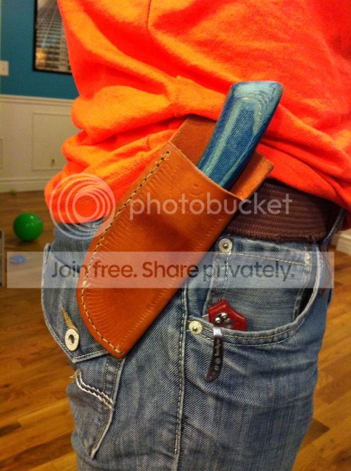

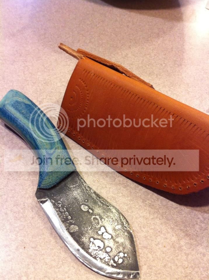

This is a budding interest and I'm trying to gradually learn various techniques in knife making. Thought I would attach some pictures of the first knife I finished and ask a couple of questions. Dan Koster was a professor of mine about 8 years ago in Arkansas, never knew he was so well-known in this circle until I found his knives online.
My Knife, Nussmuk style, scandi grind but with a secondary finish bevel, 1095 blue hardened spring steel, blue canvas handmade Micarta handles
Hope these pictures work...

Testing the hardness without a proper machine is guess work. Most folks put a file to the edge after the quench, and it should skate across without biting in at all. After the temper, it should almost get a bite, but still not dig in.
Canvas Micarta, and most homemade Mycarta, will be rough surfaced by nature. This is for getting a good grip. Wax or oil would make a handle shinier, but also slipperier....which is contrary to why one would use Micarta/Mycarta.
That is a nice first knife.
You MIGHT be able to get a little bit more shine out of your handle material where the fibers aren't getting in the way with a plastic polish. I've used a polish made by Flitz with success.

No pins on this one - That's because I didn't think to drill my holes before the HT. Tried to drill them in after the fact and barely scratched the surface before the bit just spun. I think I could have spot annealed the pin holes, but I just JB Welded the scales on. I consider it a lesson learned and I'm glad for it!
Good attitude!
Be careful though - when one of those scales comes off, I hope your fingers don't end up on the cutting edge!
