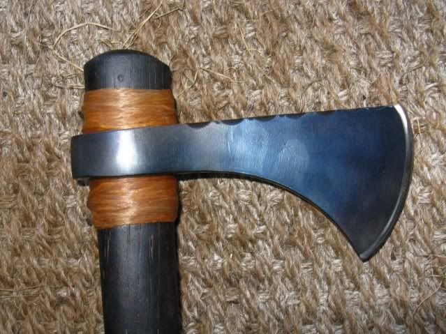

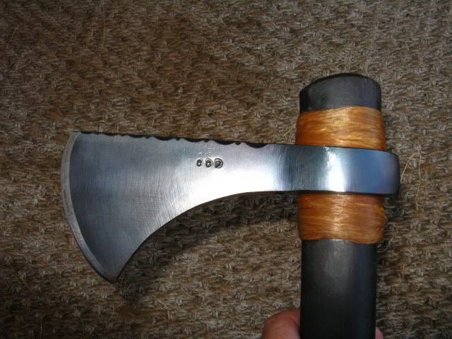

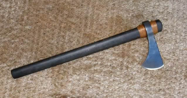

Full View
Right Side
Left Side with Maker's Mark

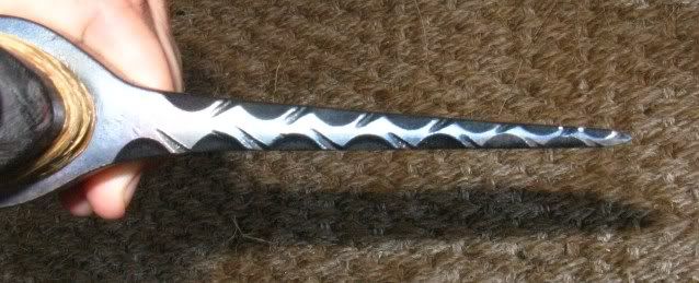

I picked a simple design but I wanted it to have just a bit of personality so I asked for some file work to dress it up.
File Work

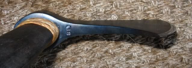

Since the main purpose was for wood shaping for bows and large crafts I needed it to take large and predictable chunks out of whatever I was working on. This is something I find hard to do with the cold steel hawks when working with Ironwood for bow staves. The reason is that CS hawks have very little or no taper from one third past the haft to where the edge starts. The Coal Creek Forge hawk has a very smooth taper from haft to edge bevel and this helps to keep the penetration even when shaping woods that want to split. There is another benefit to this smooth taper that I only realized today while comparing the two directly. The Coal Creek hawk doesn't bind in the wood when splitting. It has a little more mass and splits more efficiently but it also doesn't bind up on partial splits like my non tapered Cold Steel frontier hawk.
Beard Side View Showing Taper

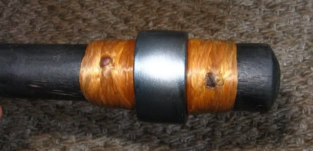

I usually wrap my CS hawks with a little paracord to act as an over strike protector. My new Coal Creek hawk came with a nice wrap of artificial sinew. The wrap was so tight and finished so well that I couldn't even get my thumb nail ti catch on the individual strands. That might not sound like a big deal but I work with art-sinew on many of my crafts and can say that the patience to keep tension that tight on a wrap that long (very long thick wrap) should definitely be noted in a review.
Artificial Sinew Wrap- over strike protector
