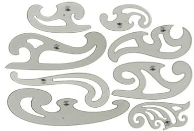

Get a set of french curve templates for drafting, Staples and other stationary / art supply stores have them.
Do your drawings and design, THEN buy your material to suit the drawing - nnot the other way around.
