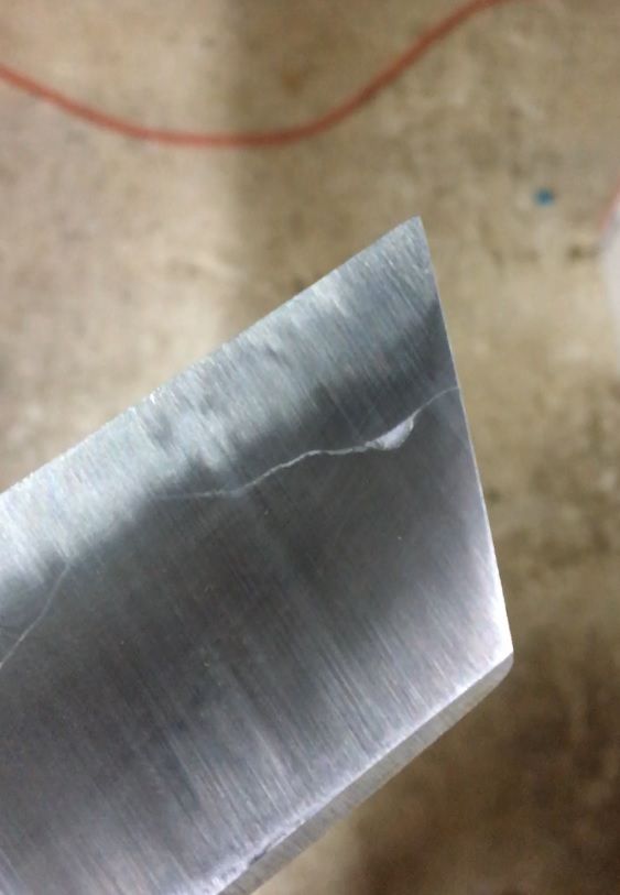

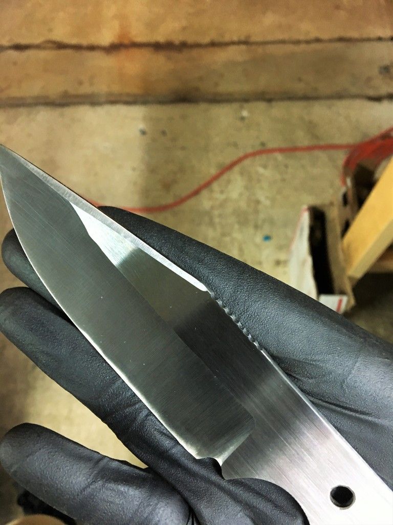

Blade is my attempt at a San Mai pocket cleaver. 1095 core with 15N20 cladding. My first attempt at forge welding. Simply forge welded it all together (maybe) by hand using thin layers of each resulting in just under a .187 "billet" of sorts. Then cut and ground the blade in a stock removal style from there instead of hammering it to shape in hopes I wouldn't screw up the core location. Questions are:
1: While attempting to drill pin holes, I could NOT get one of the holes to go through. I burned up two drill bits trying. It would go through the outer 15N20 layer with no issue but stop, squeal and smoke when it hit, what I'm guessing, was the 1095 core. Tried grinding from both sides, no dice. Switched drilling location slightly, same issue. (You can kind of see in the pictures below but forgot to get a spot specific photo. Sorry, Fail.) The other pin hole had some slight resistance but punched through with some minor muscle. This spot just wouldn't give. Did I somehow manage to partially harden the center? Blade hasn't been quenched, just forge welded and normalized. I don't have vermiculite or anything to really do much of an anneal. The bits I have are allegedly for metal and have never given me an issue drilling previous knives and other metals.
2: Once ground enough to show the differing layers of steel, a visible layering/line was evident. Is this normal or delamination? I ran my fingernail across it and it didn't catch but it was a clearly visible line. (No, sorry again... I took a short video on my phone but no picture. Maybe tomorrow after work I can update)

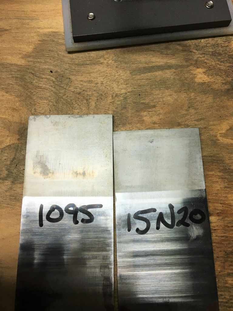

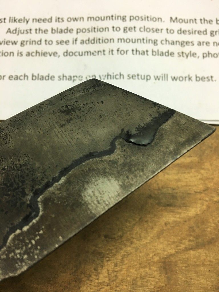

3: In my haste to see if I had succeeded in creating the epic san mai goodness I love, I etched the blade (1 to 1 FC and distilled water... very concentrated) hoping the 1095 would turn a nice black and the 15N20 would stay silver. I'm not expecting the extreme difference like in a stainless San Mai but, just wanted to see "how I did" if you will. Instead of the 15N20 staying silver, it etched a dark grey. The exact same color as the 1095 turned if not darker. Now, I'm assuming (hoping) this is due to the blade not being heat treated yet?? Should I expect this to be the end result color wise? Dilute the etch? Longer? (Yes... I do have a picture of this part)
