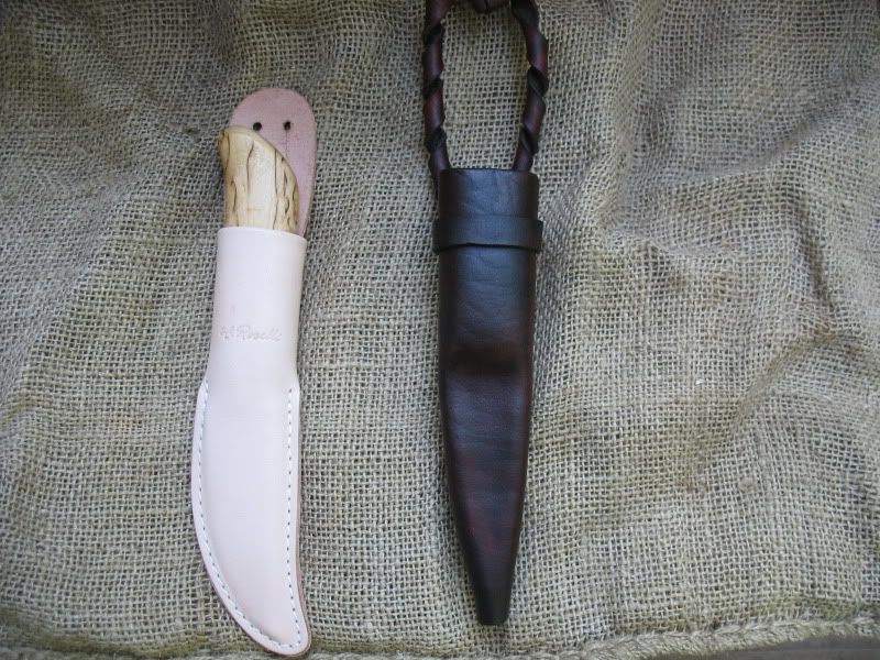

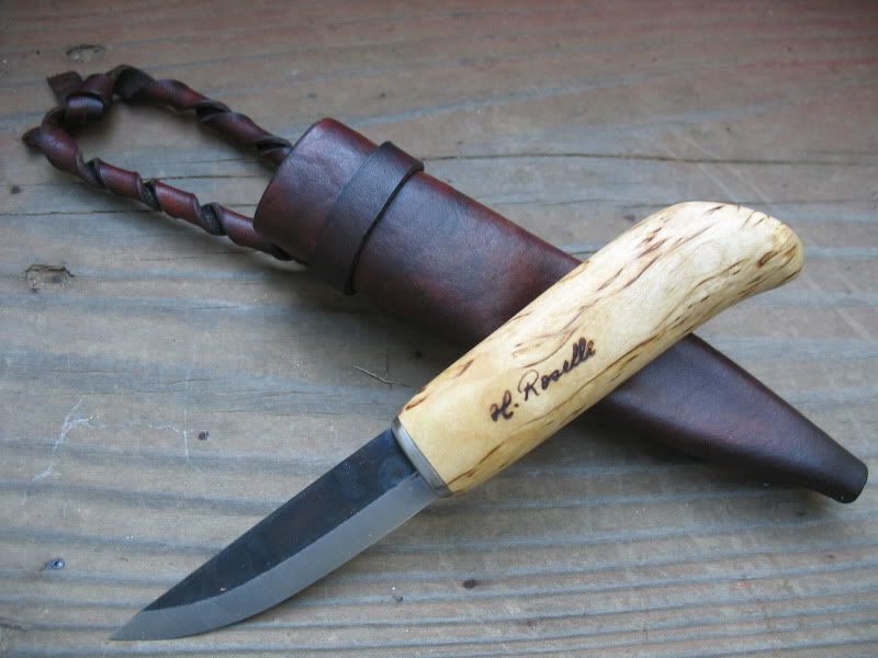

hey folks.. here's some pics of the first scandi style sheath, i have made.. i have been wanting to try one for a long time.. it was made for a Roselli Carpenter knife..
i was anticipating making a new sheath for this knife, when i got it, the sheath it came with didn't do it for me..i did quite a bit of research on different style/looking sheaths and decided to with a more basic design.. i got the knife on monday of last week and finished this up on thursday..
i used 10-11 oz. veg. tanned leather, wet formed and then dyed with Fiebings medium brown dye.. i finished it off with some bees wax.. i used some thinner veg tanned leather i had for the belt loop..i didn't put a liner in this one, i think i'll try that next time..

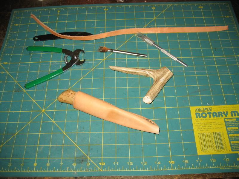

i took a few work in progress pics..
getting ready to dye it, after being wet formed..
and the finished product.. i am pretty happy with it.. it's simple..
the back stitching wasn't as hard as i expected..

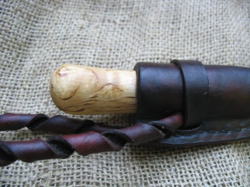

side view of the belt loop..
and my sheath, with the sheath it came with..
