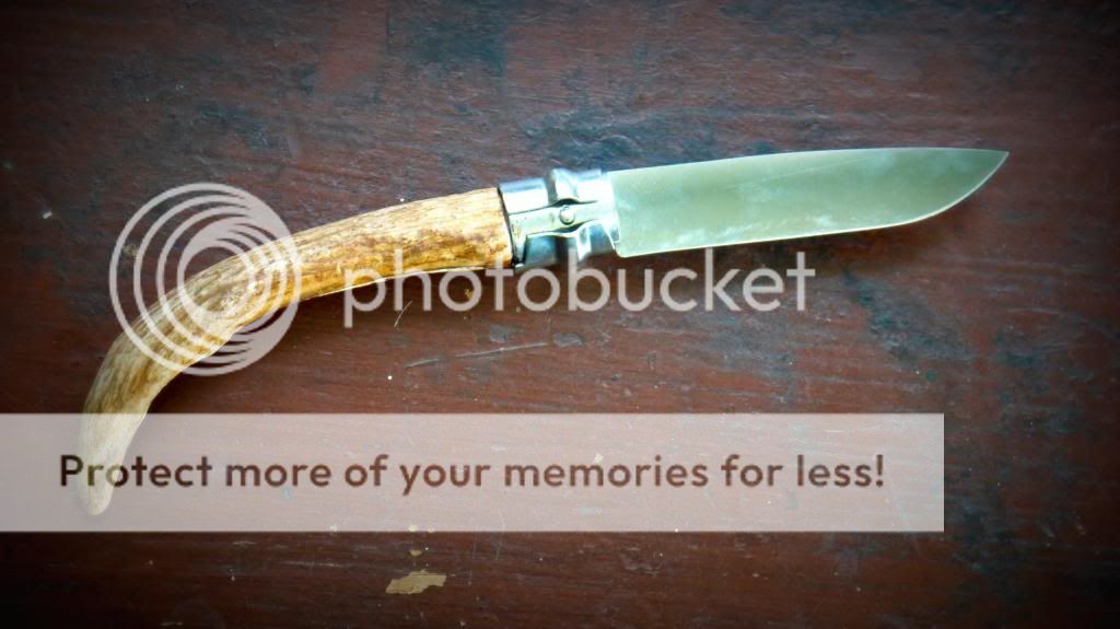

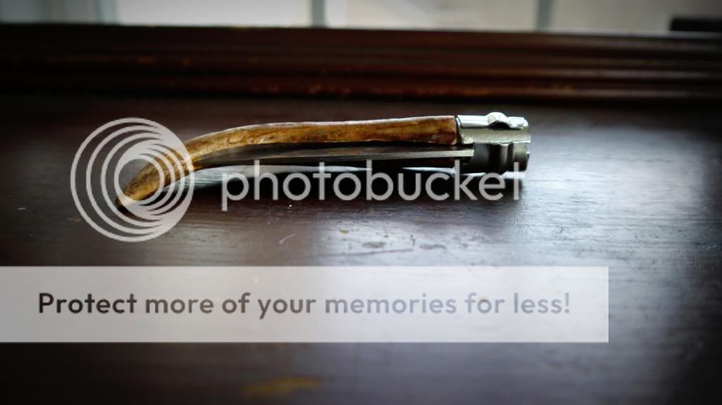

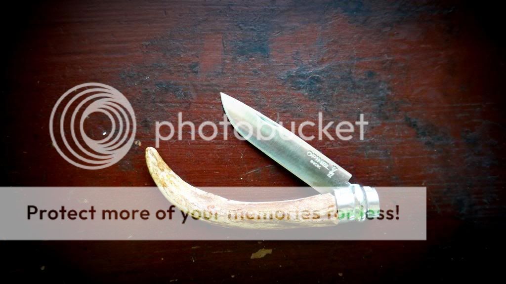

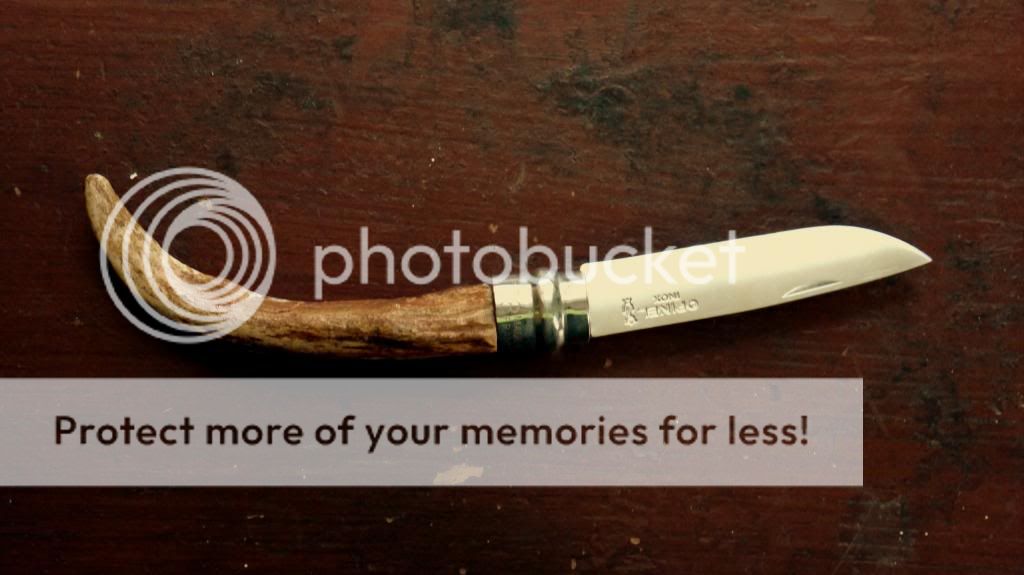

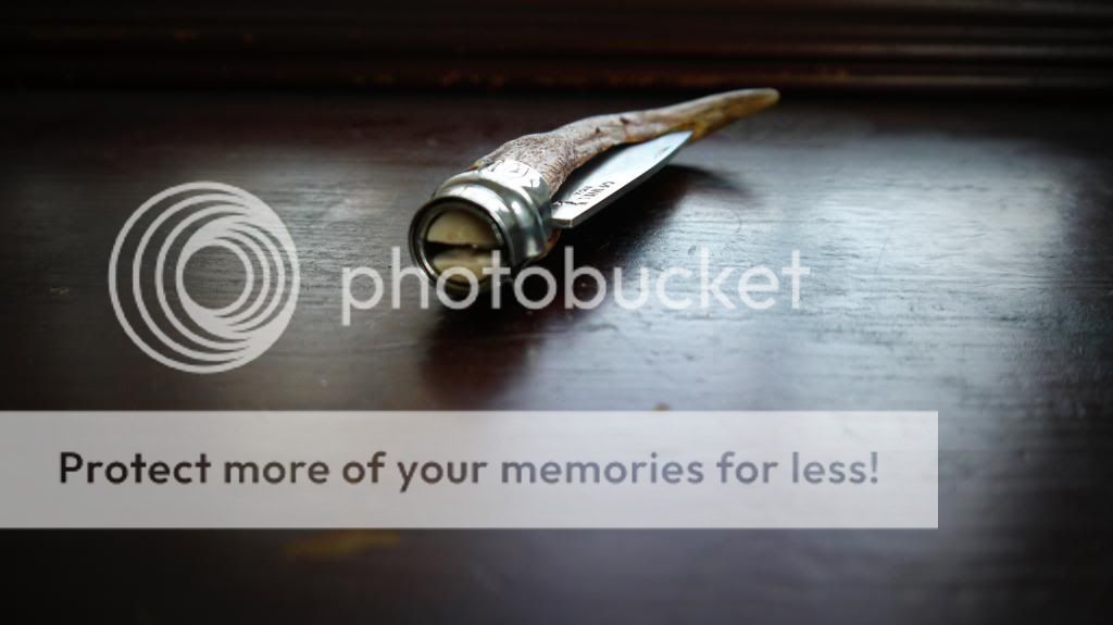

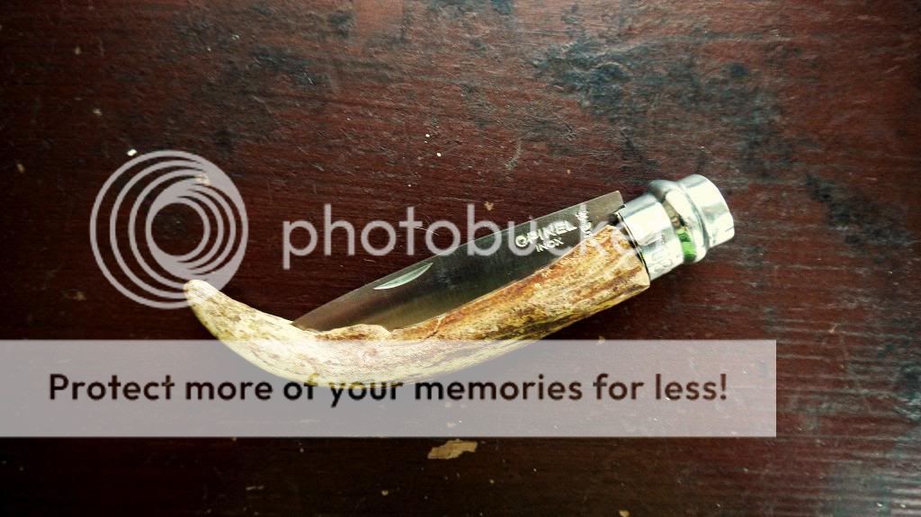

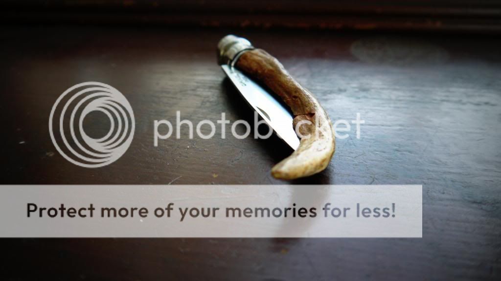

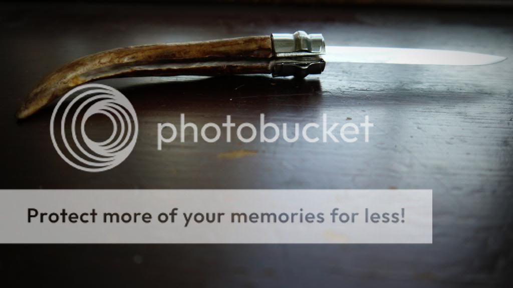

Christmas break is here!!! Since today was only a half-day at school i came home and decided to mod one of my Opinels. I recently acquired stag from a deer that was hit practically on my high school's campus. I've always wanted to do some handle related project on an Opinel and today i actually took that chance. I didn't do the greatest job though. It closes tight and locks up tight, but when the lock ring isn't on the blade has a fair amount of play. Still, it was my first large project. I probably should have asked before hand, but are there any tips you guys have for next time i modify an Opinel? Any tips are very appreciated. This Opinel i had previously drop pointed.
And the pictures:
Thanks for checking out! If anyone else has put stag on an Opinel leave a pic if you want!
HEY!!! That looks great bud...you did a really good job!!!!!!! Much better that I could!!!!! :thumbup:
WHOA!
I'm impressed! you did a great job, love the old rustic look. :thumbup::thumbup::thumb up:
If the lock ring is too loose when it's just resting in a non lock position, you can take it off and just crimp it a bit with a large channel lock pliers opened up wide. Just a little squeeze will snug it up. Just a little, and try it, and if it needs more, just take it off and crimp a tiny bit more. Kind of a trial and error way.
Good job!
Carl.
Thanks, I will try that. That should fix most of it, but you have any advice for possibly too much material taken away where the pin goes through the blade? That seems to be another contributer.

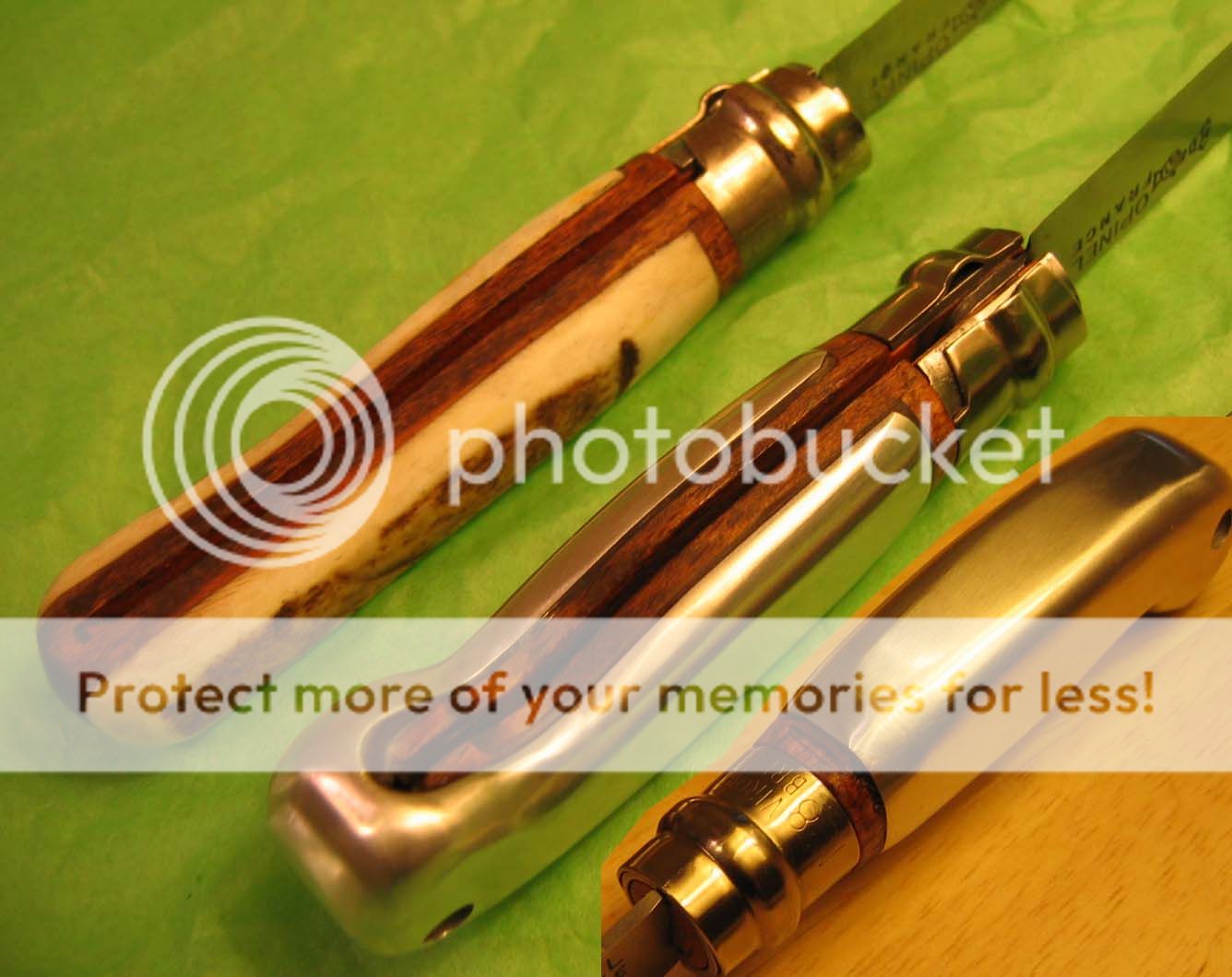

Hi Knifecollector, nice mod, opies are fun to play with. Here's one I did last Christmas with a Moose tyne handle. I used a piece of the original handle, the lock area and about 1 1/2 inches behind the lock area carved down to the diameter of the lock. I drilled out the antler to the right diameter and glued and pinned the wooden piece into the bone. I cut the slot after incerting the wooden piece using the slot in the wood as a guide to keep the slot thin and straight.

As to the pin hole you might try filling the hole with an epoxy putty like JB Weld for wood,letting it cure then drilling it to the pin diameter.

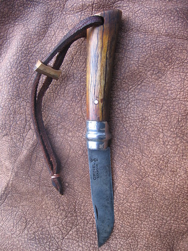

Lacking any antler,I tried my hand at stag jigging with a dremel on the #6 below.
