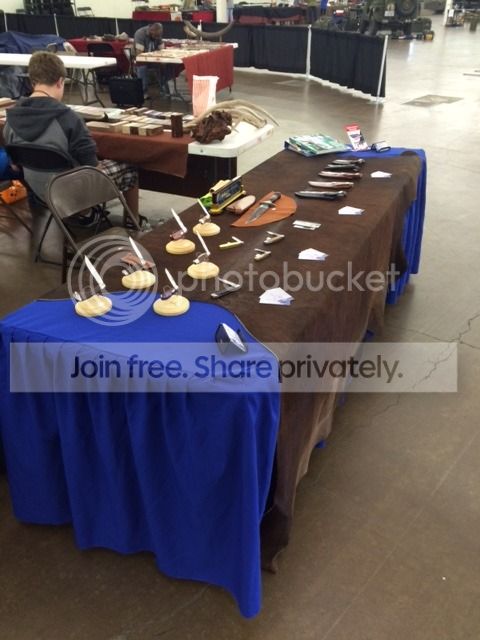

In a few weeks I will have a table at my very first show. Just a local gun/hunting show but I'm still excited. But I'm kinda concerned having many extremely sharp objects on the table, how do you guys deal with this. Also I'm not going to have a bizzilion knives to fill an entire 8 foot table so I'm looking for ideas to dress up the table to make it look good and be educational and maybe show kinda what I do. I don't want a table with just 10 or so knives in the middle lol. Also planing on doing a free drawing for a Damascus striker and a $2 raffle for a knife. Thanks guys and any other tips you have to make this a smooth experance I would be greatly thankful for.
I dont want to get myself in trouble again, but here's what i would have done, had i went to a show and had a table before. Personally I think there are some things you can add that would show the process. I find that people who see my knives or find out i make knives ask where i get my blades. It seems that the idea of me actually forging and grinding them never occurred to them. Take a bar of steel, a forged profile or a profiled blade, a beveled blade, maybe a couple blocks of different handle materials. These things show some of the process and the work involved, and that each knife really is hand made. People will pick stuff up if its just sitting there, so if you plan to have them accessible, make sure you put a sign that says something to the effect of "please use caution, knives are extremely sharp". I feel that gun shows are mostly adults, and if an adult picks up a knife or handles it in a way that they manage to cut themselves, they are probably dumb enough the sign wont help, but at least its there. A photo album of previous work or shop action shots can be an attention grabber as well. Make sure you take a soft cloth or towel because you will be wiping finger prints and smudges all day. The knife raffle could be a good idea but depending on the crowd may not be a money maker so keep that in mind when deciding which knife to raffle, as far as your expenses into it.

Take a few raw materials to show the process as others have suggested. Leave knives out and encourage folks to pick them up. The first step to buying one is picking it up. I have a nice walnut sign that I prop up with antlers. I put each knife with the sheath for it. Get a table cloth to cover the table. Talk to everybody you can. People want to know the maker and a conversation can lead to more. There are usually a ton of production knives at shows so I would have something that lets people know that yours are handmade. Don't get too fancy that it takes away from your work. I like things symmetrical and in order. My biggest problem is that 90 percent of the people that pick up a knife put it back down facing the wrong way or upside down. I spend a lot of time reorganizing my table but that's just a little of my OCD I guess! Good luck!
