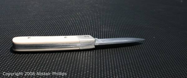

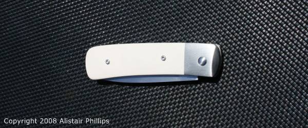

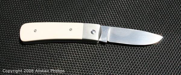

It's finished!! Words can't describe how happy I am with the way this one turned out. Despite all its flaws (and there are quite a few) I am really pleased with the end product. I also figured out what I can do with the scales that I had to replace. I have been interested in trying some scrimshaw so I will be able to use them to practice on.
A few people have asked how I designed it so I will try to put together a tutorial for my website http://knives.mutantdiscovery.com. I'll post back in this thread once it is up there. If you are attending the Canberra Knife Show you'll be able to check it out in person.
First the vitals and then onto the pictures.
Blade and Spring steel: O1
Liners and bolsters: Nickel Silver
Scales: Ivory paper micarta
Length Open: 135mm
Closed:80mm
Blade: 55mm
Weight: 75gms

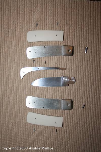

First picture is of all the bits and pieces cleaned up for final assembly.
Wow......that came together so nice. I can hardly wait to start one of my own. I hope you don't mind if my first is very similar to yours? I've read multiple books on folders and I have to say, with watching your's come together step by step, I understand it so much better now. Thank you and look forward to seeing more from you!
