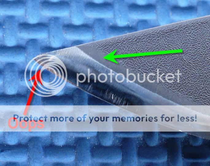

So I made a stab (haha) at reprofiling my first Busses. First pic is two Muddy Meanies and an AD. Top Meanie is stock, bottom Meanie and AD are both re-done. Second is a closeup of the AD.
Lessons learned? Well, I can do a MUCH better job with an EdgePro than I can by holding a diamond benchstone against one of my Sharpmaker stones. (The latter technique is why the coating on the AD is messed up for 1/4" past the bevel.) I know they ain't pretty, but I'll get them cleaned up eventually.
Anyone else got any semi-embarassing reprofiling pics? :)

I've recently done what you're going through. Nice job, but, it looks like you might not have completed the job on the Meaner. The tips are a bitch. I just had to "re-reprofile" my DWMS because of that darned tip!
Can you please take another photo of the tip of the reprofiled Meaner so I can tell for sure? On the close up of the Meaner, the tip is cut off, so I can't tell.
- Thanks
P.S. It looks like you may have a "double bevel" on the tip of that Meaner.

Troop: Here's your photo. What you saw in the first photo was just where I didn't polish the tip enough (green arrow), but when you zoom WAY in, you can see that I did miss getting the very very tip. :o

Yup...just as I suspected! :) The same thing happened to me. It probably won't affect the cutting ability to any noticeable extent, but, try this just for fun. Slice a piece of computer printer paper, and see if it "hangs up" when you get to the "bad spot". (start slicing from the choil end of the blade). If it hangs up, then, to me, it's a "noticeable effect". If it doesn't, you are good to go. When I first did my DWMS, it hung up where I didn't do it right, so I had to re-do it.
:thumbup: Great job, just do yourself a favor and don't get frustrated and say "screw it". Don't worry about those little scratches...but, I would re-profile that tip, though...that would irk me to no end.
