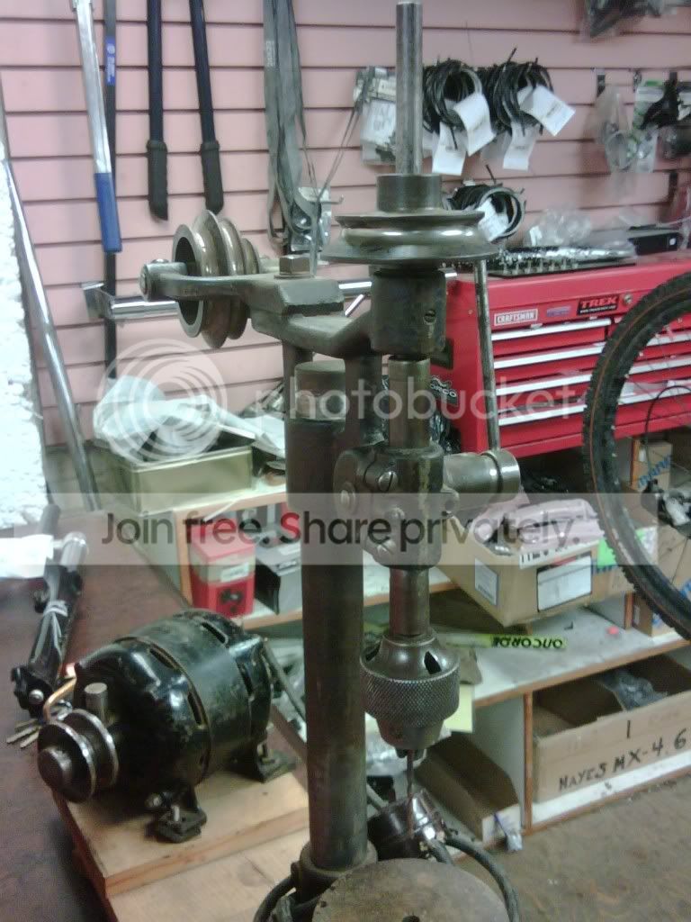

Have you seen my drill press? Its older then most of the members here:eek: and I am not kidding:D
I am still trying to source some belts for it locally to get it running, may just end up making some out of leather though
That's actually a pretty cool lookin drill press. You know they make belts that have links in them so you can adjust the length, but I dunno if thats the issue. Anyways, if you get it "spinnin" you can mount the wheel in the chuck and you will be a buffin before you know it.
I don't know where you buy your tools, but craigslist usually has a pretty healthy selection of bench top presses, etc for cheap.
That one was free so I can't complain about it, you know the saying there is good stuff, bad stuff and free stuff:D The motor works so that is a plus, just had to put a plug on the cord. I have seen the link belts and thought about it, its just that the belt between the drive/speed pulleys need to twist 90* so I don't know if they will work for that

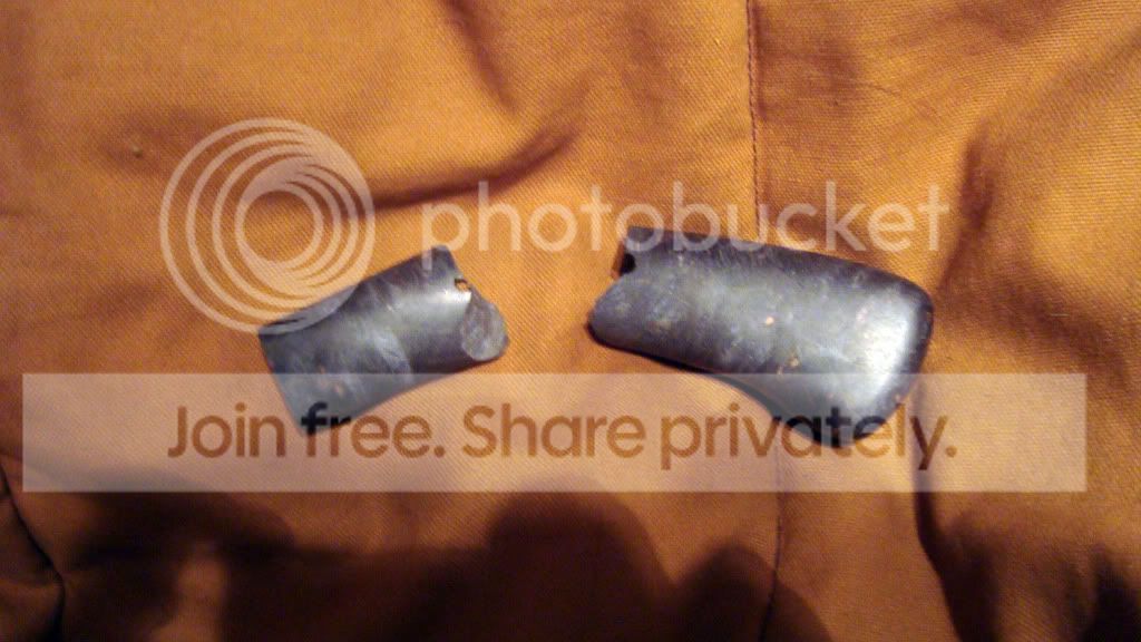

Major disappointment, I was burnishing the handle like Fred suggested and it was looking great, even had a bit of a reflection going, so I decides to call it a night and slide everything back together and take an other picture and this happened.

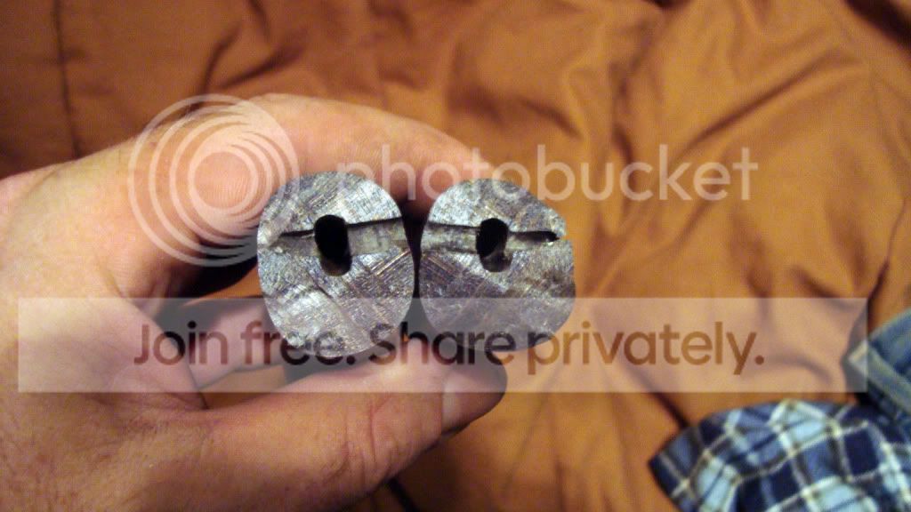

No pressure applied when it happened and it is a smooth break. The pin hole was drilled while it was still a complete block other then the tang hole and the backside was fully supported when it was being drilled with the tang inserted. I figure it was just a fault line in the block and I just happened to drill at just the wrong place. the two pieces fit back together with barely a visible seam, and there is enough material that I could drill a couple of 2mm holes and set some pins in and possibly epoxy it back together, but I don't think I could get things lined up from one piece to the other well enough for the invisible seam. Would just gluing it back together with out the pins be strong enough or am I scrapping this one. If scrapping it is the only option this knife is on hold for 4 months , because by the time I can afford another block I will have had my elbow surgery and be laid up for a few months after that.
Guess its better that it broke now then when I had everything glued up and in use
I have been looking at this and looking at it and I realize that it doesn't matter how much time and money I had into it, trying to glue it back together and salvage it is a bad idea. I sent Woodstabilizer a message explaining what happened, maybe I will get lucky and they will send me a new piece. I bothers me that it would snap like that without some sort of heavy use. I hadn't even glued it up, used it or dropped it. Is all stabilized wood this delicate before it is pinned up and glued?
Aw man, I'm sorry about your handle block there. Just when you were getting it looking nice, too. Stabilized (or any) wood should not be that delicate; it sounds like there was hardly any side pressure on it when it broke. A head-scratcher for sure. I warn you, you will experience many major setbacks like this on knives if you continue to make them. Don't ask me how I know.
That is to bad. Tight burl can do some strange things. I have had tight figured stabilized redwood burl, literally "explode" after the knife was completely finished, epoxied and the whole nine yards. I was standing there watching the knife when the last inch and a half of the handle snapped with an audible "crack" There is a lot of stress in fancy woods, thats why cabinet makers go for the straight grained stuff.
I figure Mark at Burlsource can tell us some horror stories.
The handle was starting to look good by the way.:thumbup:
Fred
Well I am trying to salvage the handle with some advice from some other makers. I have crazy glued it back together and am starting the search for a non expanding high strength epoxy. The wood was just too nice to toss, and its not like I was going to sell the knife, it was going to be a usable personal show piece to sit along side my first knife. Sort of like a makers time line.
The really good news is that Wood Stabilizer is sending me another piece so if I can't salvage the current handle I have a new block to start with. and I will just use the broken one as spacers and possible inlay pieces in other projects. It will be about a week before I am ready to put it all together now so I will have the new piece of wood by then
