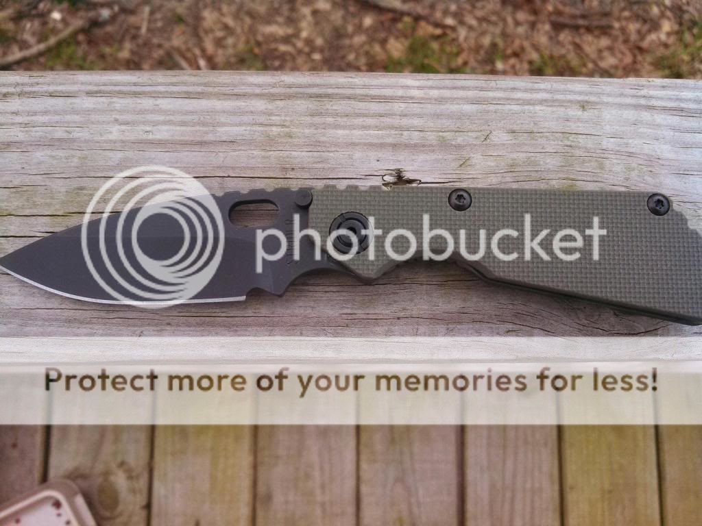

I love the z wear that steel is a beast, Been thrashing on it for last half hour lol...
Allen, can you make any comparisons to any other steels? Better or worse? http://www.simplytoolsteel.com/Z-Wear-PM-tool-steel-data-sheet.html
Like Cruwear it seems to handle higher rc's than 3V. It really comes into it's own around rc 62. 3V does rc 58 best IMO, and gains little wear by going up to rc 60, while losing lots of toughness.
Zwear and cruwear just seem to do fine and have some advantages there. My Spyderco Cruwear mule at rc 62.5 is tough, and more wear resistant than S30V. * Note: Opinion, no real testing was done like Jim Ankerson's, or Hardhearts. I also like to run it a bit coarse ( no higher than #400 grit), around 35-40 degrees inclusive. It ( cruwear/vascowear) can do lower angles fairly easy. I really like the bite it develops

I was sharpening up the new Z-wear Strider yesterday and I couldn't help but notice how easy it sharpens. I can really tell the difference between ingot and powder tool steels on the sharpening stones. It has a nice bite like Cruwear, but sharpens about like my Buck 110 CPM 154 ( I think Bos had those running around rc 60-61). It is cleaner with less burring as expected than the ingot steel.
Overall I'm very pleased by this SNG. The QC is excellent. No problems noted. I have a 3V SMF from the batch a year-year and a half ago (?) and must admit I prefer this steel to the 3V SMF. That's just on sharpening, edge taking and feel of the steels, as well as light cutting at extremely high ( for me, I typically run a steel with carbides around 400 grit after learning it by taking it up to 8-12K, and around 40 to 25 degrees inclusive trying to find the best working combo for my uses) sharpness. When I say high sharpness on a tough, wear resistant large carbide steel it's not the same high sharpness I mean when talking White/blue,Super Blue, W2, O-1, 52100,12c, 13C etc.
It sharpens so much easier than the ingot cruwear that it's going to take some proof to convince me that it has the wear resistance as the ingot cruwear or vascowear I'm used to. The Ingot Cruwear at rc 62 cuts longer for me at 35 degrees inclusive than the higher vanadium S30V. It's very much tougher, almost near the 3V level.
It is not as wear resistant as real, bonified rc 62 and up CPM M4. It will match the best fully hard M2 in wear and toughness though.

Bladechick 777, thanks for answering but I would bet money these SNG's aren't run at rc 63 just by their feel and sound on the stones.
Joe
They aren't run at 63 Mastiff. Josh at SKI said that they are 60-61 rc, so I'd feel safe saying they are right at 60. It's funny that you said it's easy to sharpen, because I thought the same using a DMT coarse stone. My friend Brad Southard reground his Z-wear SnG and told me that it was extremely hard to grind. Seems like we are contradicting each other, but I won't pretend to think that sharpening can be equated with regrinding a primary bevel.
It's very similar to 3v in composition, with a little more carbon and a little less V. It's said that it's the German version of 3v, but until we see some hard data I'm just chocking that up to marketing and word of mouth. I can however say that it is extremely tough and extremely durable.
I cut an industrial steel staple with mine (more like pressed the staple in half with the edge of my SnG) and it suffered no edge damage or deformation whatsoever. I took my CPM-154 SnG and did the same and it showed significant rolling before I even got close to cutting the staple in two. Take that for what it's worth, but it is at least some real data.
