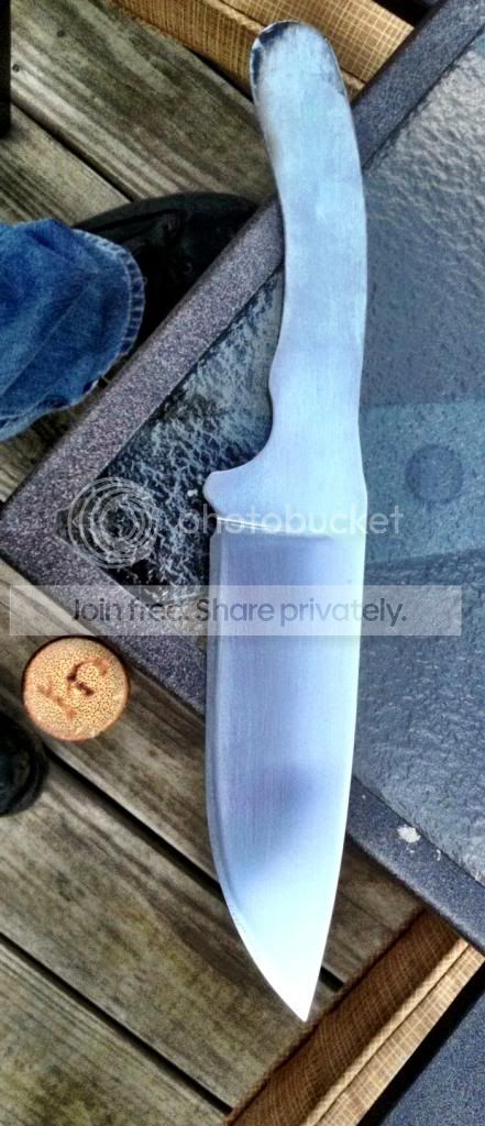

First successful blade ready for heat treat.
Jul 19, 2012
96
This is a chisel ground, .125 chunk of O1 done $50 knife shop style. I feel accomplished making a blade with files, but I'm ordering a 2x72 grizzly next week!! Any tips or tricks for heat treating this stuff? I plan on using my homemade charcoal forge to do the heating.
I would suggest drilling your pin holes and whatnot prior to heat treat. As far as heat treat, I can't help you there, I'm learning as well.
The charcoal forge will make it interesting for 01. Heat the blade to 1475 1500 soak for 5 or 6 minutes, try to maintain this temp; quench in medium speed oil heated to 125 to 150. Temper at 400fh for a hrc of 60 or 61; 450 for 59 to 60. Temper twice for two hours each time.
It will help to stabilize the blade if you can soak a bit at 1200 to 1250, 01 likes stress relief. Follow stress relief by normalizing the blade. Normalizing 01 is done at 1600 and under in order to reduce grain structure.
As I said doing this heat treat is a challenge using a charcoal forge, but these figures give you something to shoot for.
Good luck, Fred
Have you put an edge on the blade yet? If you have, you need to file/grind it back to to where the edge is roughly half the thickness of a dime. Otherwise you risk overheating the edge and damaging it or warping the blade.
I put the edge on on to get rid of a knick i put in it doing some Espada y Daga stuff with a friends Ginunting. I took a little too much off the handle, too. I took the edge back down immediately.
I had planned on letting it get good and hot for about 5 minutes tomorrow and letting it cool with the coals, then doing the heat treat Saturday. Im guessing I have to do the soak by the color. How bright/dull of a red should I soak at? I play around with steel when I blacksmith, so I can keep it at a temperature pretty easy. I just need to know the right one.

You have O1 steel and a coal forge... forget about soaking unless you want to rig up a muffle pipe which complicates things even more. That said, O1 needs to be soaked for full potential. So you have to get creative and hope you get lucky.
You don't want to over heat and get grain growth. My suggestion is to make the best with what you have.
Do this in a darkened shop or at night. Keep the blade edge up and moving(don't let it sit in the fire)
- Heat to bright red, let air cool to black
- Heat to red(a bit past nonmagnetic... maybe a 7-10 count), quench in warm oil(130F)
- Heat to dull red(just as the blade goes nonmagnetic), quench in warm oil(130F)
- Heat to where you begin to see slight red colour(twice) and let air cool to room temperature
Now, you can drill your holes for your handle... the blade will be soft and set up for a decent HT. When it is time for final HT...
- Slowly heat the blade(edge up) to dull red(just at nonmagnetic). Take it out of the fire and watch the colour even out. Put it back into the fire.
- Heat to red(past nonmagnetic, 7-10 count) and quench in warm oil(130F)
- Throw it in a preheated oven at 400F for 2hrs.... twice. You can water quench between cycles.
In my opinion, this is making lemonade out of lemons. Now... instead of trying to find out why I do it this way, go pick up some 1084 steel to make your next knife.:p

Thanks for the info guys!! I'm toying with sending this one for a pro heat treat, just so I don't ruin the first knife. I have some .25 inch thick 1084 that I tried to file, but its just too damn thick for that!! I will finish it out on the grinder.
