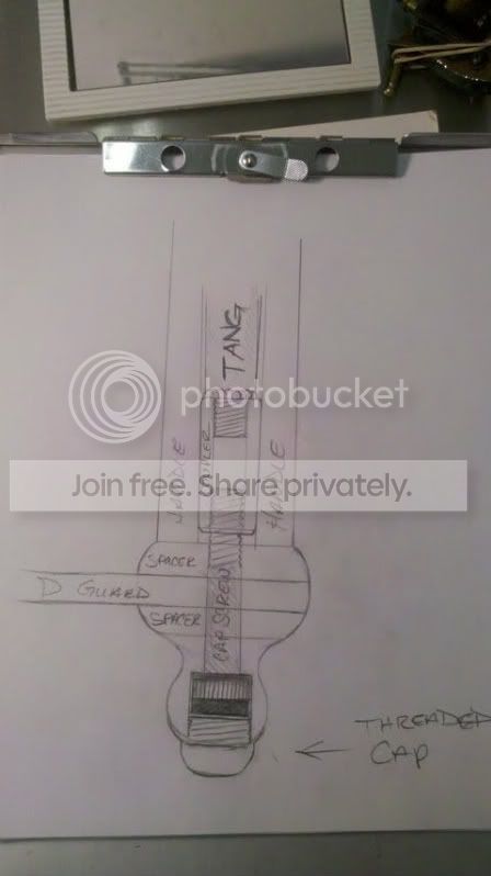

Ok. Thought about how i want to mount this thing and this is what i came up with.
Ok i know this might not be the best way, but i want the tang bolt hidden. If you guys have better suggestions, please feel free to tell me....I am also going to design a scabbard for this...maybe wrapped in a jolly roger :P

My advice is to ditch the screw in the pommel and hot-peen the end of the tang.
Make the tang a square section and have a corresponding square hole through in the pommel so that some of the tang protrudes through. When you get everything together, drive the pommel into position, heat the part of the tang that comes through and peen it over. you can shape what's left into whatever type of treatment you want.
This is a die-hard traditional method and will hold up better than a screw if you ever get to using it.

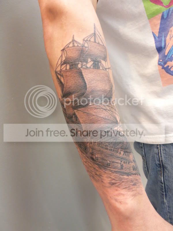

Do you guys think it would make it look "tacky" if i did an airbrushed scabbard? I plan on doing the steel cap on both ends, but thought it might be cool to airbrush a pirate ship on the scabbard....Probably about 6-10 coats of clear coat and a ton of polishing. I will post a pic of a tattoo that i did,Not to be a cheater or anything.... kinda thinking something like this
Sorry that tattoo is a big WIP also lol, This is only the first session in the ship, have one more to go, but you should get the idea...
