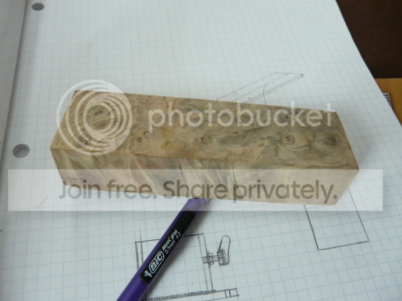

Ok....So after some thought, i have narrowed it down to 2 pieces of wood for the handle. It will be either this piece of stabilized box elder burl, or it will be a nice piece of figured walnut i have, let me know what ya guys think!
