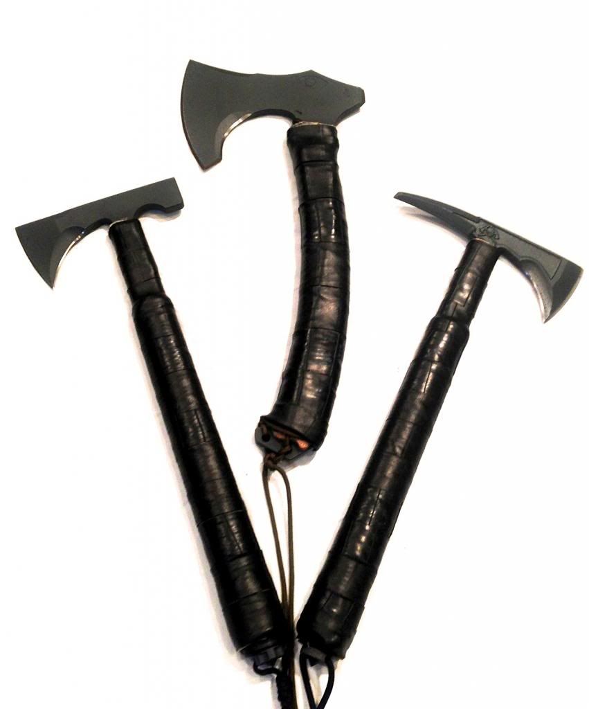

i used the loggerhead a lot espicially on camping trips with my BK16 knife its more utilitarian than the 2. The shrike is mostly work related as a breaching tool mainly very effective and light compared to commercial breaching tools we had on our toolbox. The berserker will my wife give it to as a bday present its heavy but its very effective so far on processing wood cutting bricks on my garden but very expensive for day to day use and what not.
Why the electrical tape on the handles?
Actually i wrapped it in 550 cords then wrapped it again with camo tape then finally the inner tube (ranger bands) applied for grip enhancement.
