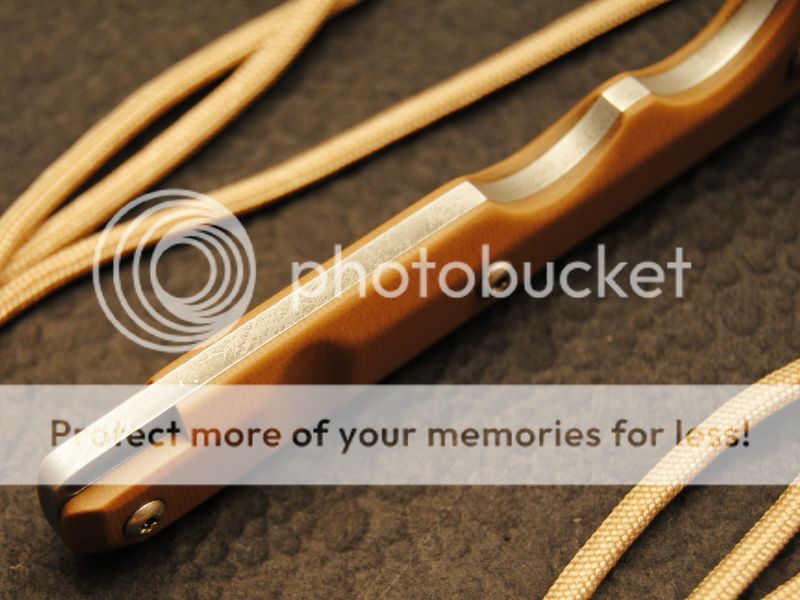

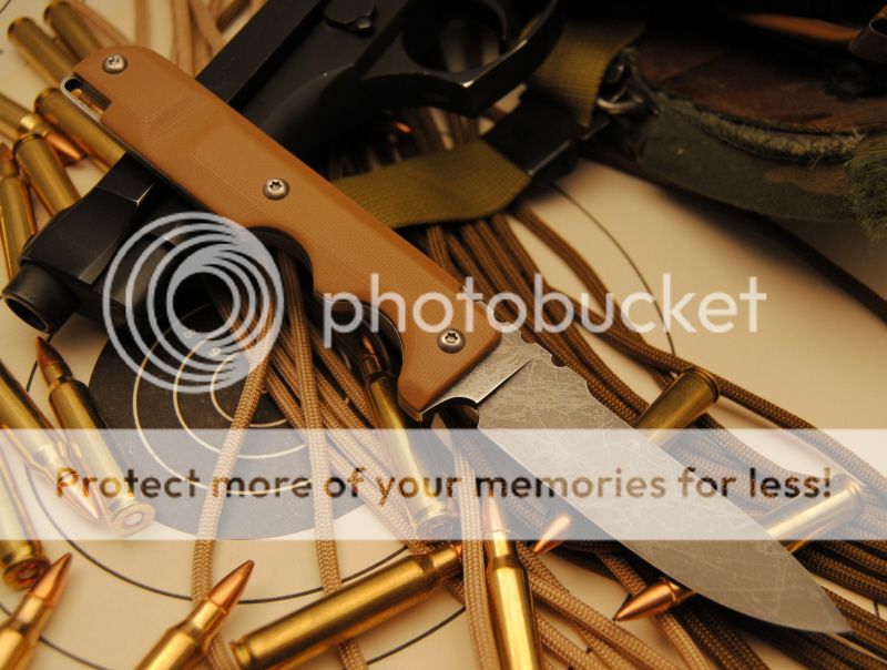

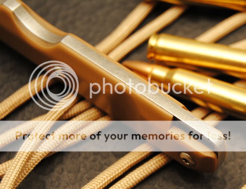

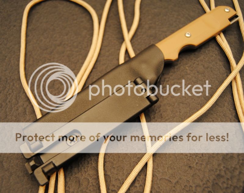

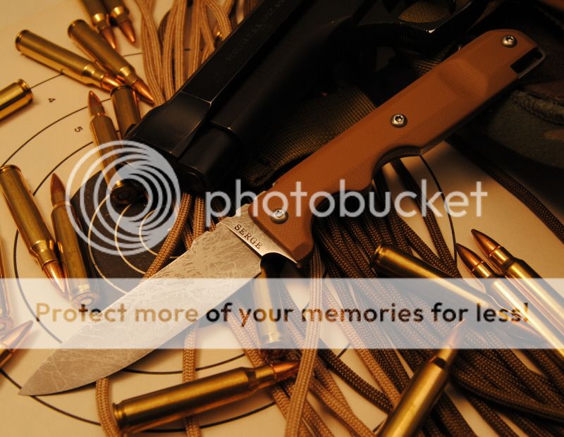

Hi all, just finished up my first tactical in stainless. This one is the first of this design, more will follow. I really like how this one turned out, balance is good due to the area under the scales cut out to reduce handle weight. Blade finish is pattern etched and covers the entire blade, including the handle. Hope you guys like it
No. 229 Tactical SOLD
Steel: 154CM
Heat Treat: Peters HT, Rc 59-61
Steel Thickness: 1/8"
Grind: Full Flat
Overall Length: 8"
Blade Length: 3 1/4"
Handle: Brown G-10
Sheath: Kydex w/ Molle Lok
