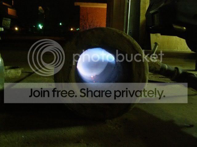

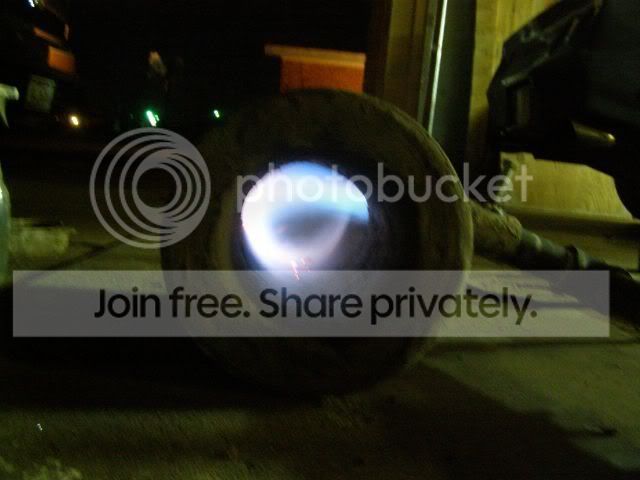

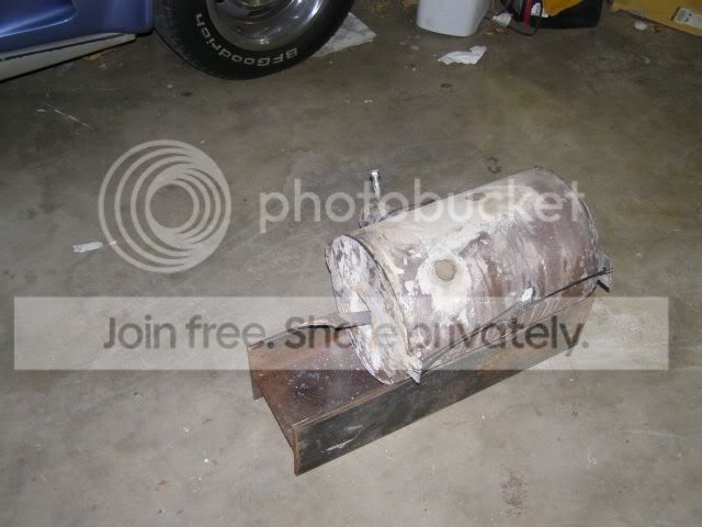

Here's the first time I've fired my forge. I'm going to downsize my burner tube to a 1" from 1.5 after some advice from AC Richards I just haven't done it yet. . I also got rid of the leaf blower and ended up getting a shaded pole blower. I have some endcaps I'm insulating right now to close off the ends and leave a small opening in one end. As always advice or comments welcome. Thanks
I started with a 10" diameter pipe and 16" long I think and put in 2" of Kawool with a 1/4" of satanite on top of that and I'm going to put ITC on top of that.
The way I am doing my end pieces I will lose 2" more inches on each end. Now for the short answer it is about 5.5" in diameter by 12" long.
Not a clue because I've never been around a forge. I have a batch of knives I"m finishing up and when I do I'll order a thermocouple. If I order it now I"ll play with the forge and won't get nuttin done. I did cap off the ends an stuck a file in it one day for fun and it melted in two.

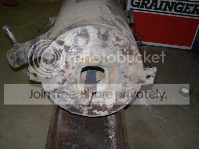

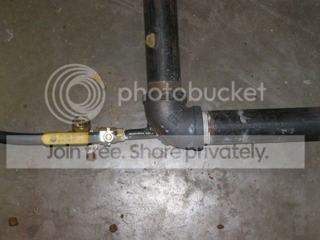

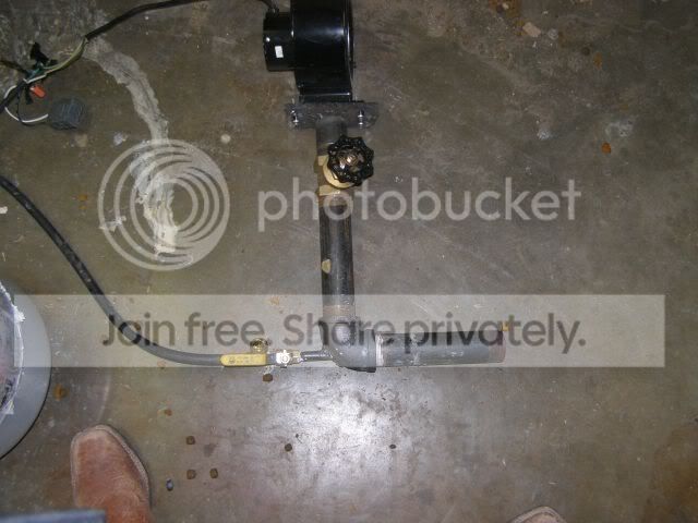

I used Indian George's tutorial to make the burner. I used a 1/4" nipple that was placed in the 1.5" elbow. I drilled a hole in the elbow to fit it in then welded it back up. From there I put a cap on the 1/4" with a 3/32" hole drill in it. Mine is a forced air burner and now has caps on both ends to hold the heat in. If I get time tonight I'll take pictures of my burner since I cannot explain it very well.
I'm curious? When you say "caps on both ends" ,exactly what are you referring to? A photo would help.
Stacy

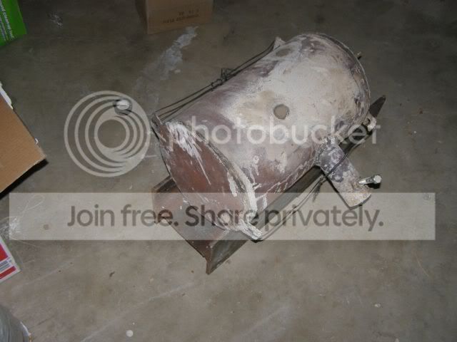

I meant I caped off the ends of the forge. I closed them off with pieces of metal I cut from plate and insulated with 2" inswool, satanite, and ITC. I could have used fire bricks, but I had enough insulation and clay left over I made pieces that fit over each end instead of spending more money. With them wired the way they are I can easily pull the ends off to redo the interior or patch it whenever I need to. Whenever I get around a welder again I'll weld a latch of some sort instead of the wire holding them in.
Also are some pics of the blower and burner. I couldn't get the pipes apart to show you the cap on the other end of the 1/4" nipple and 3/32" hole drilled in the end, but you get the idea.
Gotcha.
I was not sure if you were saying you sealed both ends off. With one end closed and one with a window ( like you did) , the forge will operate much more efficiently.

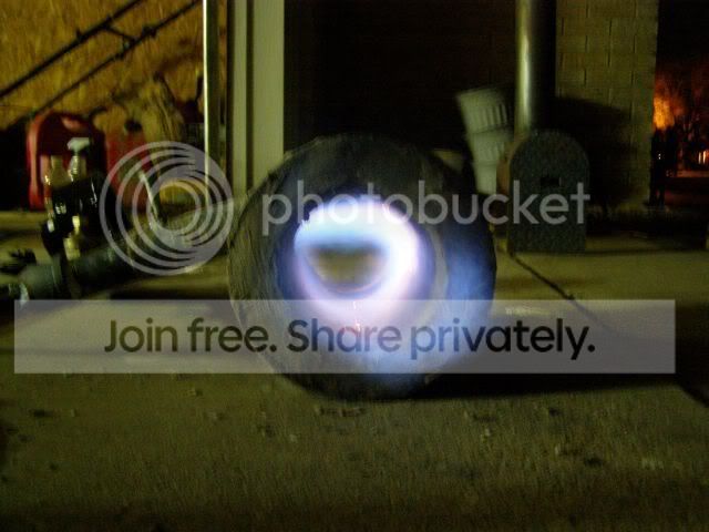

Awesome picture. Shows the "swirl" of the flame going around the forge.
