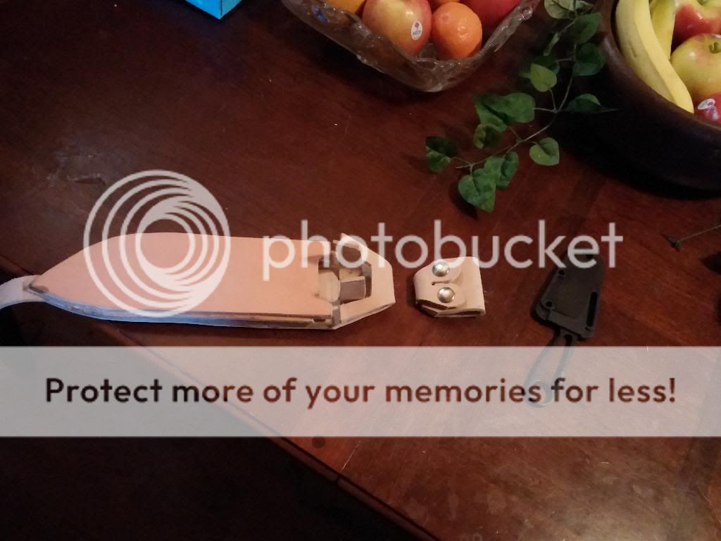

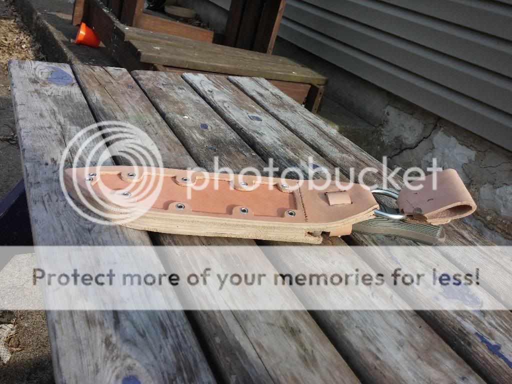

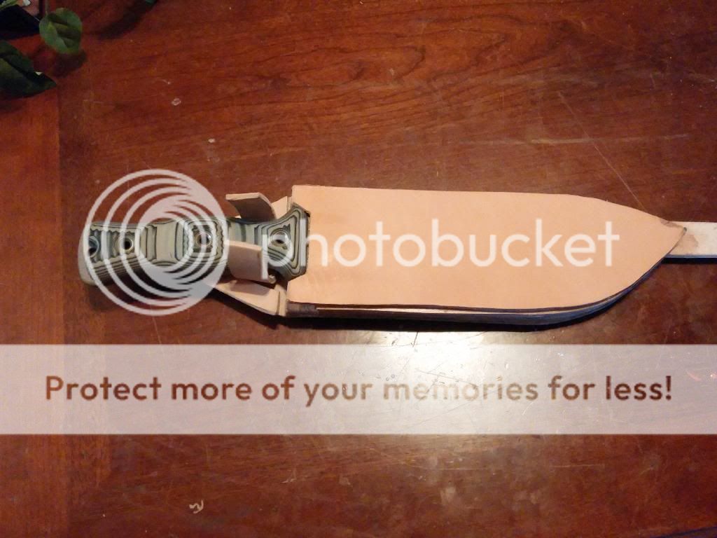

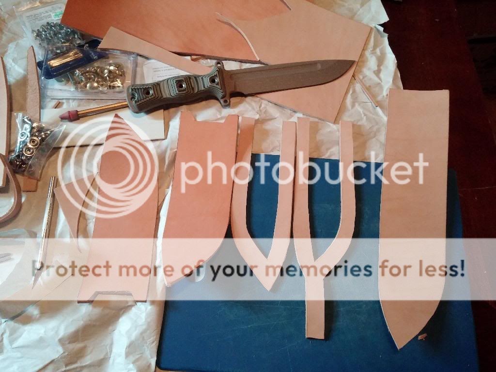

here is some pictures of how and what I've done so far.
leather i used was 8-9 oz and 9-10 oz for the main front and back pieces .

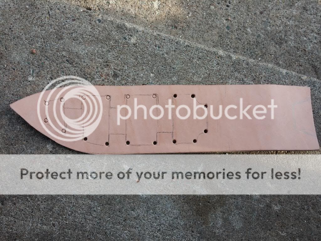

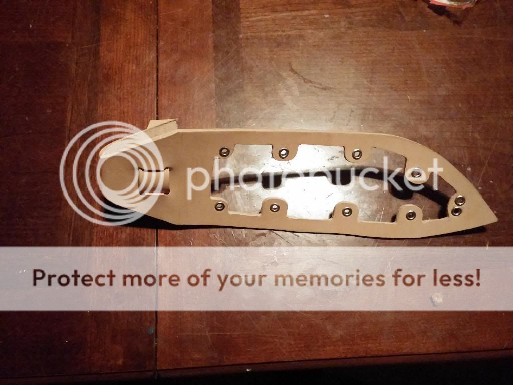

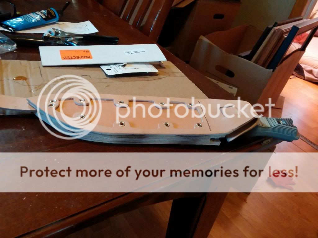

i made a back piece to lash paracord or a boot string through. i first punched holes in all the corners. used 8-9 oz
completed

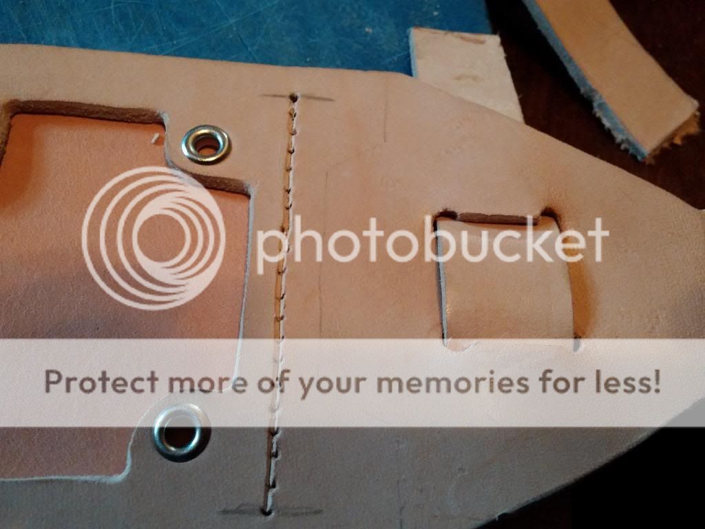

stitched it to the main back piece
sewing i broke 4 needles for this small part.

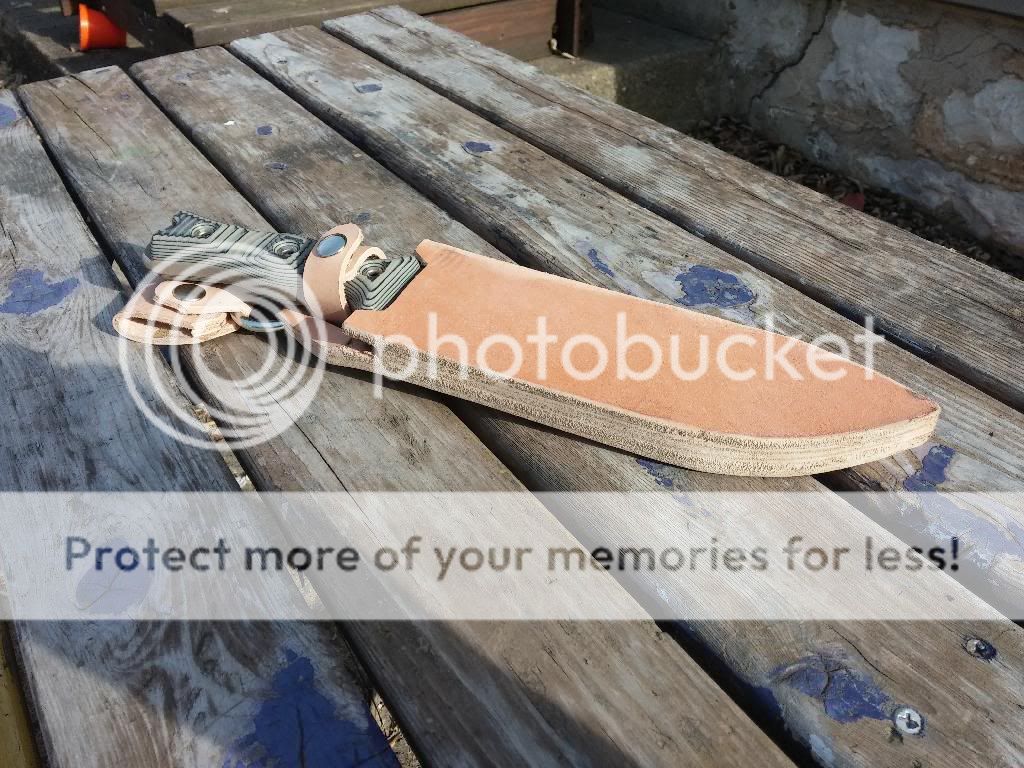

all i need to do now is trim and finish the edges. i'm going to try and use a bandsaw to cut the edges and make them square.
i'm not looking foward to stitching it all up and plan on drilling all the holes. probably take all weekend to finish..
thanks to everyone for their advice and helping me out with all my questions. I'm sire ill have more for ya:D

When you broke the needles, why do you think that happened? How did you make the holes for the needles to go through?
I can't imagine why it would take more than a couple of hours to drill and stitch. Imo, you've got the hard part done. The rest (for me) is the fun stuff. Spend a lot of time on the edges and you'll knock it outta the park!

If you have a belt sander I'd try that before using a band saw to square the edges. Goes a little slower but it's harder to take off too much.
I used an awl to make the holes and they kept closing up making the eye of the needle with the thread hard to pull thorough and they would break at the eye. I had to keep opening up the holes with the awl as I stitched.

If I had access to a belt sander that's what I would use, but I don't:(
I'm going to shave the edge off with the band saw then hand sand it.

Are you using those "Big Eye" needles? If so, yea they break so easily because the eye flexes every time its pulled through the hole effectively weakening it.
When you get a chance give harness needles a shot. Tandy carries two sizes, get the larger, or both if your using thinner thread. They are a pill to thread but last so much longer.
I use smooth jaw pliers, those smaller "jewelers" types from Sears, the curved nose types are really nice to use.
I got a package of needles from tandy that look pretty heavy duty. The needles I was using had pretty thin eyes. And they would break at the eye. I used needle nose pliars to pull the needle through.

The big eye, you can see where they are weak, I broke so many of those back in the day before a mentor turned me on to the harness needles. Back then they were provided with a paper board envelope with the maker listed, not so much now. I've got to tell the story of my mentor back then, he was Native American and had a wealth of knowledge, when he passed so did a huge reserve of old and hard to find native insight. It was a sad day.

Did something crazy and didn't lose a finger:D went to dad's to use his band saw and it was gone. So I went home and used my table saw like a disk sander and finished out the edge. All is left is to drill all the holes and tidy it up and add some color to it. :)
What can I put on all the edges to keep them from splitting apart? Some sort of glue?
I think I might drill the holes from the back side because the back edge is pretty thin and I'm afraid one of the holes may end up off the edge. Think it be a problem for the front side?

Use contact cement between layers. Lots of posts about edge finishing. Burnish and use something like gum tragacanth,or beeswax to hold the edge fibers.
Tip, for edge finishing with no tools?
A piece of jeans material to polish the edge.
I have edge slickers now, but some of the best edges I have done have been by spending a long time slicking the edges with a damp piece of edge.
Punching the holes is very trick by hand, when using leather that thick. I know, I have punched some thick sheaths. I don't have a drill press, or a cordless drill to use. I just use a sharpened punch. Often with a hammer and pliers.
Do you have a groover to set the line for the stitches and recess them?

If I wanted to make another sheath there are a few design changes i'd make. Mostly cosmetic like a couple seams and gaps. Overall I'm happy with what I did.:)
But i have a couple spots where the barges contact cement is separating and was thinking of using a small dab of super glue to fix, but want it to able to flex. Every time it bends it separates. ...
I'm surprised to hear that about the cement. Was surface prep good?
If you have a walmart, they sell Weldwood contact cement, and I've found it to be very strong. The fibers of the leather tore apart before the glue failed, but I found the same to be true with Barge. Only big difference is that the Barge requires clamping, while the Weldwood doesn't. At least not under the conditions that I put it through. I believe there would be even less chance for the need of clamping on your design as it doesn't have the two pieces of leather trying to pull itself apart (folded over for a pouch design). In any case, surface prep is usually the key when I have a failure be it glue or paint.
I wouldn't worry about the spots that are separating, the stitching will hold it together.
Surface was clean, but I wonder if I should of roughed up the smooth side of the leather first. I didn't know barges needed clamping.... hopefully stitching will help tho...
