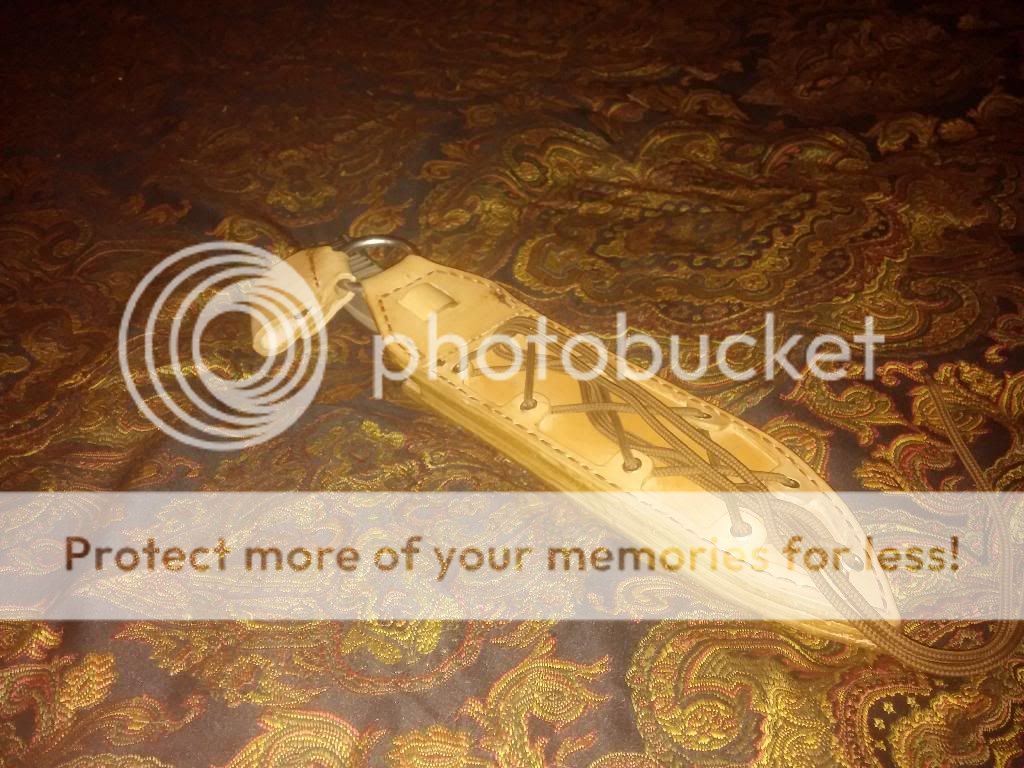

first time making a sheath and working with leather

I should of known to rough the leather up first. I did let each piece dry before sticking together. Learned a lot information thanks to you guys:) my next sheath will be better.

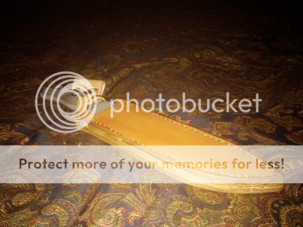

Got it all stitched up. Drilled the holes with a 5/64" drill bit and drill press. Stitching it really squeezed the layers together. Probably an 1/8" thinner now.

Finally got around to apply a finish. I used saddle soap and buffed it for like a couple hours. It darkened up the leather and polished the rough edges out. I like how the color turned out.
Sunlight will also cause the leather to darken naturally. If that is what you want. One of my sheaths has turned a really nice color from being used outside.

Very nice design btw...excellent work for your first sheath.
