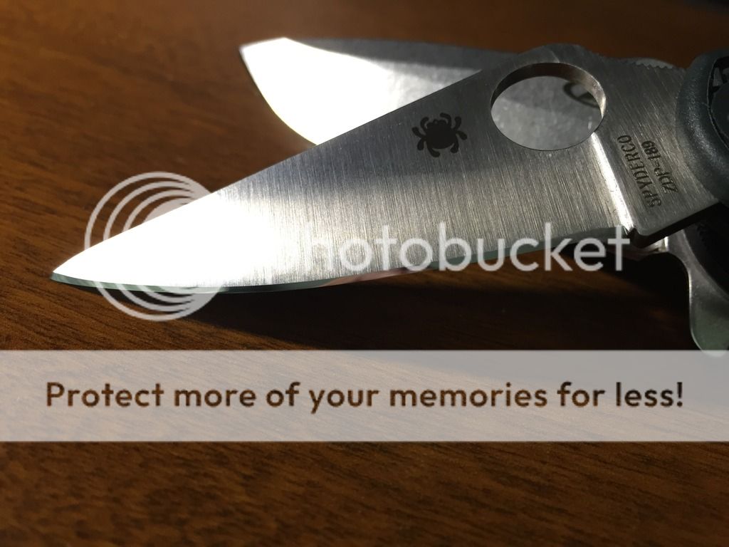

I'm new to the forum, and this is my first post -- but I had to crow to someone. I am slowly learning how to sharpen my knives after having been a knife collector for several years. After struggling to get good results with a Lansky system and Spyderco Sharpmaker (mostly due to my poor technique, I am sure) I finally purchased an Edge Pro Apex and have been using it for a couple of weeks. I finally got brave enough to try sharpening my ZDP-189 Delica 4 and my ZT0566 in ELMAX and have been very thrilled with the results. I did not attempt to re-profile the factory edges -- I just started with the 220 grit stone after setting the angle and worked my way slowly up through the finer stones and polishing tapes. I was able to get a scary sharp mirror-polished edge on both knives.
I practiced on a couple of my lower-end Kershaws with softer steels first. A number of forum posts and reviews I had read scared me off of starting with the ZDP and ELMAX, but I didn't find them all that hard to sharpen. In my limited experience, it seems that patience and consistency of technique are the keys to getting the refined edge that I am looking for.

Here are some quick and dirty pics. The edges look pretty good, except there is a little bit of inconsistency toward the very heel of the blade on the Delica. That's because the bevel flares out where it meets the ricasso. I wish that all blades had even just a tiny choil at the heel of the cutting edge like the 0566 to make that part easier to sharpen.
Very cool. The edge pro is an awesome tool for setting a specific angle on a blade. Drill stop collar and a diamond/hard lapping stone are necessities for high level results. Heel and tip are by far the most difficult areas with the EP.
