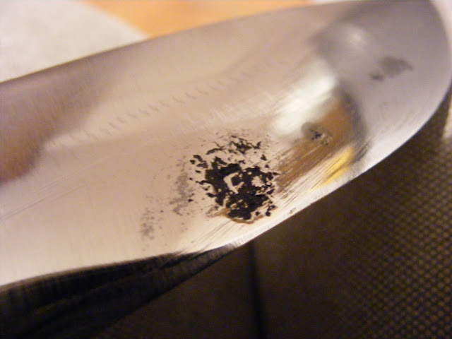

i have heat treat a cheap stainless steel 1.4116 in a coal forge, but I covered it with clay for fireplace to avoid decarb. It works actually. I made 4 knives like that. Yellow collor is what I looked for. With the clay on it I use interrupted oil quench, and it worked. It comes out clean after I remove the clay. I tempered in a kitchen oven - 57HRC. Nothing is imposible if you remove the minus factors - decarb and oxidation. Of course you risking to burn the steel, because that is very high temps. I will show you a defect burned and melted blade after my first try to heat naked blade in the fire up to yelow colour. After that every time I add clay on.
Now I have electric digitally controlled HT oven, and those days are gone. But I still use clay and interupted oil quench.
