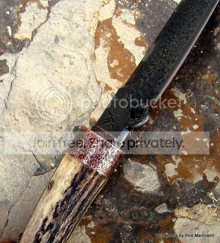

First time with Ferrule and Habaki
Rustic, 'sloppy', or whatever you care to call it .... that's one outstanding knife Rick.
If you don't mind my asking; how did you achieve that texture on the blade?

How's it look? Hit me where it hurts.

That's a very cool knife, Rick. I like the texture, the antler handle, the copper, all of it. Only thing I'm wondering is how the hell did you make that little curlique?
That is a stunning piece of work right there.

I would definitely like to have that in my collection. Sort of a blend between tribal and eastern, with a bit of feminine flair thrown in for kicks. Almost steampunk, but not. Hints of travels through wild lands filled with beautiful women and cold beer.
I like it!
That's a great looking knife Rick! From the curl in the choil to the taper in the antler mimicking the upsweep of the blade... Bang on! The ferrule and habaki..
Nicely done. I might be inclined to make the habaki just a little bit larger for emphasis but in this shot particularly it looks great.
As for capping the handle side..... Nope.... I could have used a copper cap, but preferred the open face. It has been filled with CA glue and buffed. The entire handle cavity was filled with West Systems Fast Epoxy and the tang pressed in. It is completely solid and sealed.
Never-the-less, it might have also looked good if the ferrule was closed so it completed capping the antler cutoff end with textured copper along with the wall/ring and Japanese doohickey slot thing.
