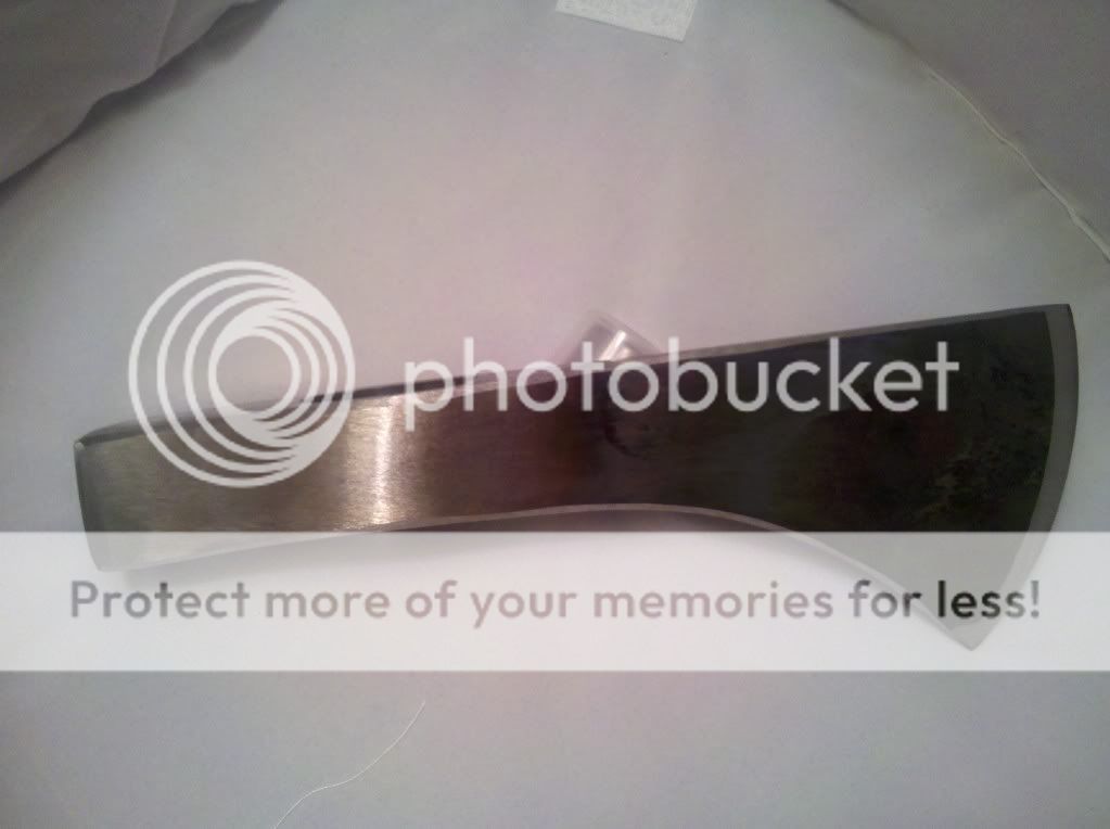

i've been taking some blacksmithing classes and this round my projects have been tomahawks. i've completed one and i'm working on two more. here's the first:
i started with a 1"x1"x5" piece fo 4140 (used the same size and type of steel for all of them) and drilled out the eye. most of the heavy work was done on a power hammer. the eye was drifted open, i quenched and heat treated it and finished it by soaking it in 9% vinegar.

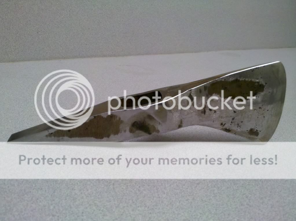

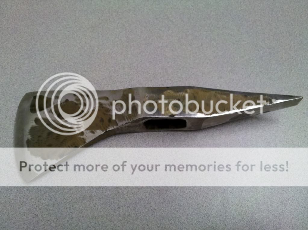

my second one is waiting to be heated, quenched and heat treated. here it is:

Wow awesome looking pieces for being your first two:thumbup:
thanks! they aren't 100%, but not bad. it's a lot harder to keep the eye centered up with the blade than i thought. it won't have an effect on the function, it's more of a visual thing.

Those do look good, I wish you had pics from overhead. And, I'd like to see some once you get the handle on there.

i will try to get some pics of my crooked eyes here when i get a chance.

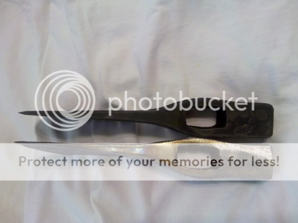

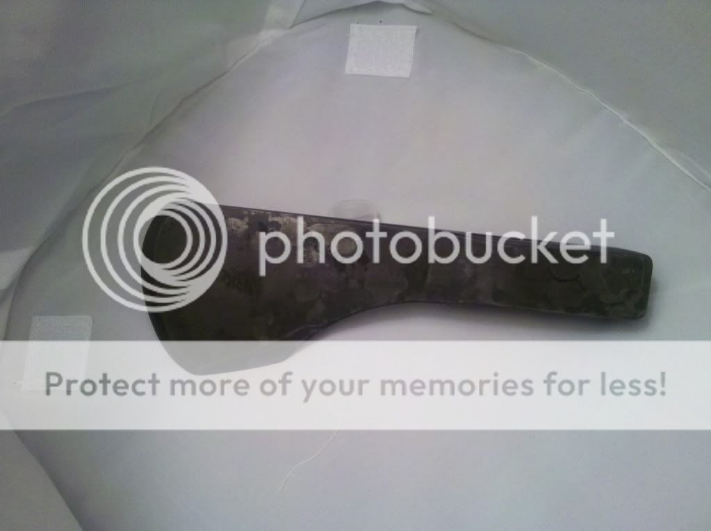

here's number 3. it's almost done. still need to heat treat it.

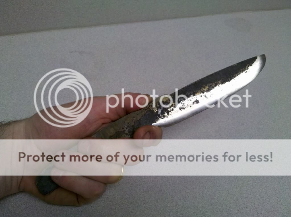

i've also been working on a knife. i still need to heat treat this one too.
you think THAT looks like a prison shank? i've got a few i made in my first round of knife making classes that REALLY look like they were made in prison! :p
