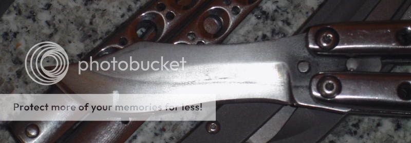

This is my first bali. Looking for constructive criticism. The good the bad and any tips/tricks in construcion. Your experience in making balis.
Here's the specs.
blade is 3/16"x3"x1" selectively hardened 1095
handles are 3/16"x1/2"x4-1/4" hardened 0-1
overall length of 7-1/4"
weighs between 9-10 oz.
It's a tank. Learned a lot making this one during the 3 week process it took to construct. It was a blast to make and actually flips pretty well.
Thanks for looking
Don
Excellent job Don,im impressed!
I do have some suggestion's for you:
first off i would drill your pivot holes in the blade a bit closer together,that way you have to file tang cup's into the handles.this will reduce wear on your tang pin's giving them rounded cup's to hit instead of flat steel!
Did you use bushing's?? if not you'll notice when the handles are squeezed to tight they will pinch the blade.bushings will prevent this,and (imo) can make all the difference in the world.however they're not totally neccisary.
other then that,from what i can see you done good :)
keep up the good work!!
Yes I did use bushings coutesy of knifekits.com. Also put in a set of phosphor bronze washers. Thanks for the advice on the pivot pins bb. I'm also thanking about buying a mini mill when I can save up the money. I think that would increase the overall precision of the construction and allow me to do inlays.
Yes a mini mill sure would be handy!you can also use thinner steel and do overlay's.i used .65 and .75 304SS on these little guy's.
You can pick up a sheet of thin stainless pretty cheap.

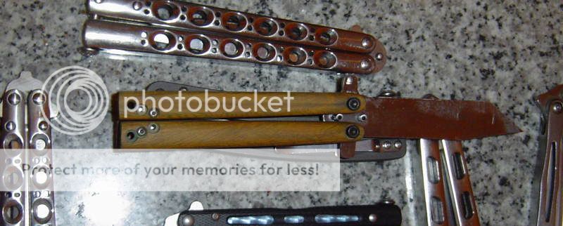

Here's a pic of a prototype I've been working on. Still perfecting the layout geometry but it is still kinda neat.
