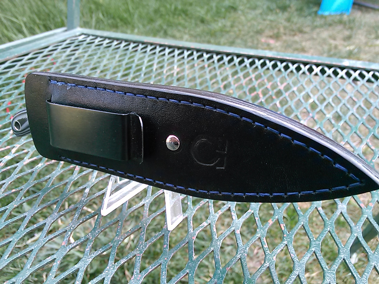

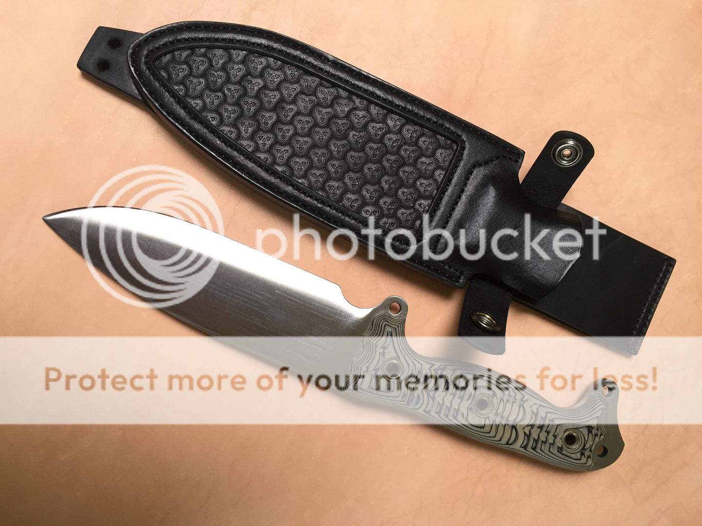

Since I haven't seen the Rowe sheath I can't be sure, but if it came out of Kenny's shop I'm almost sure it was machine stitched on a heavy stitcher. He has a very complete mechanized shop and while hand stitching is not out if the question, it is very unlikely.
Secondly, the Black sheath you posted above is really a fine looking piece and the construction design of the sheath fits that knife perfectly.
Paul
Paul,
Thank you for complement. This is the sheath that I was lining with kangaroo leather.
The Rowe sheath had a stingray inlay, the holes were much bigger than the thread used, and even after all those years the holes were round. My understanding is that punched holes should at least partly close up.

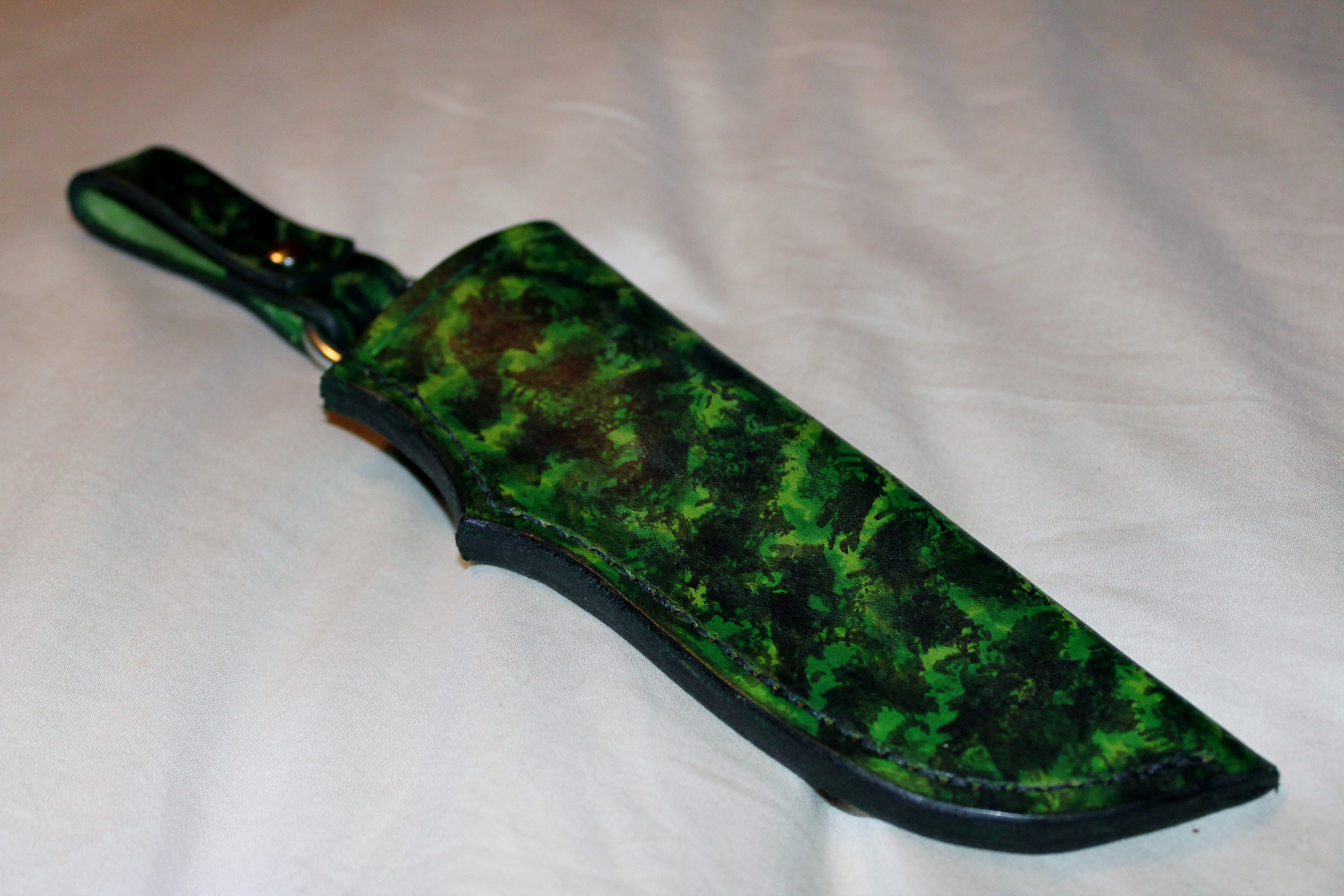

Dwayne, do you find that oil/wax does unwanted things to your elaborate dye work? For my camo dye it would be nice to have a spray finish. Still like wax/oil best though. I just touched up my first sheath and was happy to see that the original wax finish was very durable. For some reason I'd used Tan-Kote on the dangler and it'd held up okay, but there was some crazing on the bends. Fortunately Tan-Kote can be removed.
Finish is definitely one area where I end up going around and around!
Anthony, thanks for asking about the various special dyes that I do! I forgot to add that.
Actually the process is being enhanced by the oil/wax instead of interfering, much to my surprise and delight. The oil penetrates and makes the colors richer, and since it does not dry solid like the atom wax alone it allows the dye (especially oil dye) to mellow, and its those smooth transitions I look for that cloudy appearance.
When I go for the atom wax to finish, it further enhances the color and shine. The oil/wax alone does not give that nice deep mellow shine. The combination of the two is what I've been looking for all this time, and its about time! I've been doing the fade dye process since about 2004.
So yea, I am sold on the two together when a customer wants that nice shine, but when they dont (an awful lot of them do not) the wax/oil works very well and is so easy to keep up by them, and smells wonderful as a bonus.

Here's a camo job I did. I think it was 4 colors total.
Only thing is that I had to be fairly careful in order to not smear the colors, but it may not have been a bad look in retrospect.
