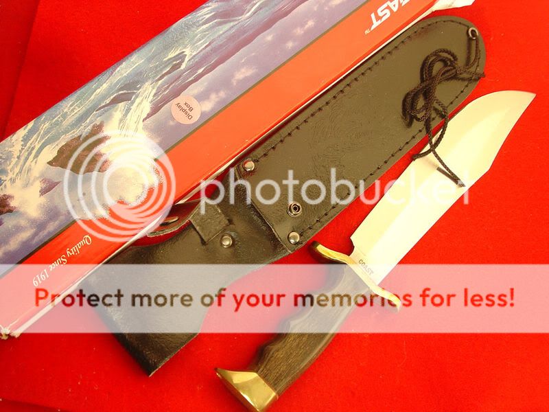

I've been itching for a while to get a crocodile dundee knife, but the closest that comes to it is the Outback, which I'm not ready to shell out 200$ for it yet. So I decided to try and get a cheaper bowie that looked like it and redo the handle.
Some surfing later I landed a Coast bowie with a 9" blade and a wooden handle, brass "s" guard and pommel:

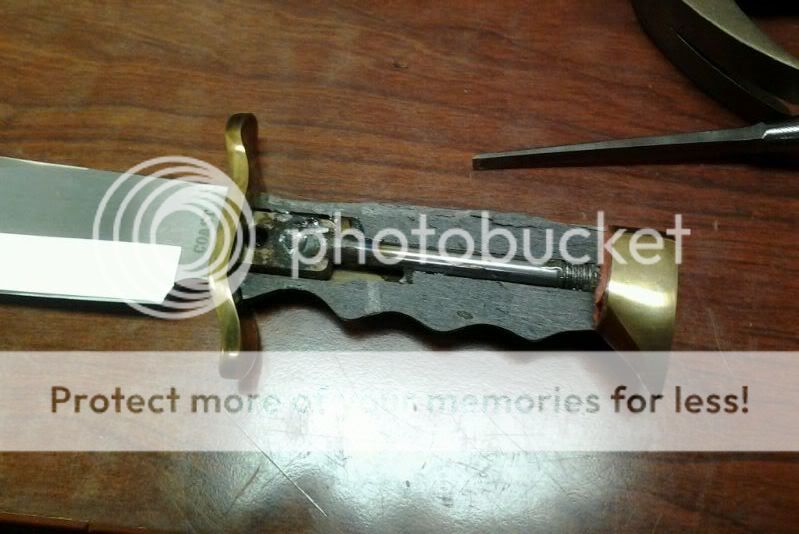

The leather sheath is flimsy with an embossed tiger at the front; it will probably be butchered up for an upcoming leather project. I cracked the handle to begin working, and was horrified by the view:
Yep...a screw welded to a quite short tang. Even as I hate this type of tang, I was rewarded with an easy removal procedure and a threaded pommel that offered little resistance. Notice the lack of glue in that big gap under the main bit of tang... Anyway, carry on. Got a strip of 8/9 oz x 2' tanned leather and cut it up; drilling the holes in the middle was a major PITA so I ended up using a thin blade to shape them up. Next time I do this I will get the pre-drilled/shaped washers...

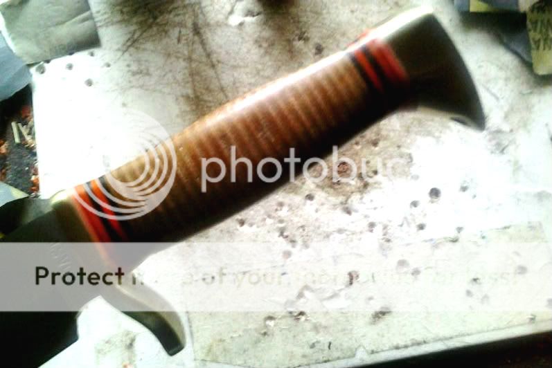

I used scrap pieces of kydex for spacers. Made a drawing of 2 separating lines forming a cone and numbered the bits of leather to know the exact order of each after I sorted them by size: small-medium-small. I have small hands so I wanted to taylor this handle to myself. Here's everything epoxied in place:
Since I made a kydex sheath for my KB Heavy Bowie, its original sheath became home for this blade. After a day of of rest for the epoxy to dig in, I hit it with the belt sander - first time using it, too! I'm fascinated by this tool now!
A search here on bf landed me on a leather stacking tutorial which I followed as best as I could. It was sanding with 150, 220 then crazy glue, sanding to 320, 400 then some more crazy glue, then 600, 800, finish with 1000 grit and a dab of furniture wax:
As the paper was out already, I dressed up the face of the blade on both sides up to 1200; only went up to 600 on the guard and pommel:
So this is the end result, and I am quite satisfied with it; to me it's only missing the fuller to be a close relative to the dundee knife. Now I got the itch to keep on doing more stacked leather handles and already took off the handle off of a Blackjack Anaconda III, but am stuck on what to use to create a pommel since the butt of the tang is not threaded, it's a full length tang and ends like this symbol --> ]. If I can pull this off, next on the list might be my Ontario SP5 after I strip the blade. Sorry for the crappy cell phone pics and thanks for looking!
