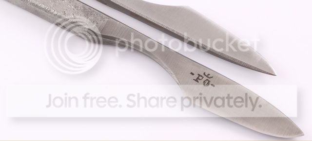

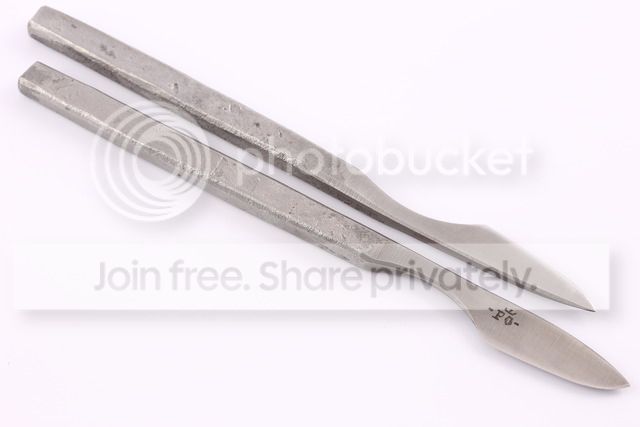

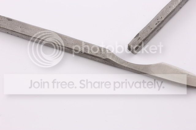

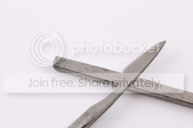

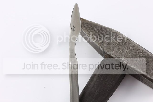

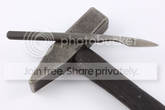

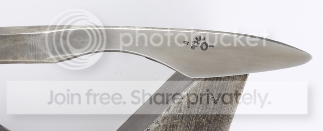

Crowned full flat grind with a micro convex edge. Oil hardened spring steel with a hardness at about 56. Screaming sharp, I've just trimmed my beard with i whit no mishaps. The are 6.5 inches in total and I call them general use craft knifes. Mainly precision work on leather, soft and medium hard woods and fabrics. Let me know if you like them! :)
Tnx guys! I like making them and I have recived positive fead back from leather workers fine wood workers that ive given the prototypes. I've currently got a smal batch of a 20% larger version made of swedish tool steel. I don't know if its beacuse I was surrounded by smal strurdy sharp knifes but I just love them and find them so usefull. :) I think I have four 1" carbon steel blades (some with a barrel wood handle and some scalpel-shaped) in my chitchen and another five on strategic places around the house. Grab, use, strop on belt, put it back. Some have just been stropped for 5 years and have reaches a steady stade edge geometry and need no further sharpening or maintenanc to stay push shave sharp. :)
That was not what I expected to see for a first pair of forgings.
Pretty cool imo!
Glad you guys like them, sure means a lot. Gave one to a wood carver who helped a friend today, and he was giddy like a child.

I like them a lot. I was just the other night if someone was making something like this. And pow, there it is. Great job.
