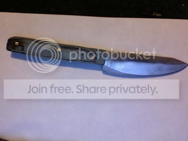

My first knife was out of an old rail road spike and the second one is 5160 with homemade denim micarta handle scales.

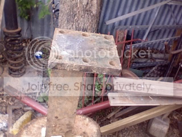

i was wondering what yall think of my first two knives, i used a bar-b-q put with a shopvac and a pipe for the forge and this...
for an anvil its a piece of metal i found at the junk yard imbedded in a log. i still need to finish polishing the knives but other than that theyre pretty much done. hope i get some good input/advice/tips for next time.... thanks
What's with the pins? First knife aside, it's important to make sure this stuff is straight before you call it finished. Especially for something where a relitively simple solution like re-drilling the handle/handle material will fix it. Make every knife more perfect than the last (Unless it's gonna be a "rough" knife, but don't make every one a rough knife).
Also, if you're pressed for money, a good flat file will flatten your bevels up real nicely if you take your time with it.

looks like you have a good start, although I have to agree with Blue Dragon about the pins etc. Don't let that scare you away from posting. You will get honest critique here, but you will also get good advice. First, have you read the stickies entitled Newbies Good info here? if not, do it.
second, for laying out your pinholes, get some marking fluid (I use Dychem blue, you can also use chinese white) coat your handle area, and when it dries use a compass or a caliper to scribe a line that is parallel to your top of the handle, and centerpunch equidistant spots starting half of your spacing distance from the blade end of the handle, drill those, then use those holes for a drill guide for your scales

that sounds good, i have another one in the works and il use that drilling method, i sorta did this one with a hand drill and no vice or clamps, just holding it down on the table.
Yeah, I figured that might have been a hand drill's doing. :p A good used drill press would be a great investment.

im gonna use a drill press next time, are there any other things i can work on? i was wondering how to make the grind look even, the back required alot more metal removal to make an edge cause it was thicker than the tip i can get that even edge with stock removal but i forged this one and i made the edge thin with the hammer.. am i supposed to make the blade shape uniform thickness and then remove stock or do something else? thanks
Practice practice practice. Whether draw filing or grinding. You learn to feel/see if your at the right angle better, and learn to stay at the angel more easily...

To help you along there are a million tip on this forum. If you don't already know about annealing that is making the metal soft enough so you can file it.
Bassically when you have finished forging get the balde back up to a good red heat. If you have an old magnet the steel will become non magnetic when hot enough and then you let the metal cool slowly. SOme put the blade in a bucket of old dry ash, or lime or a dozen other things.
Remember the blade will need to be re hardened and tempered when finished.
Also the surface scale straight out of the fire will destroy your files in no time. Clean it off before filling.
