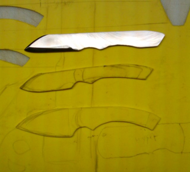

With the acquisition of an old belt sander and a renewed sense of purpose, I decided I would try my first knife.
The material is just an old Nicholson file which is a reasonable thickness (1/8"?). In the picture below are some craft foam patterns. I REALLY wanted to do the big one, but figured I'd learn faster on a smaller piece first.
Gee, removing this material is hard and slow, hence the shallow shaping compared to the pattern. I have a dremmel with a cutting wheel that was used for the gross cuts, and some "toothing" of the curved areas to speed up sanding. The "primary grind" (hahahaha) is merely started, and nothing is sharp yet. The back of the tip will be a false edge.
So far this has been a useful way to learn about the limits of my tools, if nothing else.
I've read the sticky on quenching, but I have some questions about the heat treating process in general.
This file must be pretty hard and brittle.
Should I be softening this somehow before sanding/grinding? would that make it easier?
Should I try to undo the current heat treatment and start over? Any tricks there?
Is this material totally useless for a knife?
Please excuse the lousy cell phone pic.
Thanks for any advice you can offer.
-Daizee
A file can make a decent knife but you have to choose whether to preserve the original hardness for the blade or to anneal it first and re-harden/temper it after shaping.
If you want to retain the hardness from the original heat treatment then you have to work very carefully so as to not heat the metal up beyond a reasonable tempering temp. If you have let the piece get very hot while grinding then you may have softened it a little too much.
Grinding the file in an already hardened state will eat abrasives and take a relatively long time to grind down. Ideally you should keep it below about 200 degrees while grinding and temper it in an oven, since a file is a bit too high in hardness for a using knife edge, you want to reduce the hardness a little, but in a controlled manner.
If you have made it this far without over-heating the edge then you might just as well keep at it and see how it turns out. You've already done a good bit of it the hard way
If you can/wish to anneal it and start over with the heat treat after you rough grind, you will make most of the grinding much easier and faster but obviously have the added complication of having to re-harden and temper it after getting it shaped. If you plan to drill any holes in the tang then you will have to anneal at least that area.
An idea that had not occurred to me before would be to do a variable temper using a torch, with the area that will form the edge of the blade immersed in water, before you start grinding. This should allow you to soften a good deal of the steel to some extent to aid in grinding, but leave the edge hard from the original HT. You would still want to oven temper to draw the edge hardness back a hair but this might make it a little easier to do the bulk of the grinding without requiring re-hardening of the blade. This is right off the top of my head but might be worth a try from where you're standing.

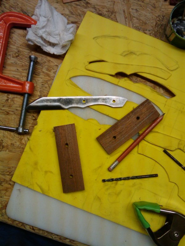

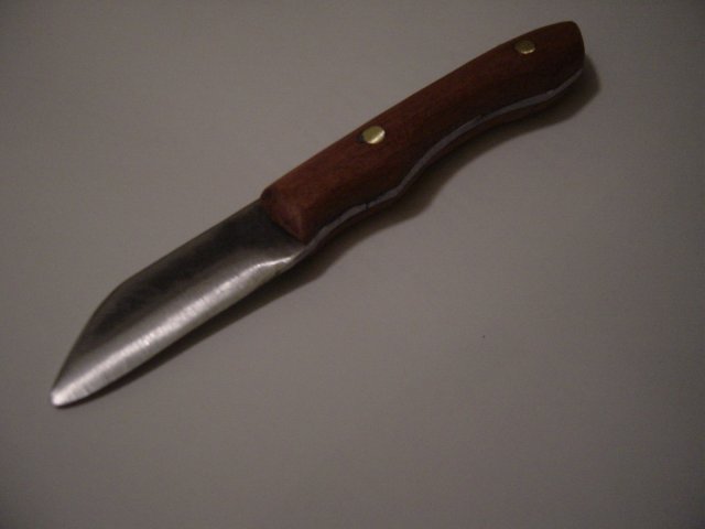

It's done! (except for some tung oil on the wood, which I'll do after the epoxy is fully set).
I decided to finish it up despite the uncertain heat-treat state and to just see what happens. I doubt I can heat treat just the edge after the scales are done if it turns out to be too soft, but mostly this was an experiment to learn what this is all about.

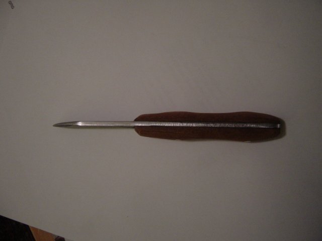

The scales are mahogany. The pins are 3/16" brass rod. You can still see some of the file tooth pattern on the flats of the blade because it's really hard to grind something flat without a backer to your belt... hm.
The glue for the grips/pins is a two-part metal powder 20-minute 3300lb epoxy. It's a bit like JB Weld, but in larger quantities and not as strong. It seems to grip things pretty well. I also tried to peen the pins - dunno how well that worked.
It's symmetrical enough to satisfy me for a first crash-course freehand attempt at all this.
It's crude, but functional, and it has a wicked edge at the moment (we'll see how long that holds up).
-Daizee

I had to run out of town for work for a few days right after finishing the knife.
It sat in the block on the counter.
Today I reheated some sesame chicken for lunch and when going back for a knife decided to try this goofy little thing.
WOW, it is SHARP compared to a regular table knife. I usually use eating knives that are sharper than your average table knife, but this was a whole different level. It sliced through that chicken like butter, leaving incredibly clean cuts. No sawing, tearing, whatever. And because of the beveled back of the tip, it was very effective for pushing the leavings around on the plate and onto my fork. Very little pressure was required, just a drawing motion, really.
Then I shaved up a magazine subscription card (still sharp), then I opened a bunch of mail (still sharp), and finally cleaned, waxed, and put it away (still sharp).
I dunno what it's niche is, but it's effective, if not pretty.
Once the woodstove is fired up again I'll throw in some more files so I can start on the my next attempt.
