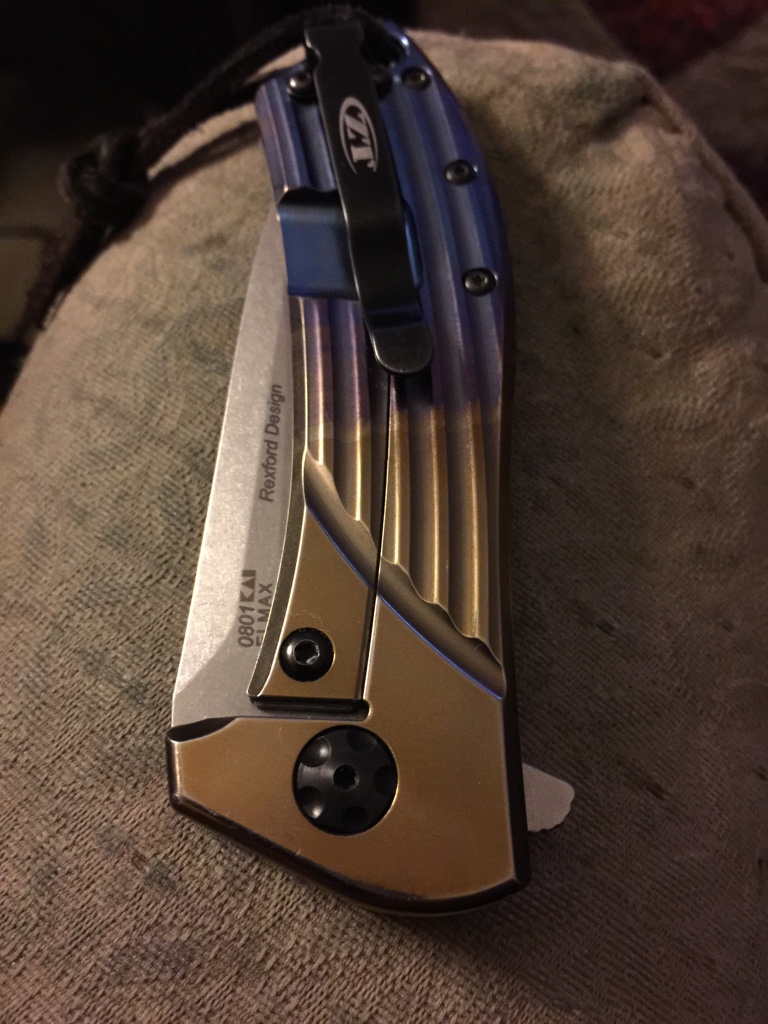

The 562 has the same pivot as the 801. It's a problematic pivot. It has not stopped both knives being very popular.
I am not sure this is related to your problem as the pivot becomes loose and needs to be tightened.
There should be no blade play when the knife is open or closed . Rock lock is a problem on some ZTs. Several videos on YouTube regarding these issues. Suggest you look there to see if you can identify your issues.

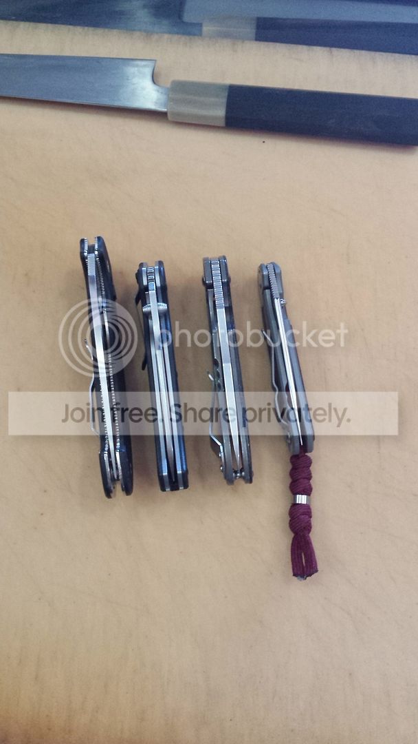

I know a guy who has a ZT and it also has lock rock, but cuts fine.
It's the flipper one, not sure of model.
2nd knife.
