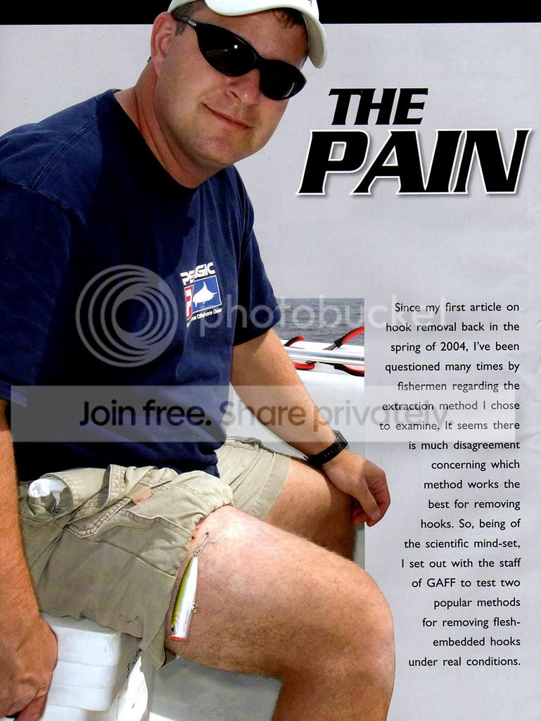

A recent mishap with a ladyfish hooking one of our members in a finger after he first hooked the ladyfish reminded me of the recent article in GAFF (May-June, 2007) by one of our former Florida State University pre-med students, Paul Hart, MD. Although nearly all such hookings of humans are strictly accidental, Dr. Hart PURPOSELY hooked himself to test a couple of the suggested remedies for hook removal-OUCH! I know, I know, but sometimes you just have to steel yourself to getting past the GAFF chick pics!
1. Here is the first pic that caught my attention (or mebbe it was the 12th, but no matter). This shows Dr. Hart with a self-hooked treble on a plug--more about this one later.

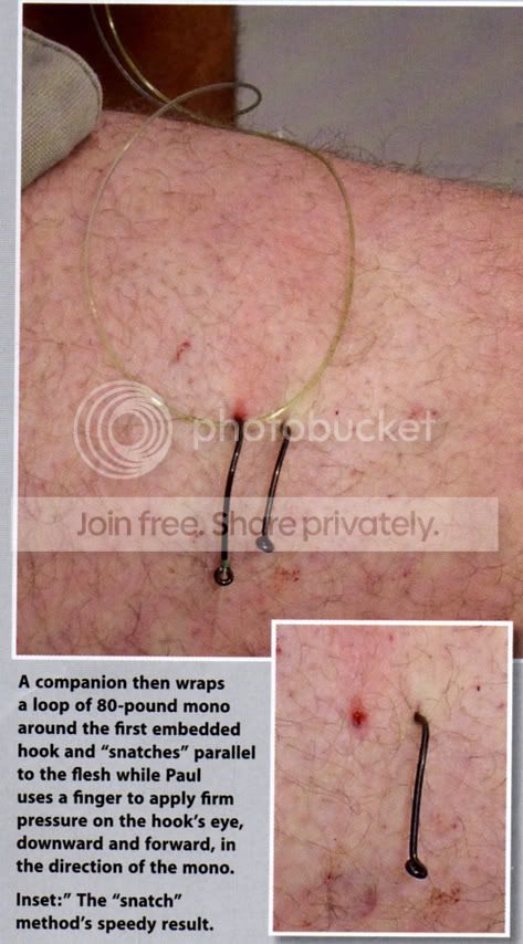

2. This pic shows Dr. Hart self-inserting two new Gamagatsu J-hooks side by side for a comparison of the “snatch” method with the “push-through” method of hook removal.
3. Snatch Method-1. The next pic illustrates the use of a short piece of heavy-duty mono around the hook in the “snatch” method. Although I first saw this method published in a scientific paper from Britain about 30 years ago, not many folks even today seem to be familiar with it, or at least have ever tried it. But it does require a fishing buddy to help you out with this method.

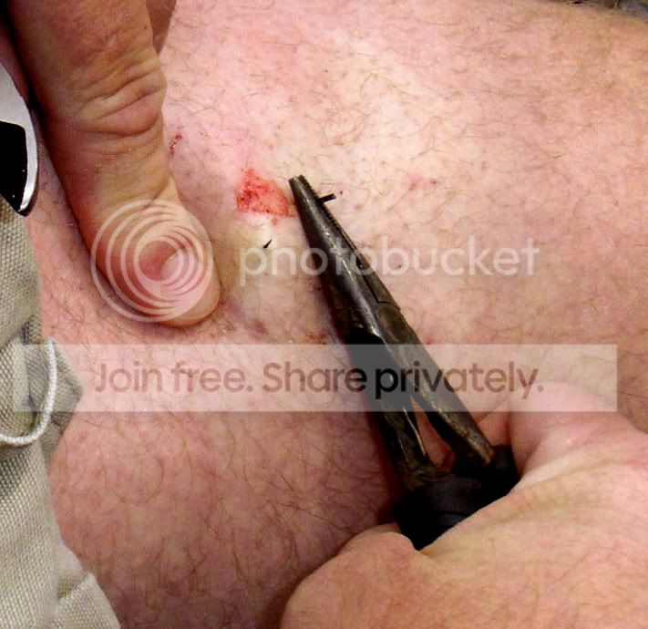

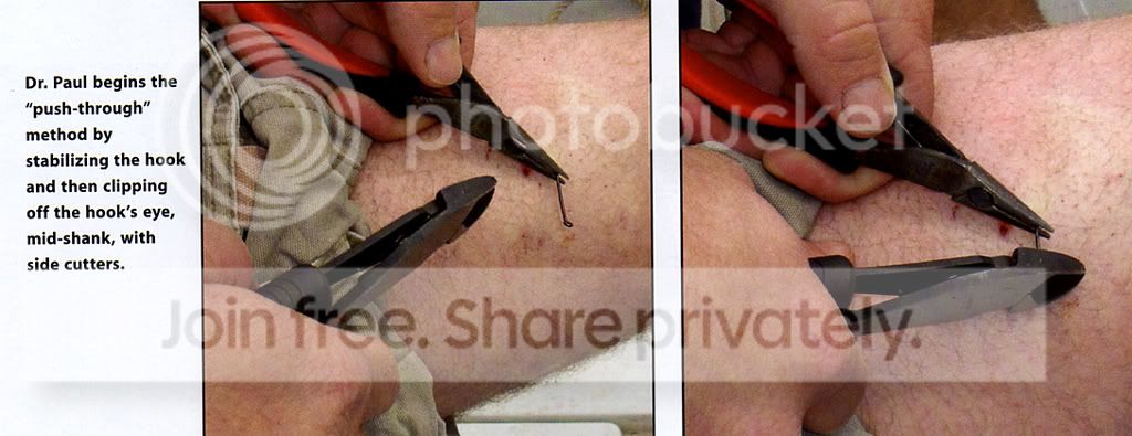

5. Push-thru Method-1. You will need two pairs of pliers/side cutters for this method. In the left-hand pic, first grip the shank of the hook with a pair of normal long-nose or other pliers to stabilize it and to keep it from twisting (very painful!). Then in the right-hand pic, you cut off the eye of the hook with your bolt, or side cutters.

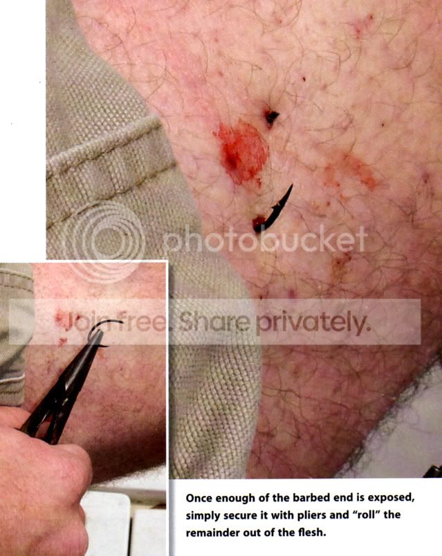

6. Push-thru Method-2. Next comes the hard part—you grip the shank of the hook (or what is left of it), and then roll it up and out thru the skin to form a brand-new opening and expose the barb (also very painful, depending on how much fresh, un-hooked tissue you need to pass through).
7. Push-thru Method-3. It finally gets a bit easier from here on out. The idea now is to grip the hook with your long-nose pliers just above the exposed barb and then quickly roll or rotate the eye-less hook shank up and out thru your second opening—i.e., your new “exit” wound.

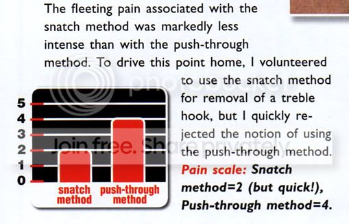

8. Pain Factor. Dr. Hart also included some interesting graphical info in his article. One of them dealt with the “pain factor” of the two hook removal methods. As you can see here (and as you might expect), the pain associated with the “push-thru” method was considerably greater than the “snatch” method that was still painful, but over a much briefer time frame. In fact, as Dr. Hart pointed out towards the end of his article, there was no doubt about which method he was going to use to remove the embedded treble hook shown in the first pic—the “snatch” method won out hands down!

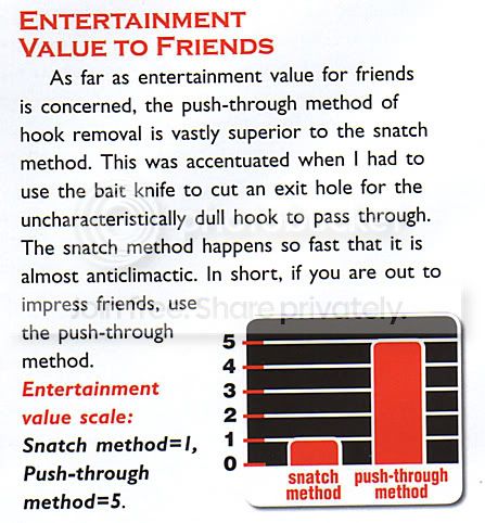

9. Finally, jusr for grins, Dr. Hart included another graph comparing the “Entertainment Value” for one’s fishing partners or boatmates of the two methods. Again, as you probably might expect, the EV of the “push-thru” method was considerably greater than that of the “snatch” method. Finally, my cap is off to Dr. Paul Hart, MD for perhaps being the first to so carefully experiment with (and to document!) the two methods of hook removal. Well done!

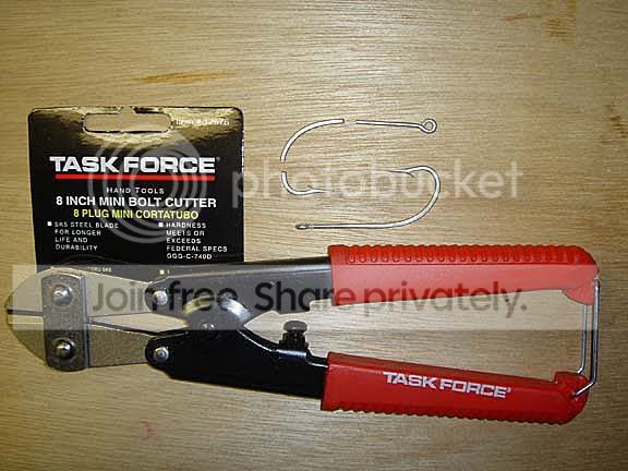

10. Mini-Bolt Cutter for Hook Removal
As Dr. Hart points out in the article, it may not be easy to find a pair of wire or side-cutters (1) heavy enough to cut thru say, even a 5/0 hook (or smaller) that I have often used for saltwater fishing, and (2) small enough to carry on a yak. I have tried a variety of sturdy, plier-type tools with wire cutters, but none did the job of cutting thru a 5/0 hook satisfactorily. I finally discovered what I was looking for at Lowe’s about a year ago—a pair of mini bolt cutters, only 8.25 inches long, that would fit nicely into a tackle or gear box, or in a crate, or in a seat-back pocket (where I carry mine). This is the Lowe’s Task Force 8 inch Mini Bolt Cutter for $9.98. My test object was a 5/0 stainless steel O’Shaughnessy hook that was easily sliced and diced by this tool. However, a pair of heavy-duty linesman’s pliers with a side-cutter barely made a dent in it. Of course, the closer you can get the fulcrum point of the bolt cutter to the shaft of the hook, the easier it will be to sever it.

I'm embarrassed to admit that I can't figure out the physics of the snatch method -- is the idea that the fishing line pulls on the "J bend" part of the hook while the "patient" (victim?) stretches out the flesh with his hands?
I think you're supposed to push down on eye of the hook into your arm, then pull on the bend with the line. I read this in some old bassmaster mag before.
But you need really thick mono which I never have around. Do you guys know if a thicker superline would work?
I have done it with 550 cord, the bigger the line that will fit the hook the better, believe me you want it to come out in one jerk.
The way it works is that when you push down on the eye and jerk the string in the bend of the hook it forces the barb to travel the same path as it did going in. I real life I am not sure your not just yanking the damn thing out, but it is like taking a bandaid off, it is better to get it over quick IMO. Chris
