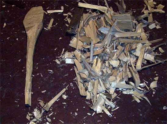

I think a point has to be made that not every axe needs to be ground the same way, though this often comes across far too often, usually indicating simply personal preference without considering other viewpoints. In general for most wood working locally I would pick the Wildlife over the Fiskars, however the much more durable bit on the Fiskars has its advantages :
http://i7.photobucket.com/albums/y269/CliffStamp/fiskars/hatchet/fiskars_shovel.jpg
That is a shovel/scoop I hacked out of a length of 2x4 with the Fiskars and if you look at the sides of the woods there are a couple of places where there are really thick knots. These were so hard that it took multiple swings to remove them, I would not bet on the Bruks edge reacting well to similar encounters, and generally chisel cutting knots like that is avoided, but the Fiskars was uneffected.
Often when issues like these are brought up some people will comment that they don't cut knots in general, especially not of that type, and that has a following for a lot of work. In general dedicated felling axes were profiled so slim they would get damaged by knots, you did this so as to get the maximum cutting peformance and had the skill and time necessary to deal with them.
For the above piece of wood the knots had to be removed, now I could have done it with an axe with a much thinner bit, I just would have chopping off all the surrounding wood and then cracked the knot off with the poll, but if you claim that the Wildlife has an advantage because it chops faster with less effort you also have to realize the same is true for the Fiskars and more demanding work.
