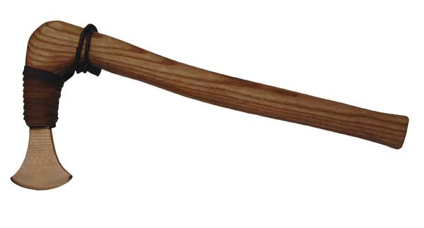

If you really had to I gander you could replace the handle with a bent haft much like an old bronze-age tanged axe.
The biggest advantage that the "modern" style of axe head had was that the piece used for the haft didn't have to be bent. Finding a suitable piece of wood for the handle of a bronze axe is a pain in the butt from what I've heard. :)
