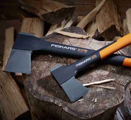

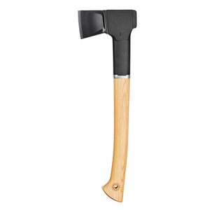

1. Develop awesome regionally specific collared axes over centuries:
2. Update to modern production methods:
3. Finish them nicely:
4. Rename it Fiskars.
5. Follow suit with modern trend with some epoxy.
6. Take it one step further:
7. And a step back but in the right direction lol.

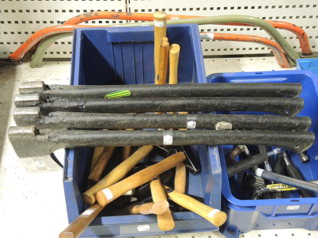

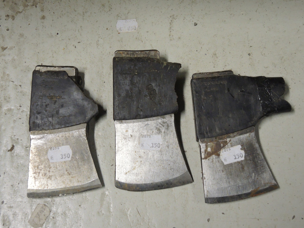

Fiskars meets reality i.e. Finnish conscript use:
Clearly the axes have been abused, used for hammering, but out in the field you have to use the tool you have in order to survive. There are no sledge hammers to be found in the Finnish forests;)
What an excellent testing lab!
I wonder what can be done with those heads...Steel for re-blading older axes?
That "waist" where plastic strap goes would make it difficult for slitting them for a conventional eye...Maybe possible,with a powerful,industrial grade hydraulic press....
And you have proven that anything can be broken.
