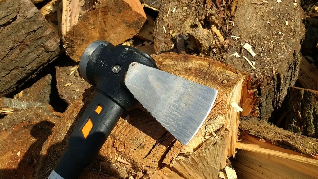

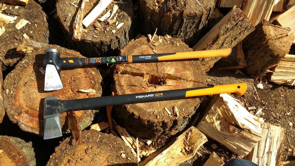

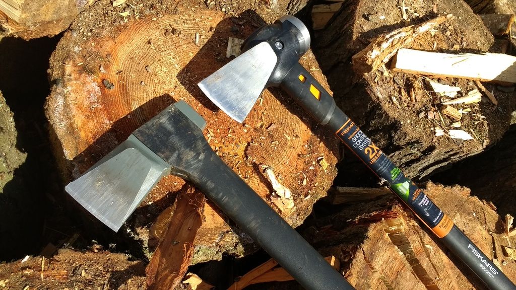

Isocore 8lbs maul on the top
Fiskers x27 on bottom
Both 36"handles.
The handle has a slim geometry, is nice.
It's biggest short coming is the rubber grip. It's more suited to users that use gloves. The rubber is tougher on the bare hands
The geometry is great, it's close to the Gransfors splitting axe which has monster performance, since the bit has great penetration to really deliver that splitting energy to big rounds.
Excellent geometry.
Comes with a convex edge. It's good to go out of box. But can definitely be sharper for more skilled users.

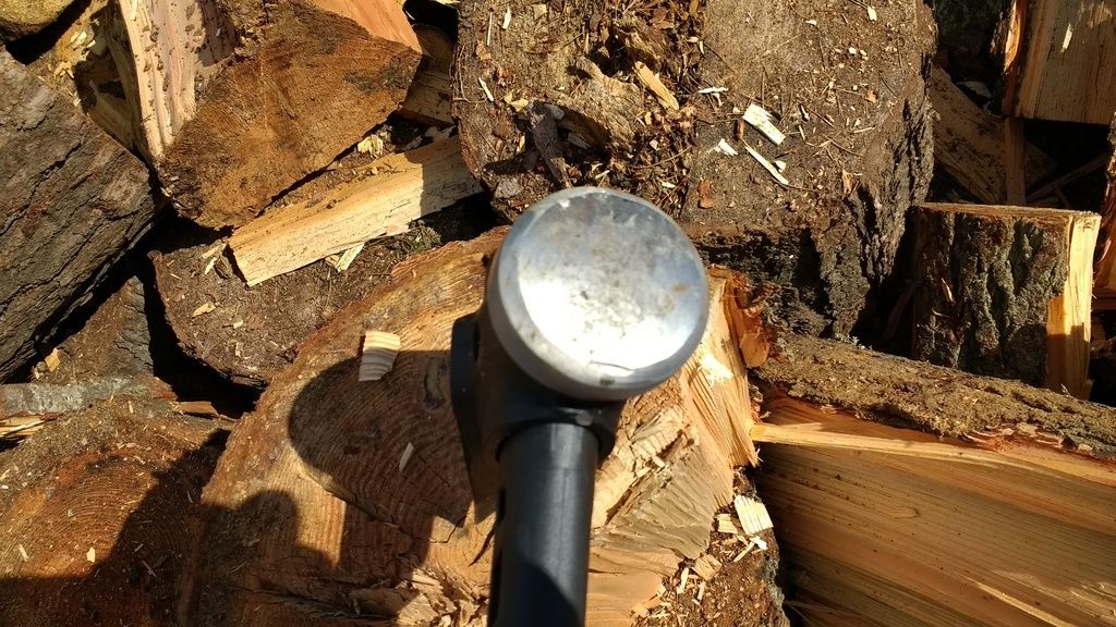

The strike face is nice, easy to make hits.
Took some damage, but they all do

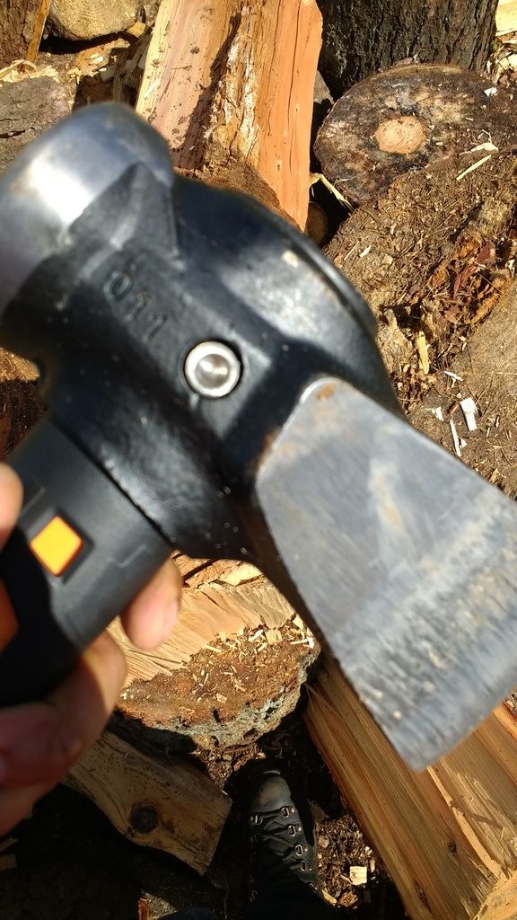

The construction is interesting, it's a drop forged closed die head hung like a mattock with a bolt on each side. The bolts appear to be stripped out to prevent tapering once secured.
Held up to some hard hitting swings, Fiskers has a reputation for being bombproof. We'll see how it holds up over time.
